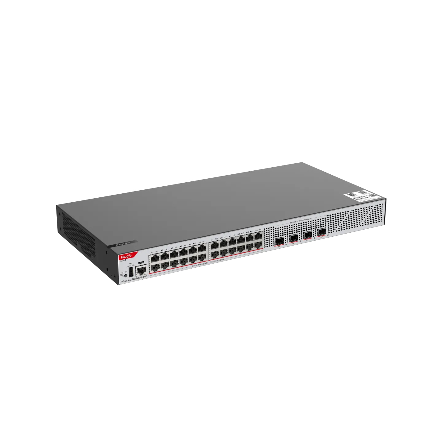

RG-S5350-24GT4SFP-P-E 24-Port GE Layer 3 Managed Access Switch with PoE+, 4-Port 1GE Uplink
Characterized by security, high efficiency, intelligence, and energy saving, designed for network environments that require high performance, high port density, and easy installation
  • PoE+ supported, powering various terminal devices
  • Hardware-level reliability adapted to harsh environment
  • Efficient energy-saving management, reducing power consumption and noise
Layer 3 Compact Access Switch for 1GE Uplink RG-S5350-24GT4SFP-P-E
Full-gigabit access switch for large-sized enterprise and campus LANs, with four 1GE SFP ports for high-speed data transmission
PoE+ Supported, Powering Various Terminal Devices
The switch automatically detects and supplies the required power for devices, meeting the needs of common PoE applications such as security surveillance, teleconferencing, and wireless coverage.
Hardware-Level Reliability Adapted to Harsh Environment
Industry-leading port surge protection capability of up to 10 kV.
Passed anti-corrosion tests, with the proven capability to withstand exposure to moisture, ensuring durability in severe environments.
CPU Protect Policy (CPP) is supported to control the packet type and traffic volume sent to the CPU, preventing high CPU usage.
Virtual Switching Unit (VSU) ensures flexible networking and high performance.
Efficient Energy-saving Management, Reducing Power Consumption and Noises
Adopting advanced energy-saving technologies, the switch minimizes power usage and noise.
With EEE, ports conserve energy by going dormant, activating only when traffic is detected.
RG-UNC for Visualized Management, Automated & Effortless Operations
RG-UNC, a unified visual management platform, supports real-time monitoring of key devices and links, fine-grained alarms, centralized configuration backup and recovery, network-wide management, plug-and-play, and rapid deployment, enhancing O&M efficiency.
