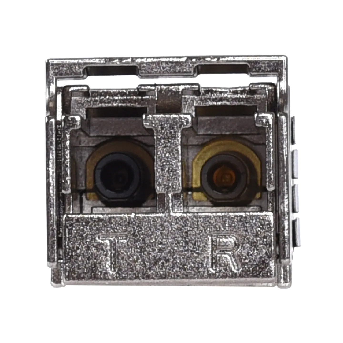

XG-SFP-SR-MM850 10GBASE-SR SFP+ 850-nm 300-m DOM Duplex LC MMF Optical Transceiver Module
Applicable to data center and campus networks, enabling cost-effective, efficient, and high-speed interconnection
  • Max. power consumption 1.5 W
  • Hot pluggable SFP+ MSA compliant
  • Digital optical monitoring capability for strong diagnostic capabilities
  • Compliant with IEEE 802.3z Gigabit Ethernet
  • Class 1 Laser safety and RoHS compliant
As an industry-leading ICT infrastructure and industry solution provider, Ruijie offers customers a wide variety of high-density and low-power 10G optical modules. They are applicable to data center and campus networks, enabling cost-effective, efficient, and high-speed interconnection among switches, routers, servers, and network interface controllers (NICs).
The XG-SFP-SR-MM850 is aligned to IEEE 10GBASE-SR optical specifications and supports a link length of up to 300 m (984.25 ft., with OM3 optical cables) or 400 m (1312.34 ft., with OM4 optical cables) over a multimode fiber (MMF) with a Duplex LC connector. It adopts the SFP+ form factor and operates at a wavelength of 850 nm. The transceiver conforms to IEEE 802.3ae, SFF-8431, SFP+ Multisource Agreement (MSA), and RoHS standards.
