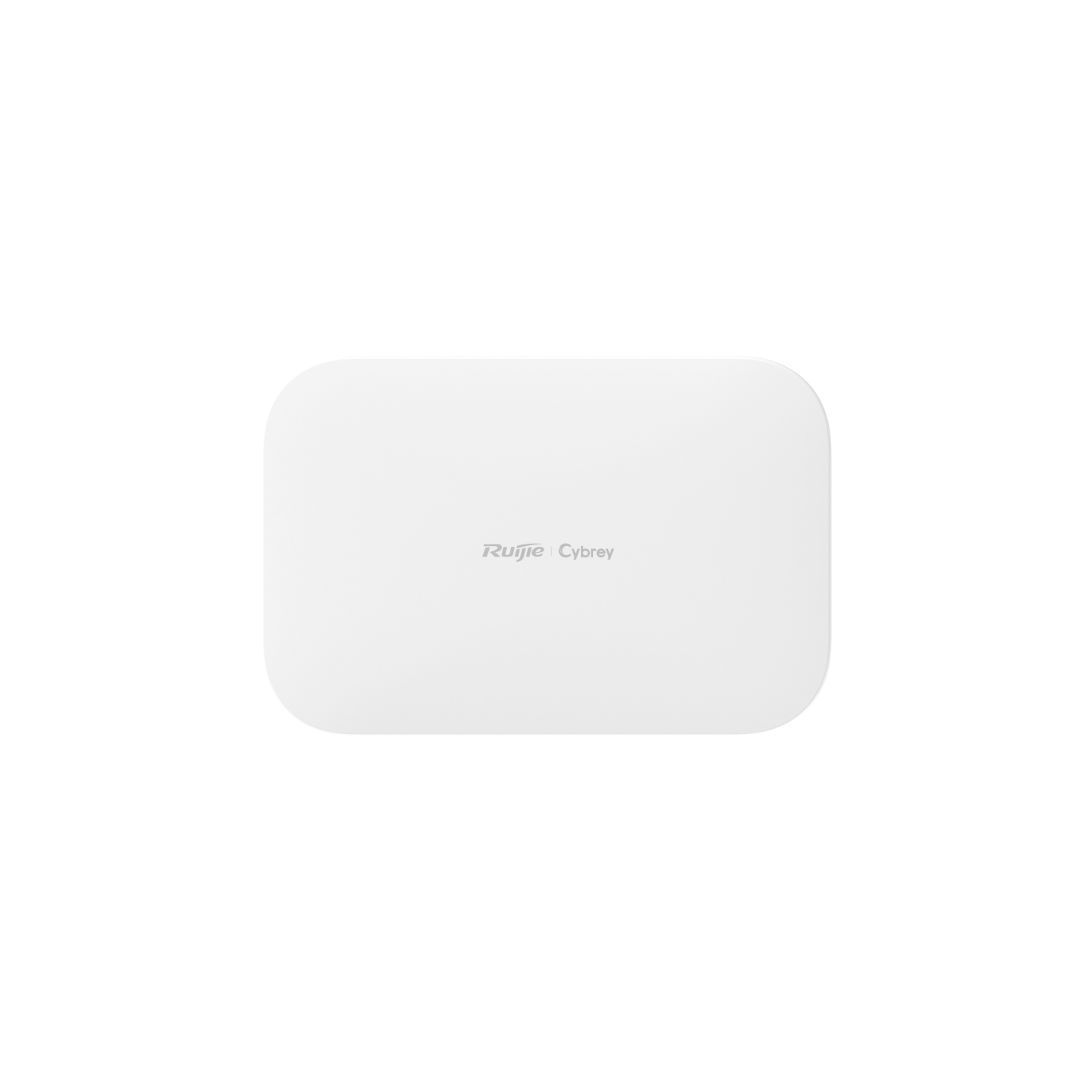

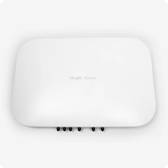

RG-ANT90-T6, Tri‑band Six‑Element Cross‑Polarized High‑Gain Outdoor Antenna
  • Six-element, cross-polarized antenna supporting tri-band 2.4/5/6 GHz Wi-Fi.
  • 11 dBi peak gain on 5 GHz and 6 GHz, 9 dBi on 2.4 GHz for stronger, longer-range signals.
  • 65° horizontal and 18° vertical beamwidths on 5 and 6 GHz, plus 60° horizontal and 20° vertical beamwidths on 2.4 GHz for precise signal focusing, reduced interference, and less wasted coverage.

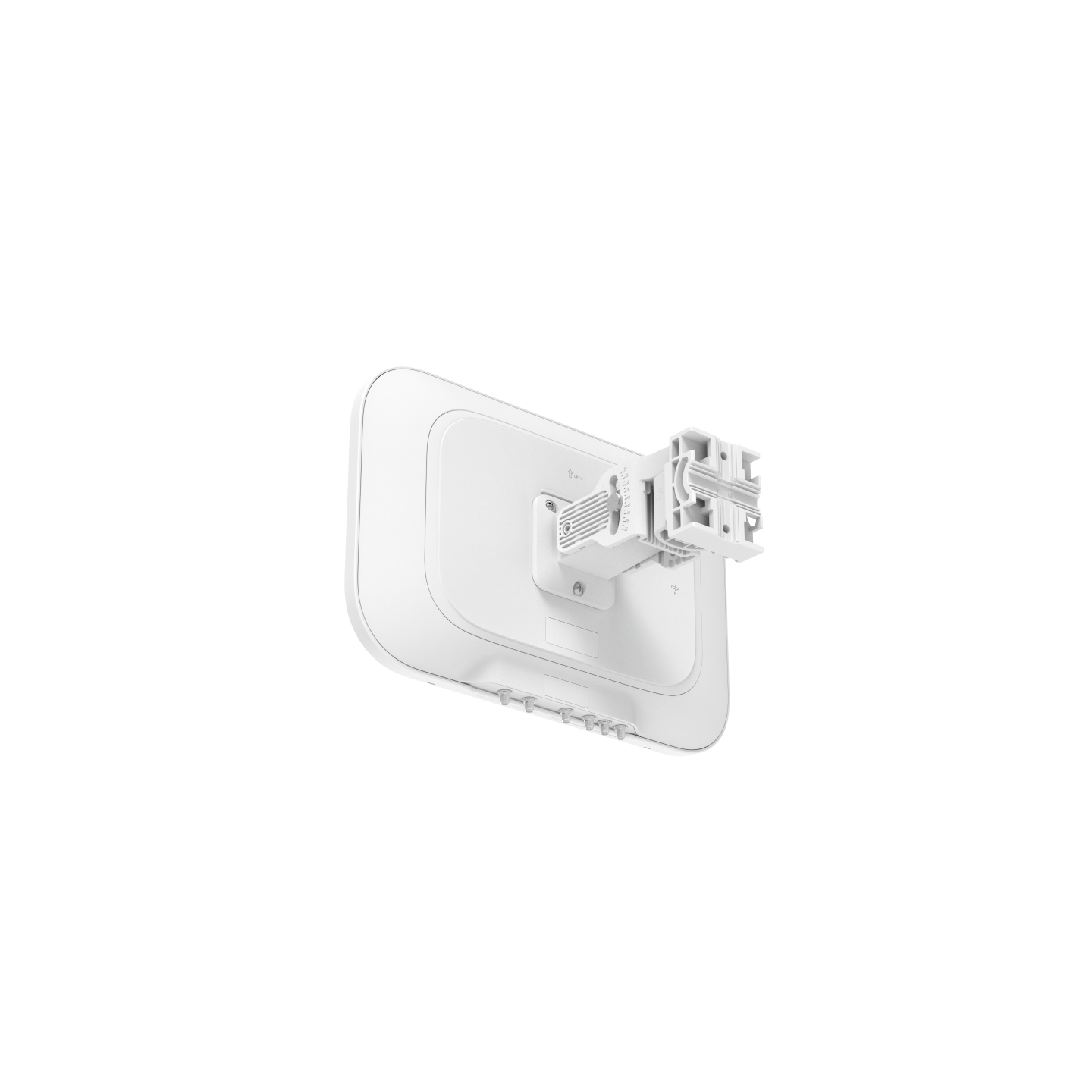

    In the Box
    • RG-ANT90-T6
      x1

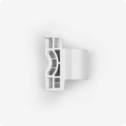

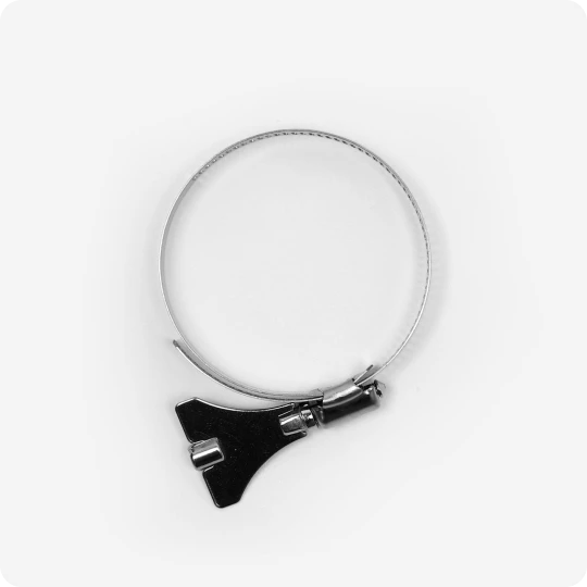

    • Hose clamp
      x2
    • Base bracket
      x1

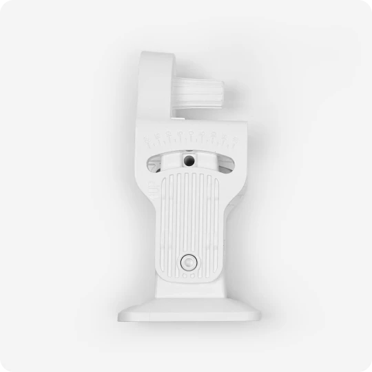

    • Antenna mounting assembly
      x1
    • Wing knob
      x2

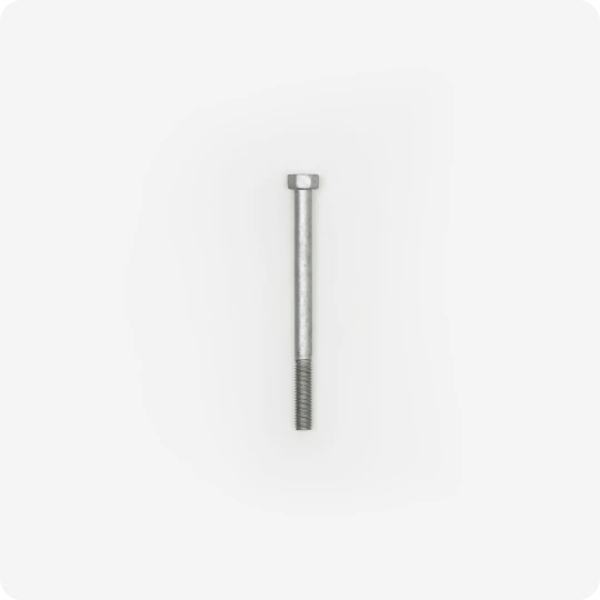

    • M5 x 66 mm Phillips hex head machine screw
      x2
    • Positioning nut
      x1
    • M6 x 70 mm expansion anchor
      ×2
    • M5 x 12 mm Phillips pan head screw
      ×3
    *Accessory pictures are for reference only. Specifications of accessories such as power cords vary by sales region and country. Please refer to the actual item received.

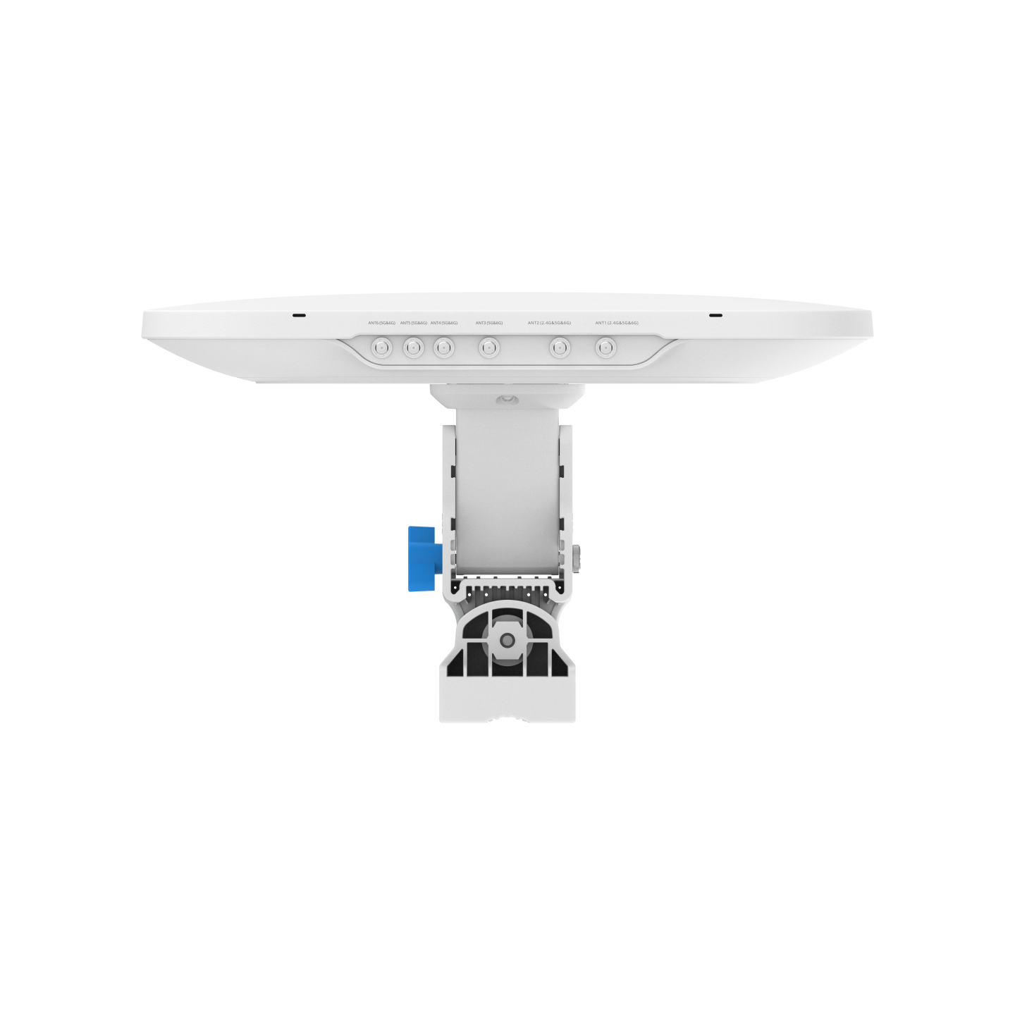

    Antenna connector
    • 6 x RP-SMA female antenna connectors

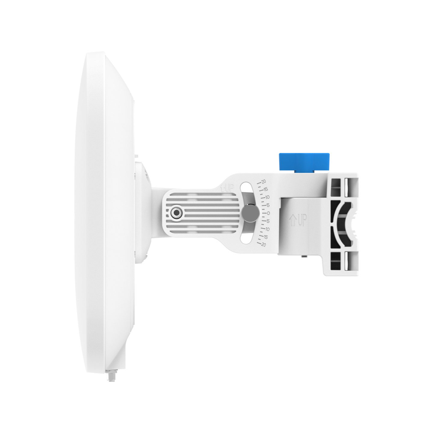

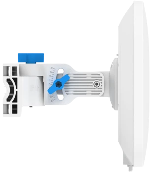

    Mounting options
    • Wall-mount and pole-mount

    Antenna adjustment assembly
