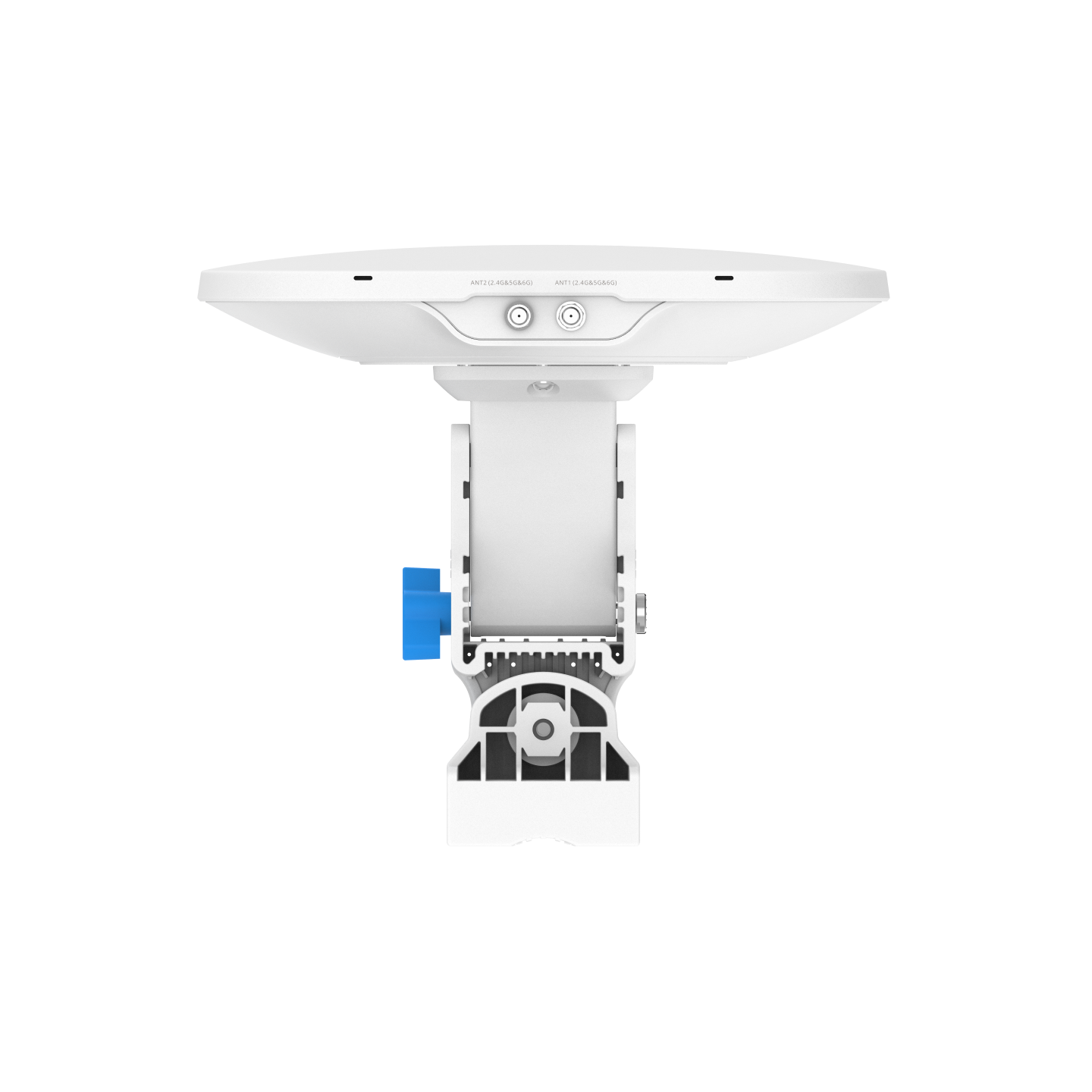

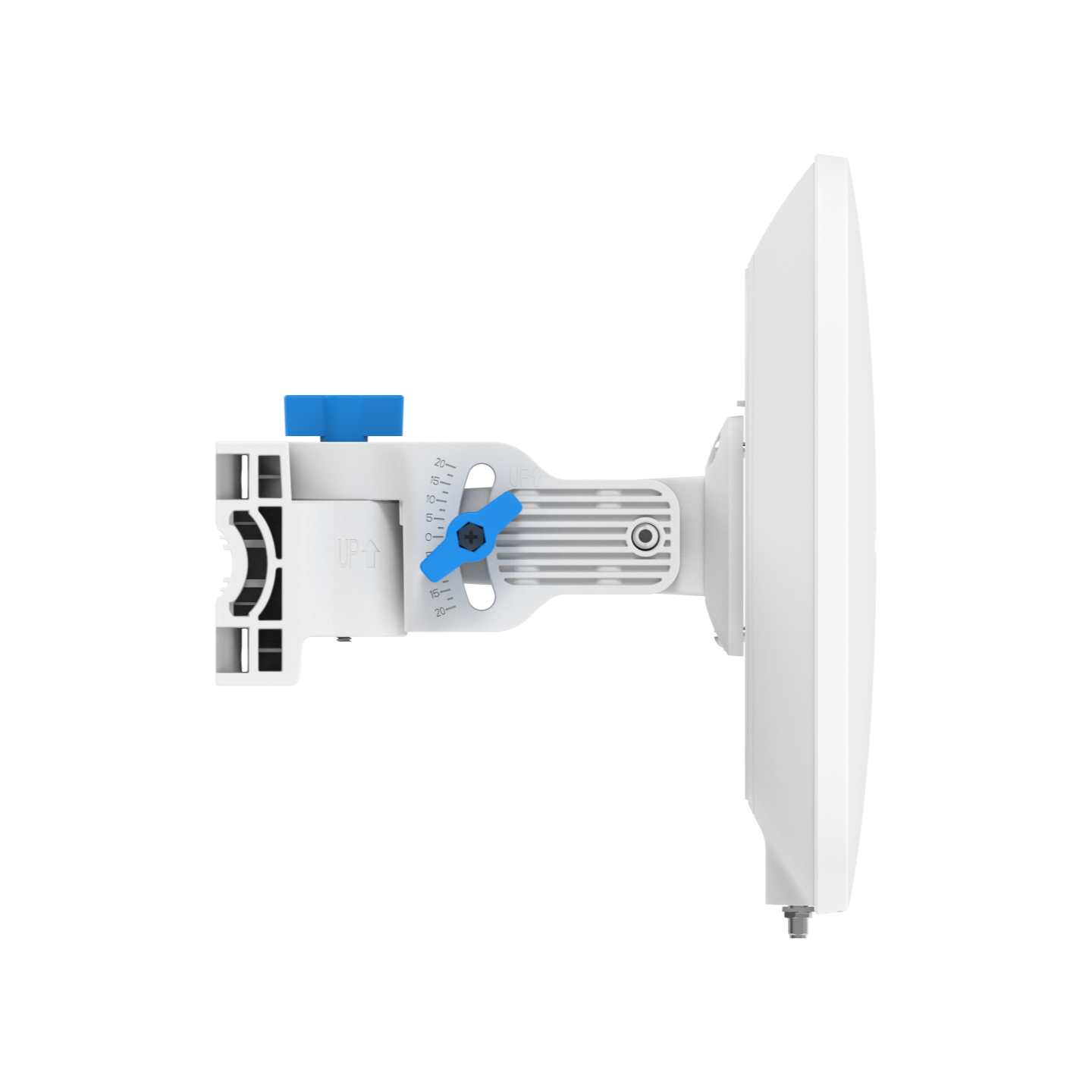

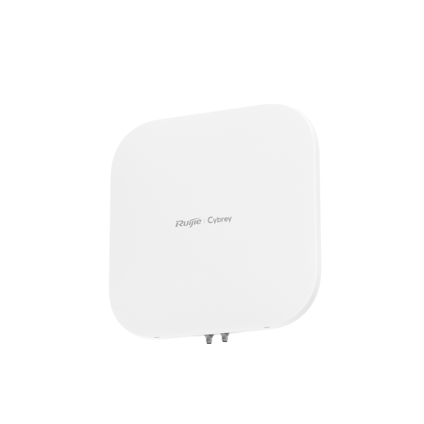

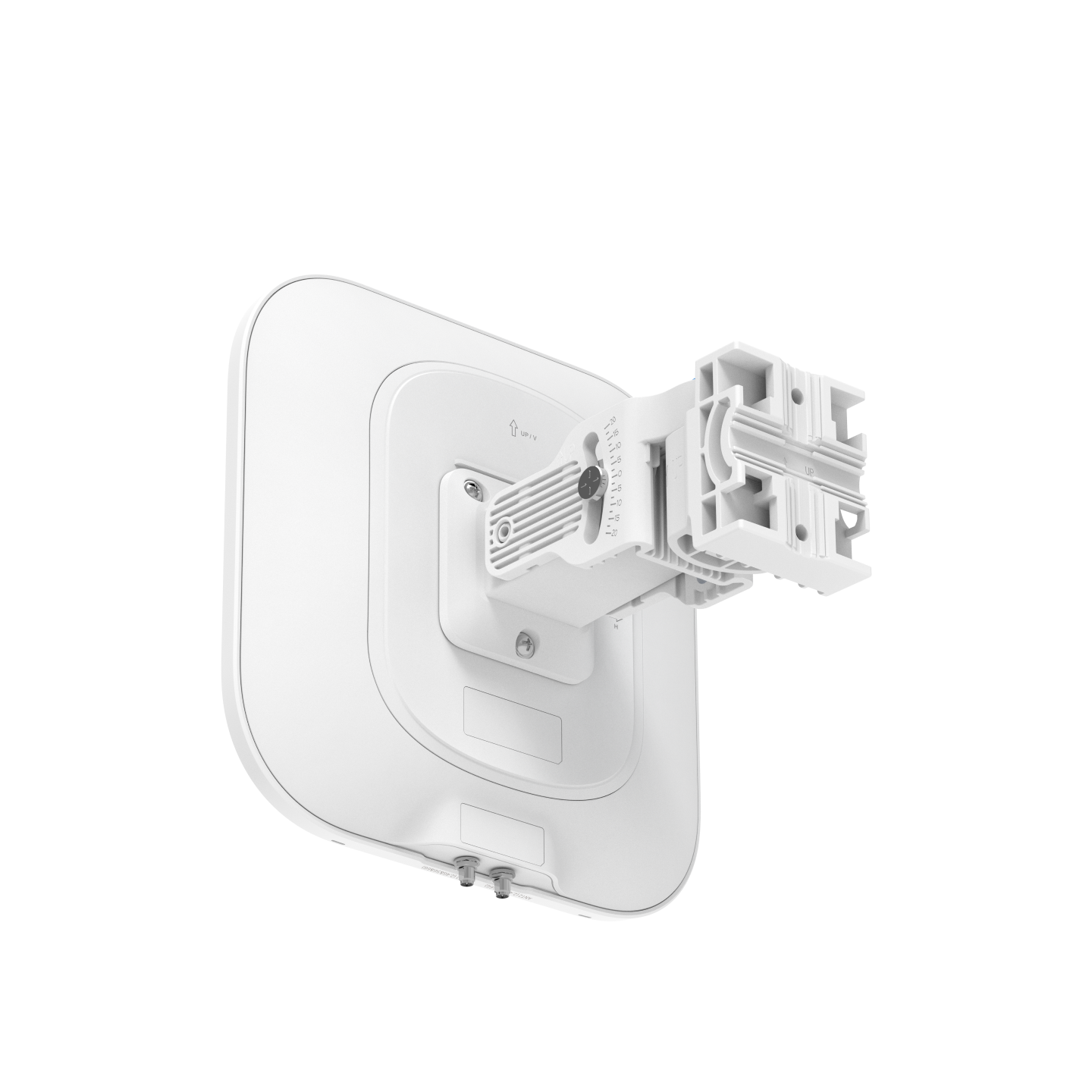

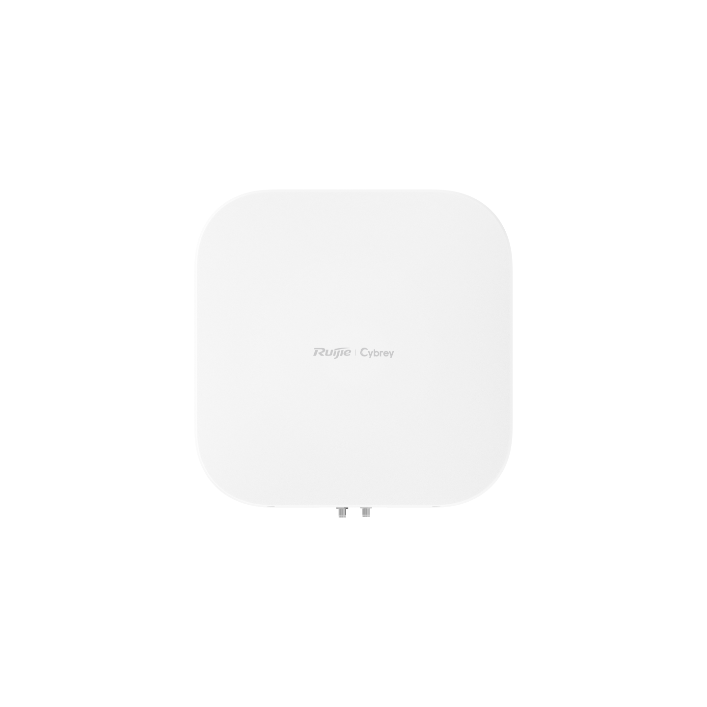

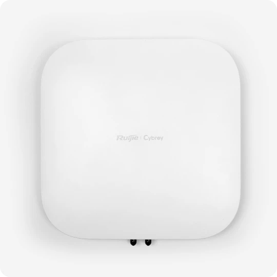

RG-ANT90-T2, Tri‑band Two‑Element Cross‑Polarized High‑Gain Outdoor Antenna
  • Cross-polarized antenna supporting 2.4/5/6 GHz Wi-Fi.
  • 11 dBi peak gain on 5 GHz and 6 GHz, 9 dBi on 2.4 GHz for stronger, longer-range signals.
  • 65° horizontal and 18° vertical beamwidths on 5 GHz and 6 GHz, plus 60° horizontal and 20° vertical beamwidths on 2.4 GHz for precise signal focusing, reduced interference, and less wasted coverage.
Key Specifications
View More
RG-ANT90-T2 Tri‑band Two‑Element Cross‑Polarized High‑Gain Outdoor Antenna
65° Beamwidth Antenna
Simplified deployment: Fewer feedlines and mounting points Focused signal with broad lateral coverage, balancing coverage efficiency & signal strength

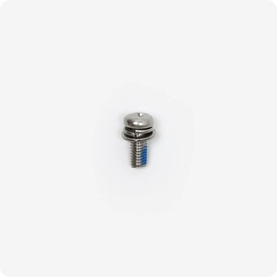

In the Box
  • RG-ANT90-T2
    x1

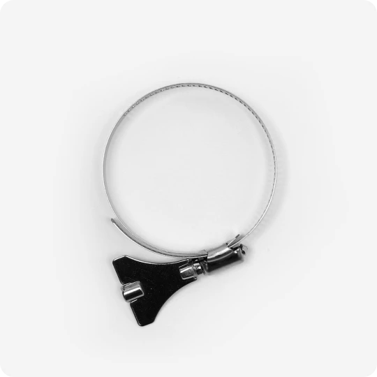

  • Hose clamp
    x2

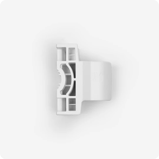

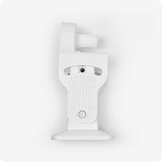

  • Base bracket
    x1
  • Antenna mounting assembly
    x1
  • Wing knob

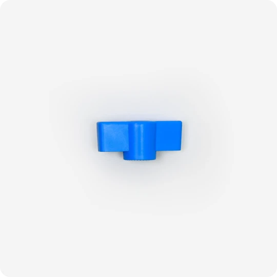

    x2

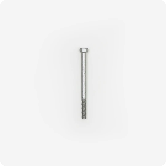

  • M5 x 66 mm Phillips hex head machine screw
    x2

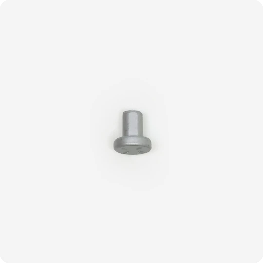

  • Positioning nut
    x1

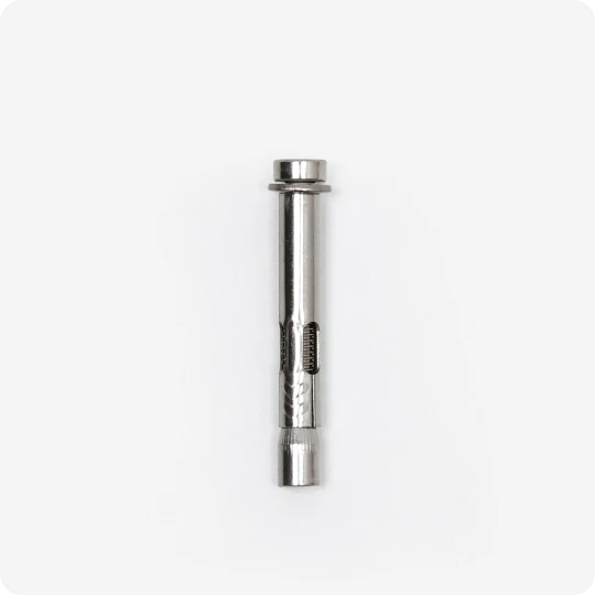

  • M6 x 70 mm expansion anchor
    ×2
  • M5 x 12 mm Phillips pan head screw
    ×3
*Accessory pictures are for reference only. Specifications of accessories such as power cords vary by sales region and country. Please refer to the actual item received.
Specifications
Operating frequency bands
  • Band 1: 2400–2500 MHz
    Band 2: 5150–6425 MHz
    Band 3: 6425–7125 MHz
Polarization
  • Vertical and horizontal polarization
Antenna gain
  • Band 1: 9 dBi
    Band 2: 11 dBi
    Band 3: 11 dBi
3-dB azimuth beamwidth
  • Band 1: 65°±10°
    Band 2: 65°±10°
    Band 3: 60°±10°
3-dB elevation beamwidth
  • Band 1: 27°±5°
    Band 2: 15°±5°
    Band 3: 15°±5°
Voltage standing wave ratio
  • Band 1: < 2
    Band 2: < 2
    Band 3: < 2.5
Antenna connector
  • 2 x RP-SMA female antenna connectors
Housing material
  • PC
Unit dimensions (W x D x H)
  • 240 mm x 240 mm x 41.5 mm (9.45 in. x 9.45 in. x 1.63 in.)
Packaging dimensions (W x D x H)
  • 349 mm x 349 mm x 84 mm (13.74 in. x 13.74 in. x 3.31 in.)
Unit weight
  • 0.615 kg (1.36 lbs, without the mounting bracket)
Packaging weight
  • 1.8 kg (3.97 lbs)
Color
  • White
Power Handling
Maximum input power
  • 30 dBm per port
IP rating
  • IP55

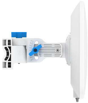

Mounting options
  • Wall-mount and pole-mount
