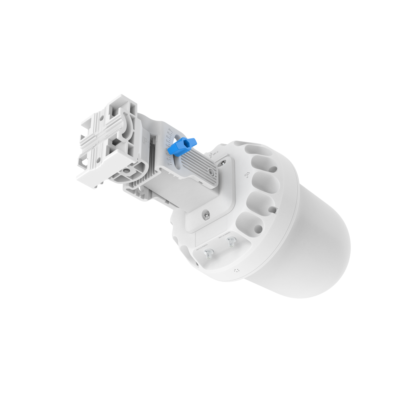

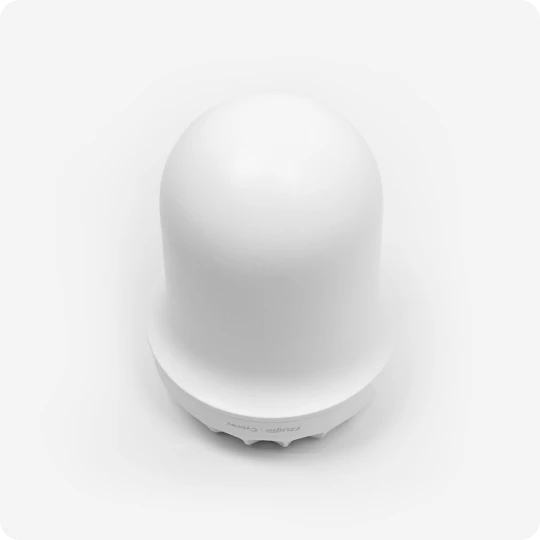

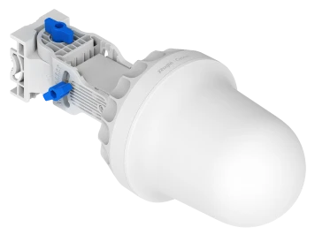

RG-ANT30-D2, Dual‑Band Directional High‑Gain Outdoor Antenna
  • High-performance dual-band directional outdoor antenna for directional coverage in either the 2.4 GHz or 5 GHz band.
  • 14 dBi peak gain on 5 GHz and 12 dBi on 2.4 GHz for stronger, longer-range signals.
  • 20° horizontal and vertical beamwidths on 5 GHz, and 40° horizontal and vertical beamwidths on 2.4 GHz for precise signal focusing, reduced interference, and less wasted coverage.

The Luneburg Lens Antenna technology focuses energy more effectively, boosting signal strength and extending coverage compared with conventional antennas.
Superior Signal Performance of Luneburg Lens Antennas
The lens of the Luneberg lens antenna. Signals passing through the lens are gradually focused into a beam, rather than radiating outward in all directions.
  • Standard directional APs — wide beams, with signal strength declining rapidly over distance
  • APs with Luneburg Lens Antennas — narrow beams that concentrate energy and maintain strong signals over long distances
    In a 100 m coverage scenario with heavy interference, Luneberg lens antennas deliver up to 2x the throughput of traditional directional antennas.

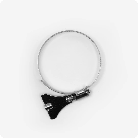

  • Hose clamp
    × 2

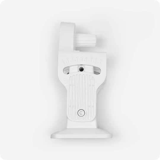

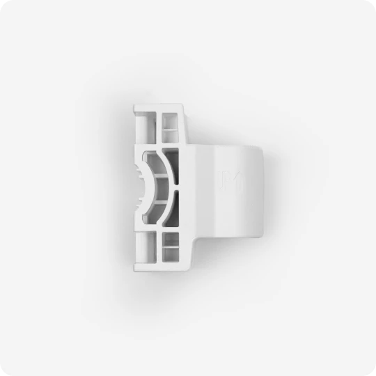

  • Base bracket
    × 1

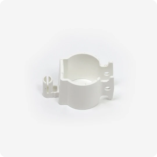

  • Antenna mounting assembly
    × 1

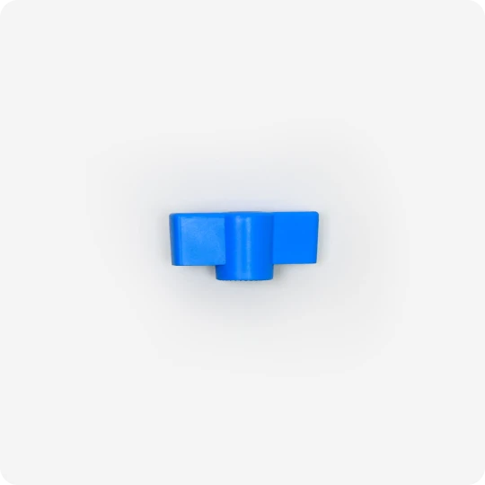

  • Wing knob
    × 2

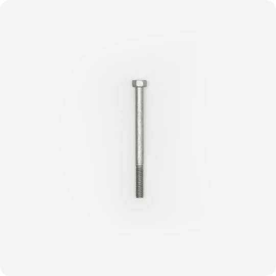

  • M5 x 66 mm Phillips hex head machine screw
    × 2

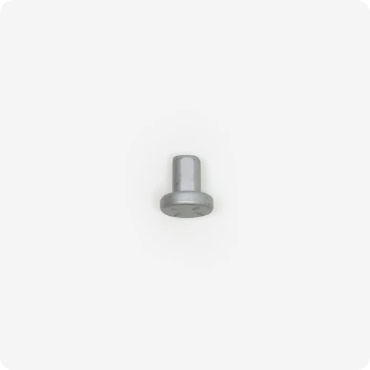

  • Positioning nut
    × 1

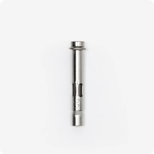

  • M6 x 70 mm expansion anchor
    × 2

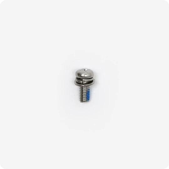

  • M5 x 12 mm Phillips pan head screw
    × 3

Mounting options
  • Wall-mount and pole-mount
