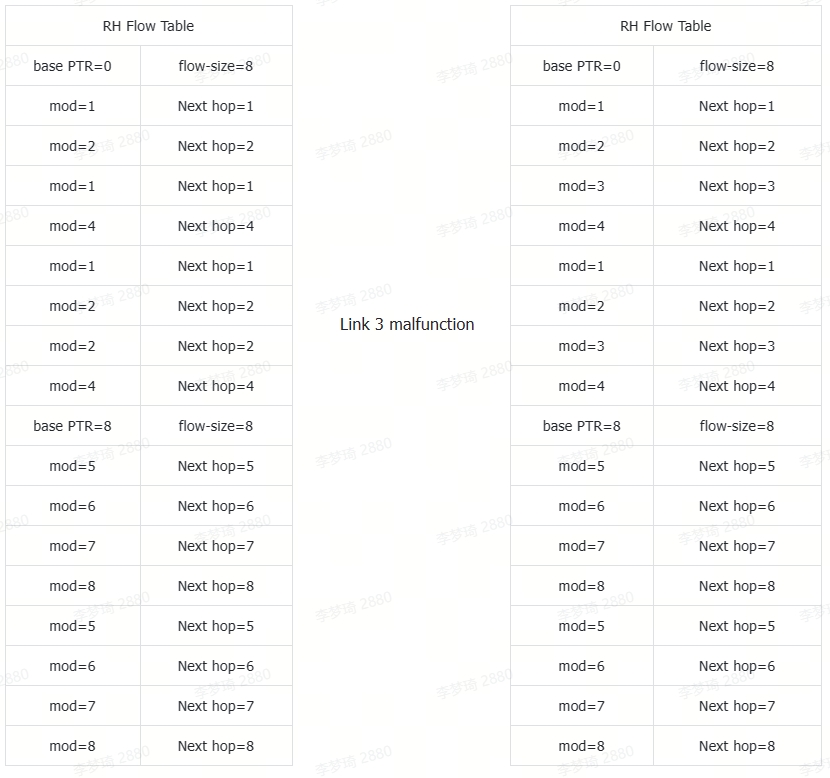

Generate an index table (RH Flow Set Table) on the switch to store the next-hop routing address corresponding to the relevant index value. After the data message passes through the routing table, the corresponding ECMP base value is found, and the HASH factor is extracted for the HASH operation. When the HASH Key and the ECMP number are taken as the remainder, the remainder operation is performed with the initial number regardless of whether there is a faulty link. Therefore, the operation results are consistent, and the data of the non-faulty link is still forwarded according to the original link. As shown in the figure below, after link 3 fails, the software CPU will update the RH flow table in time and replace the failed link with the normal link evenly.
▲Fig 6: Schematic diagram of elastic HASH index table replacement
