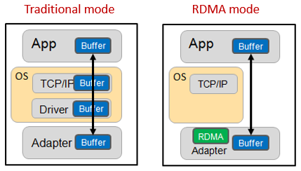

RDMA (Remote Direct Memory Access), commonly known as remote DMA technology, is created to solve the delay in server-side data processing during network transmission.
▲Figure 1 Comparison of working mechanisms between traditional mode and RDMA mode
As shown in the figure above, in the traditional mode, the process of transmitting data between applications on two servers is as follows:
● First, the data must be copied from the application cache to the TCP protocol stack cache in the kernel;
● Then copy it to the driver layer;
● Finally, copy it to the network card cache.
Multiple memory copies necessitate repeated CPU intervention, leading to significant processing delays of up to tens of microseconds. Additionally, the CPU's heavy involvement in this process consumes substantial performance resources, which can adversely affect normal data computations.
In RDMA mode, application data can bypass the kernel protocol stack and write directly to the network card. The significant benefits include:
● The processing delay is reduced from tens of microseconds to less than 1 microsecond.
● The whole process requires almost no CPU involvement, saving performance.
● The transmission bandwidth is higher.

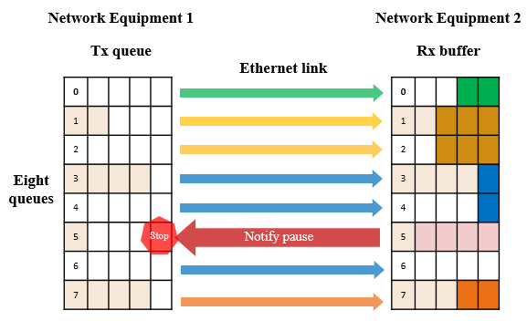

PFC (Priority-based Flow Control) is a queue-based backpressure mechanism that prevents buffer overflow and packet loss by sending Pause frames to notify the upstream device to pause packet transmission.
▲Figure 2 Schematic diagram of PFC working mechanism
PFC allows you to suspend and restart any of the virtual channels individually without affecting the traffic of other virtual channels. As shown in the figure above, when the buffer consumption of queue 5 reaches the set PFC flow control waterline, PFC back pressure will be triggered:
● The local switch triggers a PFC Pause frame and sends it back to the upstream device.
● Upstream device receives the Pause frame, will pause sending messages in the queue and cache the messages in the Buffer.
● If the buffer of the upstream device also reaches the threshold, Pause frames will continue to be triggered to exert back pressure on the upstream device.
● Finally, data packet loss is avoided by reducing the sending rate of the priority queue.
● When the buffer occupancy drops to the recovery waterline, a PFC release message is sent.

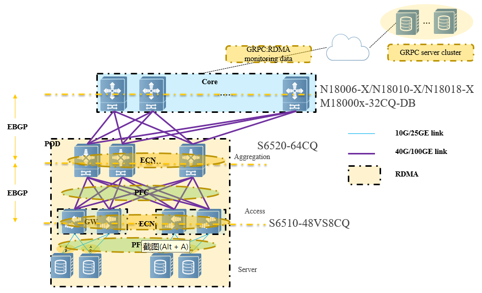

Ruijie Networks has built an RDMA network that simulates real services in its R&D center. The architecture is as follows:
▲Figure 4 Ruijie Networks RDMA networking architecture
Networking model
: large core three-level networking architecture, with high-density 100G line cards used in the core;
● In the POD: The spine uses a BOX device that provides 64 100G interfaces, and the leaf uses a BOX device that provides 48 25G interfaces + 8 100G interfaces;
● Leaf acts as a server gateway and supports PFC-based flow control between servers (identifying the DSCP of packets and performing PG mapping), as well as congestion ECN marking.
● RDMA only runs inside the POD. There is no cross-POD RDMA traffic, so the core does not need to be aware of RDMA traffic.
● To avoid packet loss due to congestion. PFC flow control technology needs to be deployed between Leaf and Spine. Spine devices also need to support congestion-based ECN marking.
● Leaf and Spine devices support PFC flow control frame statistics, ECN marking statistics, congestion packet loss statistics, queue-based congestion statistics, etc., and support synchronizing statistical information to a remote gRPC server through gRPC.
