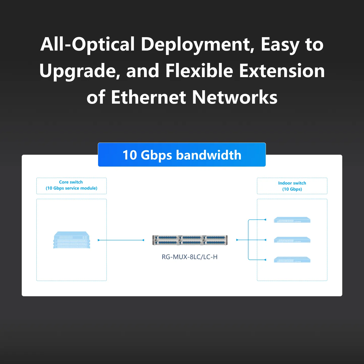

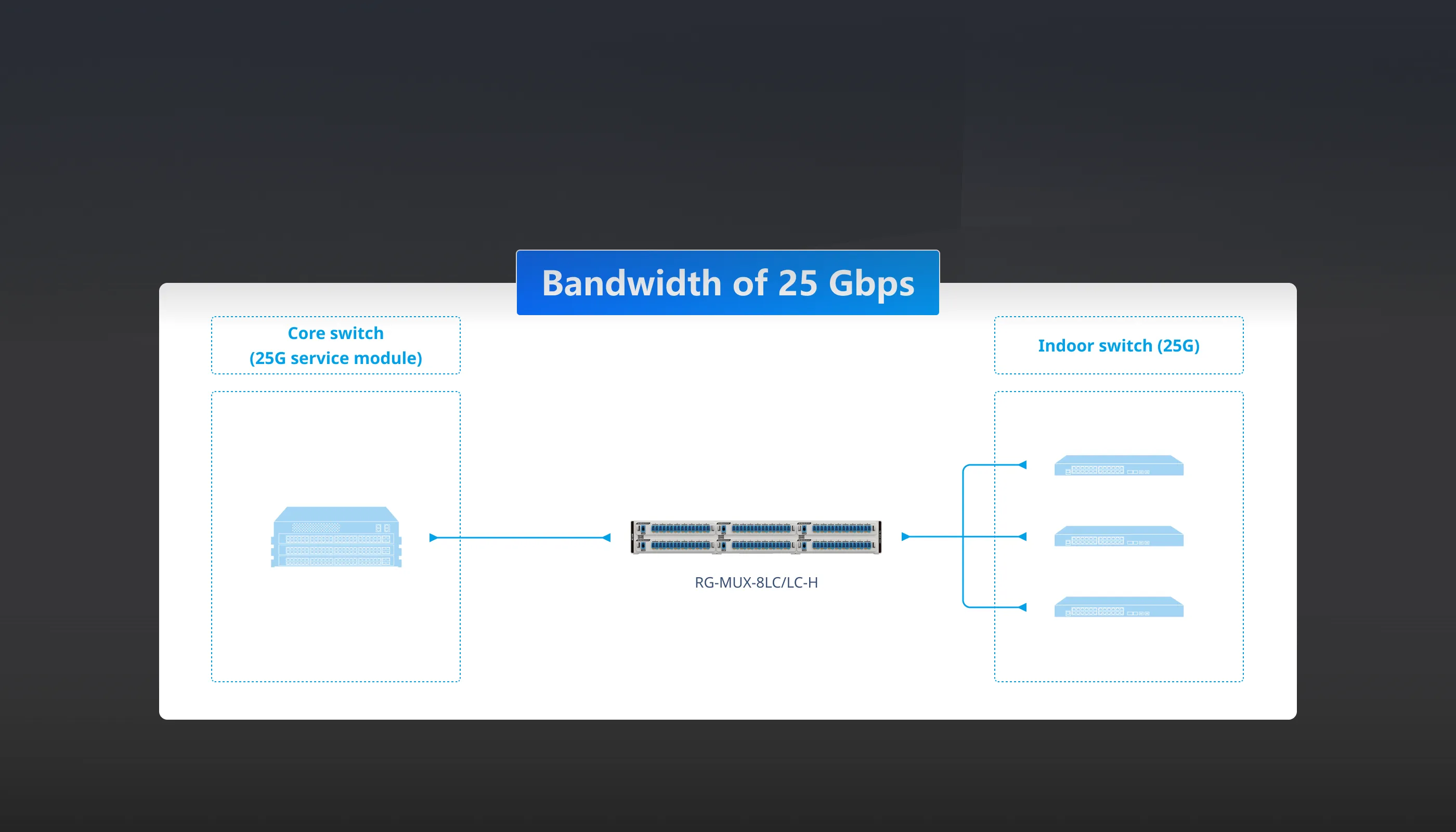

All-Optical Deployment, Easy to Upgrade, and Flexible Extension of Ethernet Networks
Bandwidth can be upgraded from 1 Gbps to 10 Gbps without need to change the backbone cabling area. Switches of different rates can be replaced or added as needed. Transparent distribution devices are plug-and-play, allowing for easy deployment and rapid capacity expansion.
