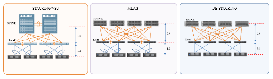

Comparison
The difference between the architectures of stacking, MLAG and De-stacking is presented in the figure below. In addition a concise comparison is presented below in table 1.
                                                                                                ▲ Figure 8
Comparison
Stacking
MLAG
De-stacking
Reliability
Low, A-S active and standby operation,
Maintenance status through software heartbeat; The CPU is affected, and the state and entry information need to be synchronized, and there is a risk of brain split/double master miskill.
Medium:
Dual Active run Protocol-level coupling, maintaining state through software heartbeat; You still need to synchronize status and entry information.
High:
Dual Active run
No horizontal connection, full CPU performance, no stack split risk, no status, and entry synchronization.
Configuration complexity
Medium,
It involves system configuration, which needs to configure VLS links, primary and backup management, etc.
High:
Involving control surface coupling, need to configure information synchronization, state detection, etc. (nearly 30 configurations per device).
Medium:
There is no synchronization or detection content, and virtual LACP, ARP transfer host routing, Monitor Link, etc. are configured.
Up gradation risks
High:
There are version compatibility issues, minute level upgrade, the whole group restart will cause business interruption.
Low:
The upgrade of one device does not affect the other device.
The upgrade time of the terminal is short, in seconds.
Low:
Server configuration
No additional configuration required.
The server NIC is configured with mode4 and supports the dual-send ARP function.
▲ Table 1
