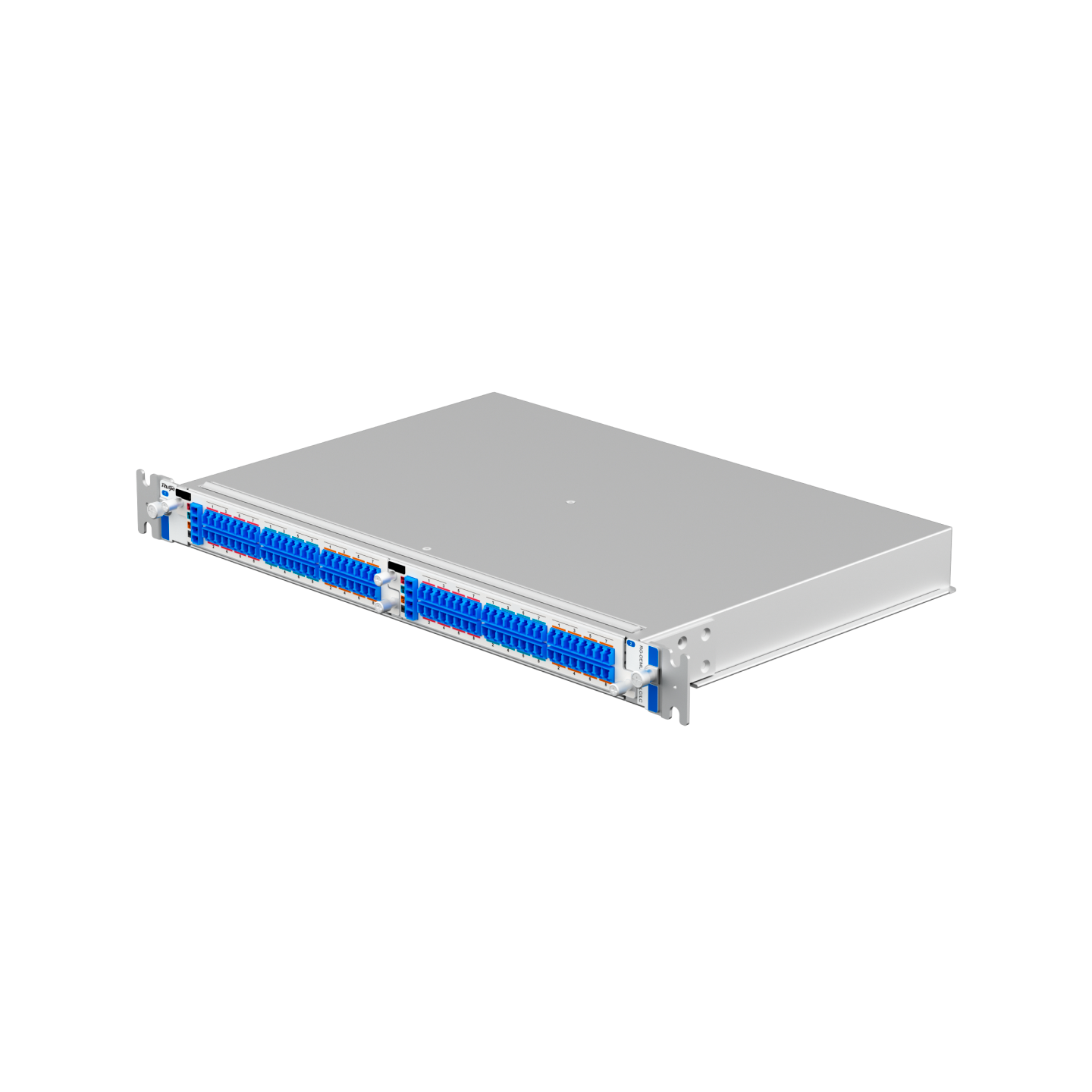

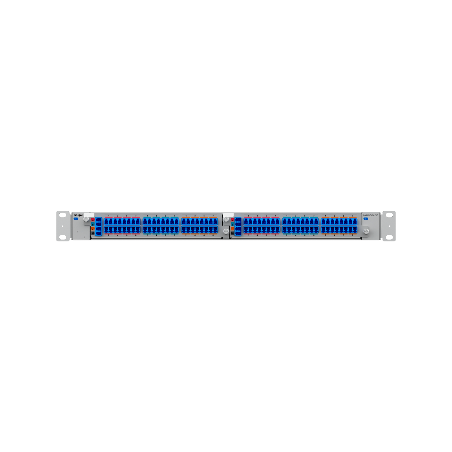

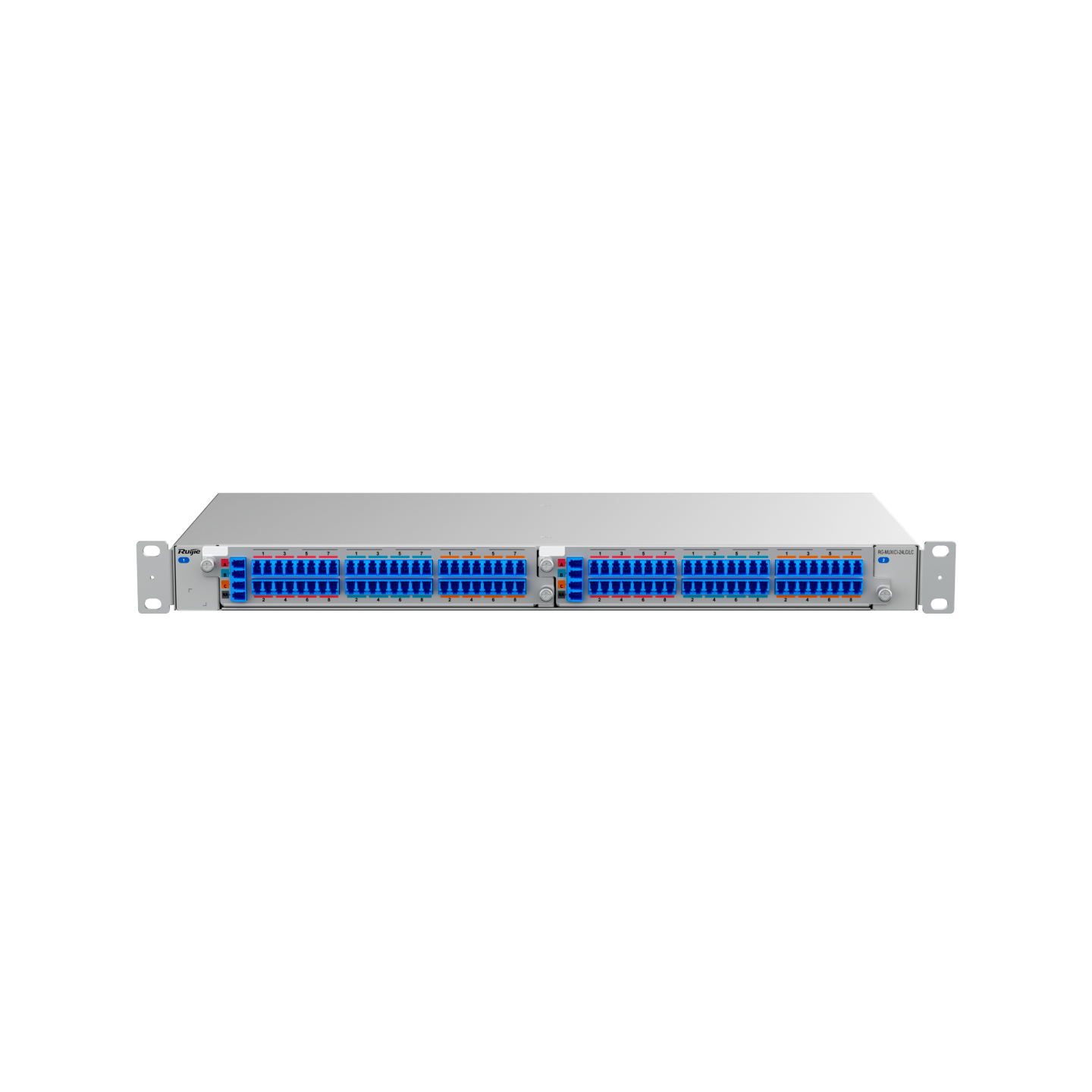

Used in Simplified Optical Ethernet solution to make distribution nodes passive and provide exclusive Gigabit/10G bandwidth for Fiber-to-The-Room (FTTR)
8-port modular transparent distribution device used with splitters
RG-MUX-EXTSplitter (transparent distribution expansion module)
RG-MUX-8LC/LC8-port modular transparent distribution device
| Model |
RG-DEMUX(C)-24LC/LC |
RG-DEMUX-48LC/LC |
RG-MUX-48LC/LC |
| Name |
24-port demultiplexer, with chassis and one reserved expansion slot |
48-port demultiplexer |
48-port transparent multiplexer |
| Number of CWDM 16-channel demultiplexer groups |
3 groups |
6 groups |
3 groups |
| Installation location |
Core side |
Core side |
Building side |
| Maximum number of ports supported |
24 |
48 |
48 |
| Dimension (W × D × H) |
297.6 mm * 438.5 mm * 40.2 mm |
210.2 mm * 440 mm * 39.8 mm |
