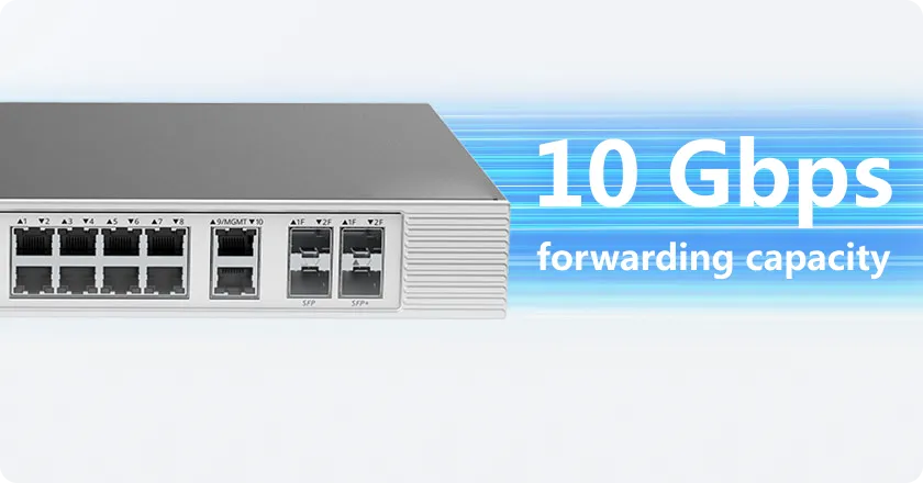

RG-WS6012-L High-Performance 10 Gbps Wireless Access Controller
The RG-WS6012-L access controller (AC) is designed for small- and medium-scale networks, delivering 10 Gbps forwarding capacity. It provides high scalability, enabling flexible configuration and management of access points (APs).
High Performance and High Capacity
Multiple high-speed interfaces, delivering 10 Gbps forwarding capability
Management of 32 APs by default, which can be expanded to 896 APs to flexibly meet service expansion needs

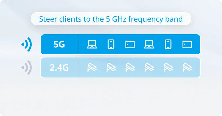

Frequency-based load balancing used to steers dual-band clients to the 5 GHz frequency band, enhancing bandwidth utilization

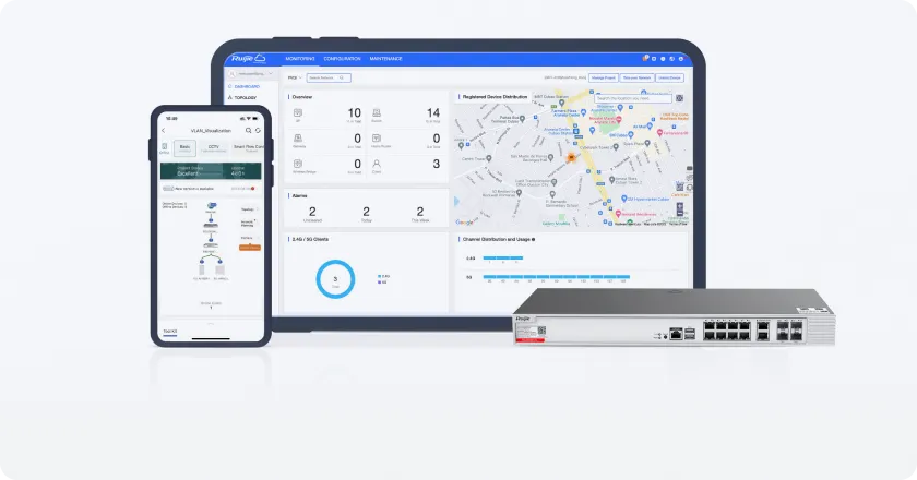

Cloud Unified Management, Efficient O&M
Unified management through Ruijie Cloud, eliminating the need for onsite provisioning
Real-time alarms and intelligent troubleshooting, improving O&M efficiency

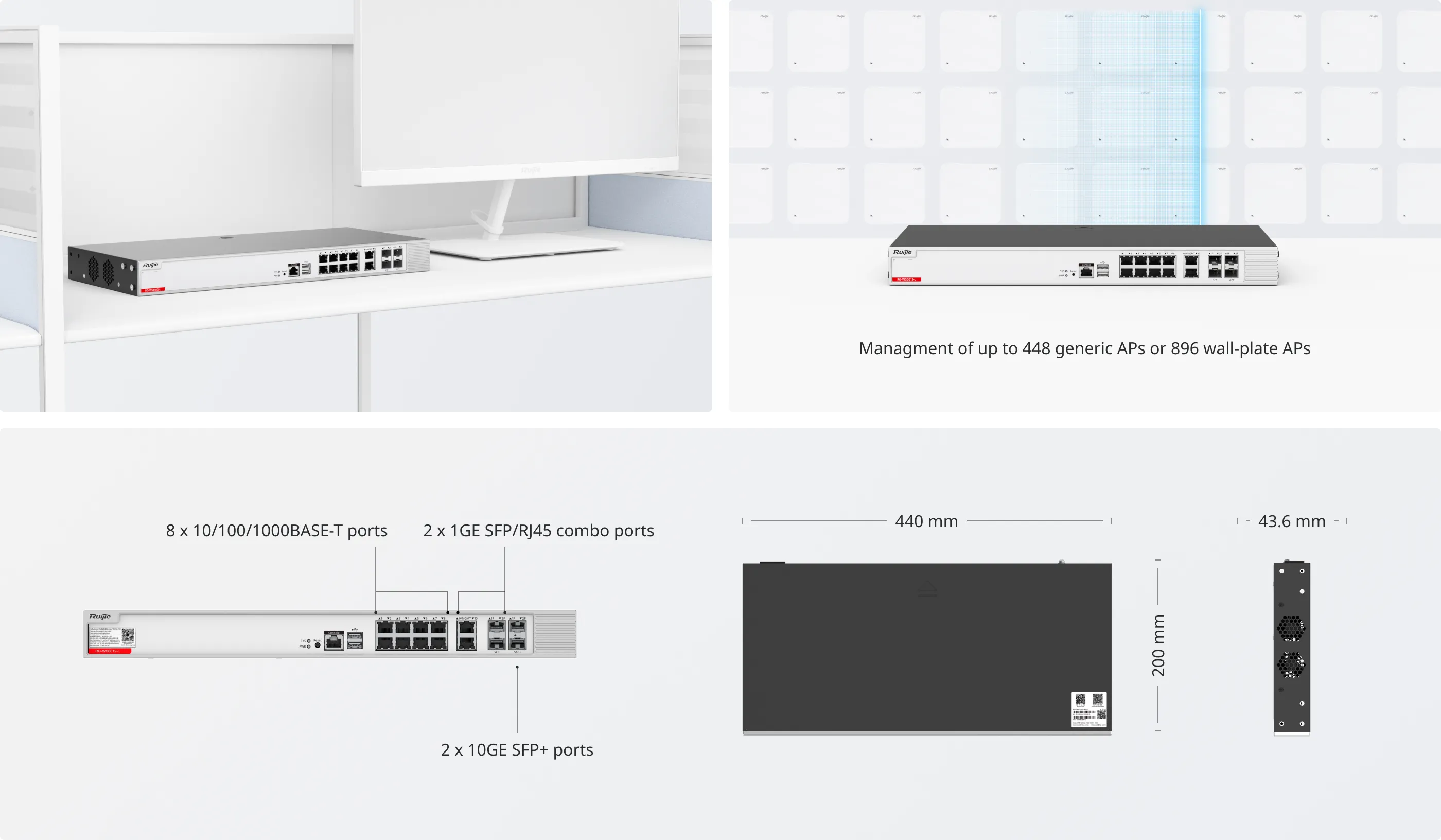

Unit dimensions (W x D x H)
440 mm x 200 mm x 43.6 mm (17.32 in. x 7.87 in. x 1.72 in., without rack-mount brackets)
486.2 mm x 205 mm x 43.6 mm (19.14 in. x 8.07 in. x 1.72 in., including rack-mount brackets)

Fixed service port
8 x 10/100/1000BASE-T ports
2 x 1GE SFP/RJ45 combo ports
● RJ45 ports support 10/100/1000BASE-T.
● Port 9/MGMT can also be used as a management port.
2 x 10GE SFP+ ports
Fixed management port
1 x RJ45 console port
2 x USB 3.0 ports, compatibility with USB 2.0
