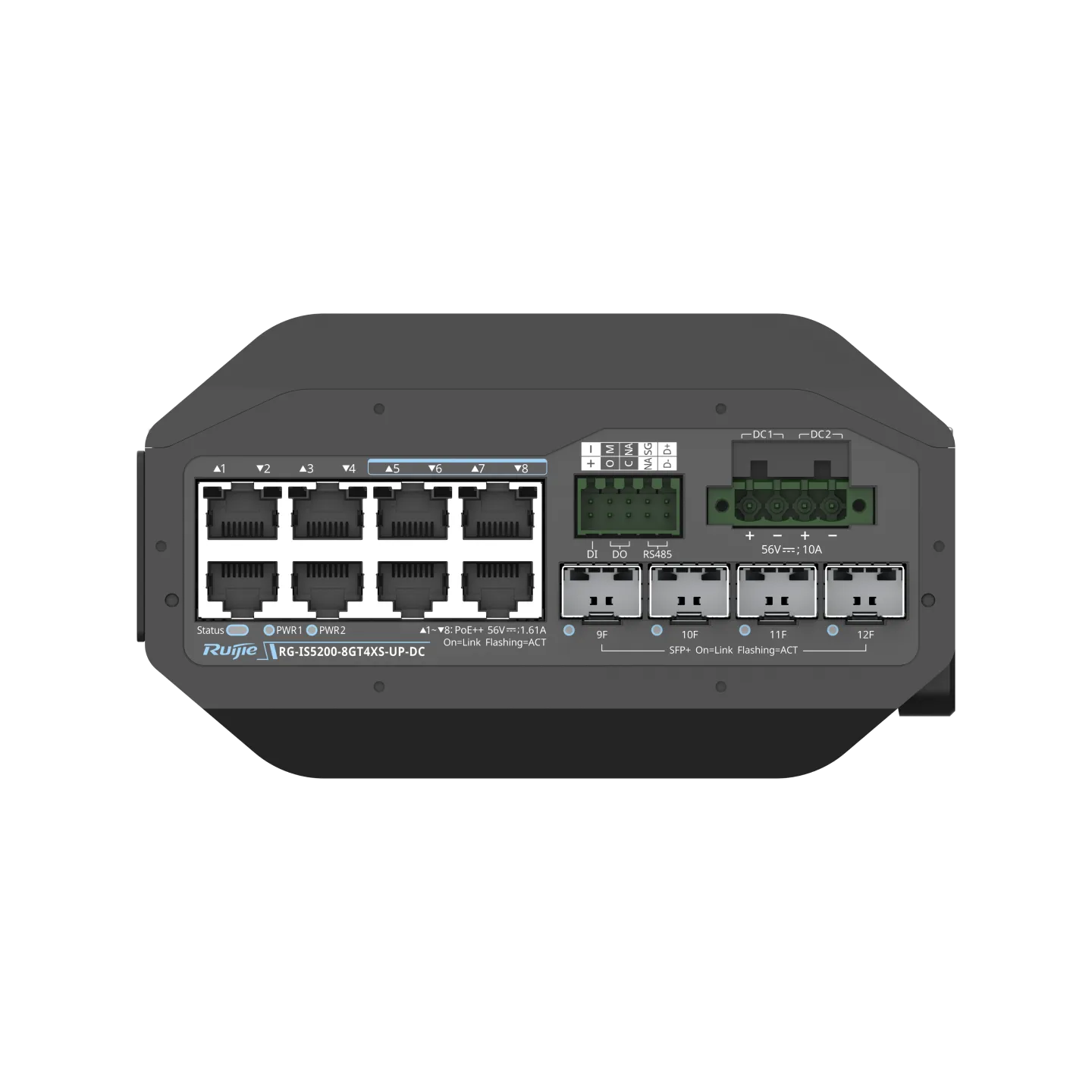

RG-IS5200-8GT4XS-UP-DC Industrial Ethernet Switch
Recommended for outdoor surveillance, special weather conditions, and manufacturing scenarios, meeting demands of complex environments, such as operation in high and low temperatures, vibration resistance, and surge protection
Dòng
Tính năng nổi bật
  • Industrial-grade operating temperature range, withstanding harsh environments
  • Industrial-grade dual power input, ensuring high safety and availability
  • Multiple protections with robust interference resistance capability
  • Long-distance PoE for more convenient network deployment
  • Virtual switching unit (VSU) for simplified network management and more efficient network operation
This next-generation Gigabit Ethernet switch is designed for security, efficiency, and energy savings in industrial environments, featuring easy and flexible DIN rail mounting.

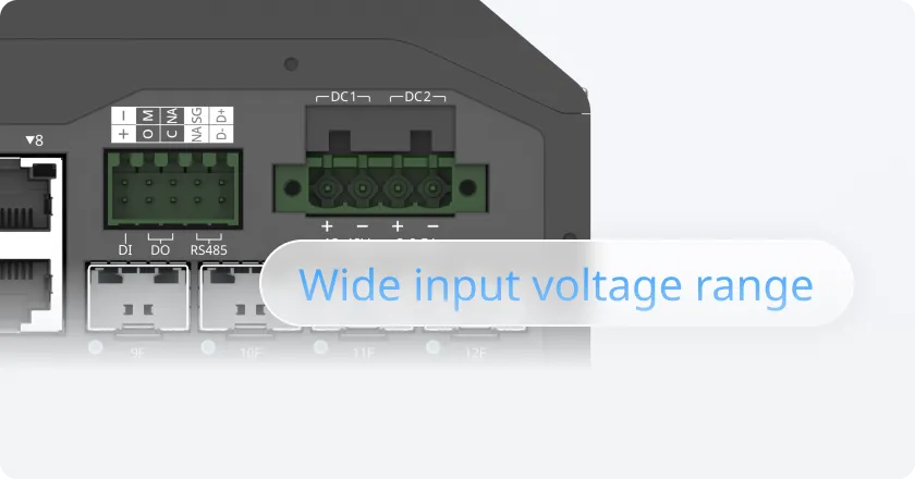

Industrial-Grade Dual Power Input for High Safety and Availability
A wide input voltage range protects the switch against reverse polarity, short circuits, overcurrent, and overvoltage, ensuring continuous operation without power interruptions.

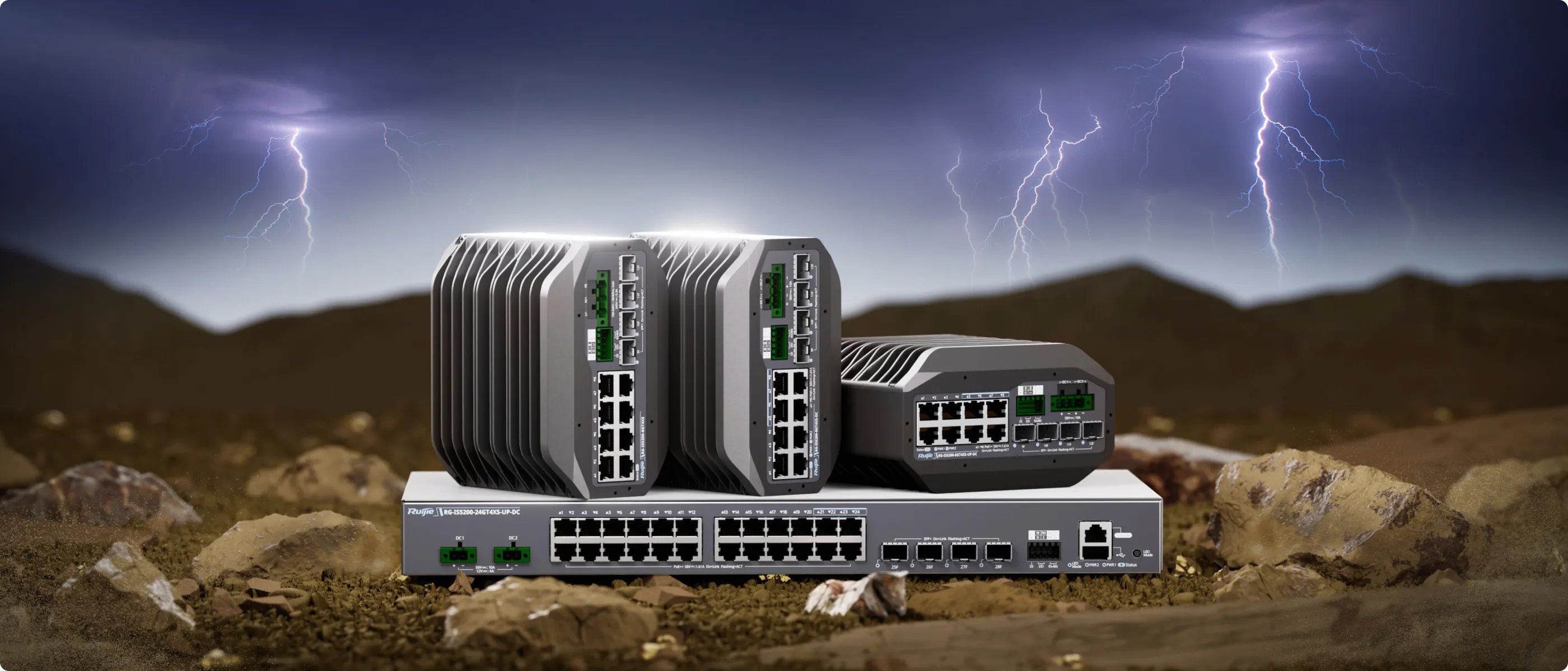

Multiple Protections with Robust Interference Resistance Capability
Featuring waterproof, dustproof, surge protection, and vibration resistance, this switch ensures reliable operation in harsh environments.

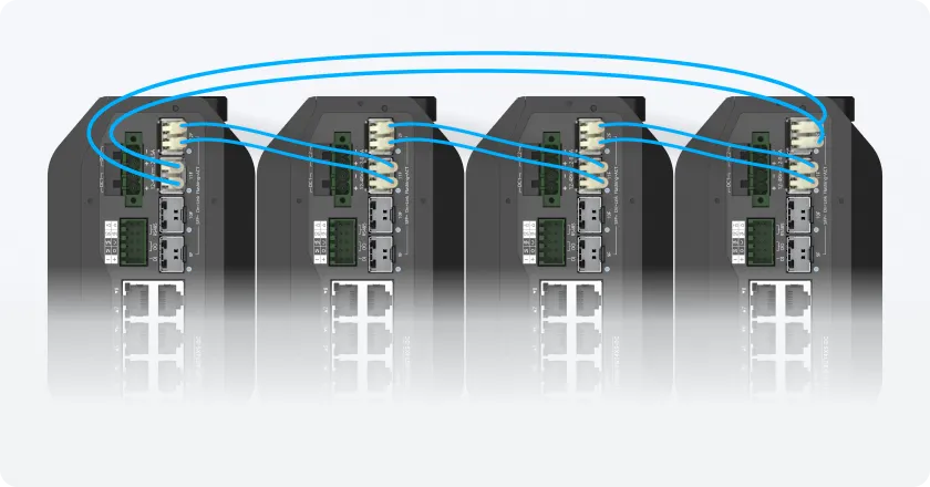

VSU for Simplified Network Management
VSU helps achieve unified management of multiple devices, millisecond-level fault recovery, and flexible device expansion, ensuring efficient network operation.

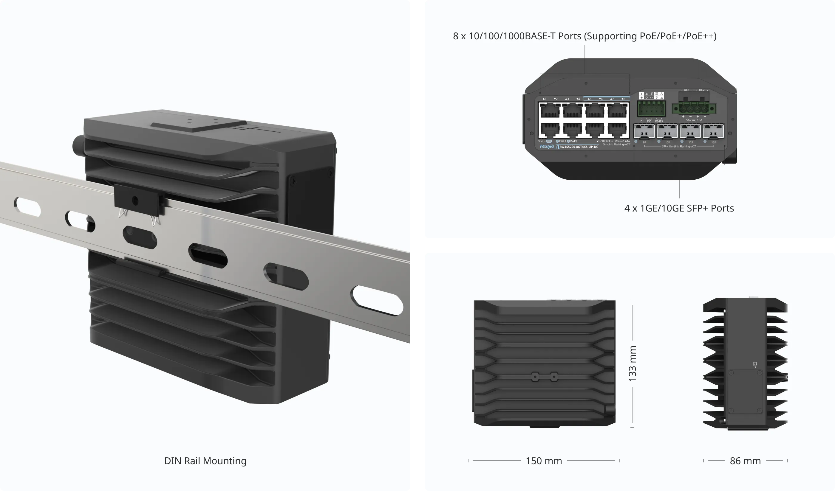

Unit dimensions (W x D x H)
150mm x 133mm x 86mm
442mm x 220mm x 43.6mm
Unit weight
1.49kg
1.5kg
1.53kg
2.85kg
installation method
Desktop mounting, DIN rail mounting, and wall mounting
Desktop mounting, rack mounting, and wall mounting

Dual redundant DC (DC1/DC2) input:
● Rated voltage: 12 V DC to 48 V DC
● Maximum voltage: 9.6 V DC to 60 V DC
● Rated current: 2 A to 0.5 A

RG-IS5200-8GT4XS
8 x 10/100/1000BASE-T ports, 4 x 1GE/10GE SFP+ ports
Built-in AC power supply, single AC power input, fanless design, IP41 (supporting upgrade to IP55), DIN rail mounting
RG-IS5200-
8GT4XS-DC
Dual DC power supplies, supporting 60 W power input through the IPA60 power adapter, fanless design, IP41 (supporting upgrade to IP55), DIN rail mounting
RG-IS5200-
8GT4XS-UP-DC
8 x 10/100/1000BASE-T ports, PoE/PoE+/PoE++ power supply, 4 x 1GE/10GE SFP+ ports
Dual DC power supplies, supporting 240 W power input through the IPA240-P power adapter, fanless design, IP41 (supporting upgrade to IP55), DIN rail mounting
The first 4 Ethernet ports can be connected to PoE-REP, with a transmission rate of 1000M/100M/10M over a maximum transmission distance of 200 m (656.17 ft.).
The last 4 Ethernet ports can be connected to PoE-REP, with a transmission rate of 1000M/100/10M over a maximum transmission distance of 200 m (656.17 ft.), or of 100M over a maximum transmission distance of 400 m (1,312.34 ft.).
RG-IS5200-
24GT4XS-UP-DC
24 x 10/100/1000BASE-T ports, PoE/PoE+/PoE++, 4 x 1GE/10GE SFP+ ports
Dual DC power supplies, supporting 60 W power input (without PoE) through the IPA60 power adapter or 240 W power input (with PoE) through the IPA240-P power adapter, fanless design, IP40, mounting in a 19-inch rack
The first 20 Ethernet ports can be connected to PoE-REP, with a transmission rate of 1000M/100M/10M over a maximum transmission distance of 200 m (656.17 ft.).
The last 4 Ethernet ports can be connected to PoE-REP, with a transmission rate of 1000M/100M/10M over a maximum transmission distance of 200 m (656.17 ft.), or of 100M over a maximum transmission distance of 400 m (1,312.34 ft.).
