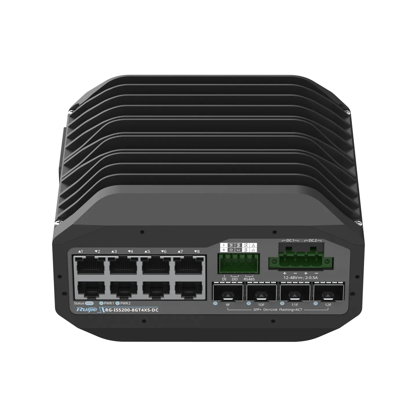

Tính năng nổi bật
  • Industrial-grade operating temperature range, withstanding harsh environments
  • Industrial-grade dual power input, ensuring high safety and availability
  • Multiple protections with robust interference resistance capability
  • Long-distance PoE for more convenient network deployment
  • Virtual switching unit (VSU) for simplified network management and more efficient network operation

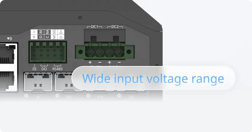

Industrial-Grade Dual Power Input for High Safety and Availability
A wide input voltage range protects the switch against reverse polarity, short circuits, overcurrent, and overvoltage, ensuring continuous operation without power interruptions.

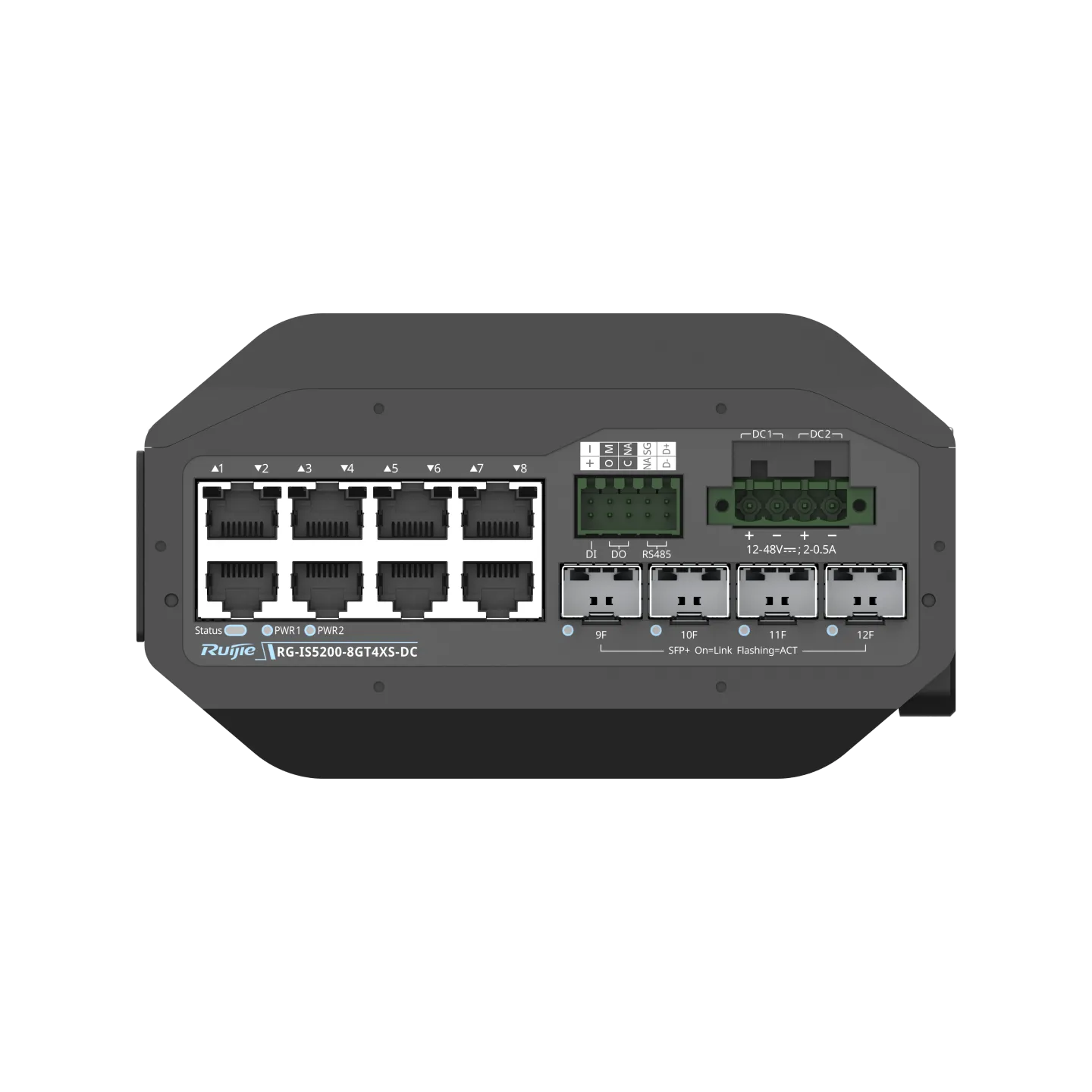

RG-IS5200-8GT4XS
RG-IS5200- 8GT4XS-DC
RG-IS5200-8GT4XS-UP-DC
RG-IS5200-24GT4XS-UP-DC
Fixed ports
8x10/100/1000BASE-T ports
4 x 1GE/10GE SFP+ ports
8 x 10/100/1000BASE-T ports
8 x 10/100/1000BASE-T ports, supporting PoE/PoE+/PoE++
24 x 10/100/1000BASE-T ports, supporting PoE/PoE+/PoE++
Fixed management port
1 x RJ45 console port
RS-485 Port
1 x RS-485 port, supporting Modbus
DIDO
1 x DI, 1 x DO
USB
1 x USB 2.0 port

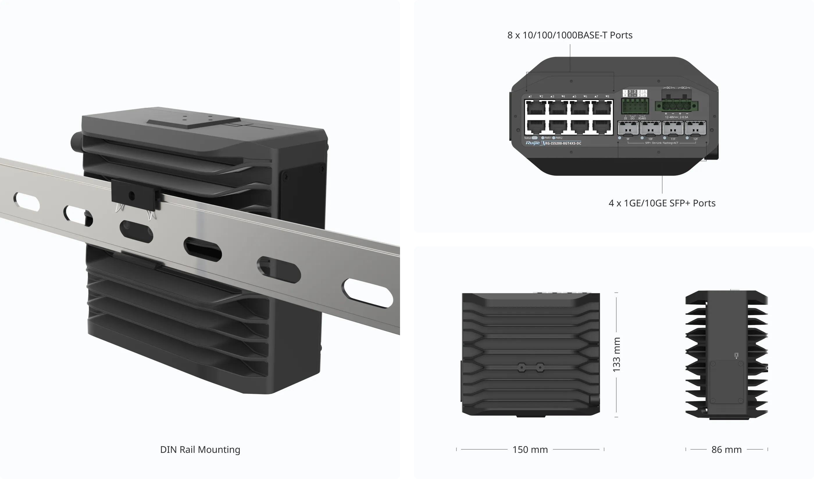

Unit dimensions (W x D x H)
150mm x 133mm x 86mm
442mm x 220mm x 43.6mm
Unit weight
1.49kg
1.5kg
1.53kg
2.85kg
installation method
Desktop mounting, DIN rail mounting, and wall mounting
Desktop mounting, rack mounting, and wall mounting

Dual redundant DC (DC1/DC2) input:
● Rated voltage: 12 V DC to 48 V DC
● Maximum voltage: 9.6 V DC to 60 V DC
● Rated current: 2 A to 0.5 A
