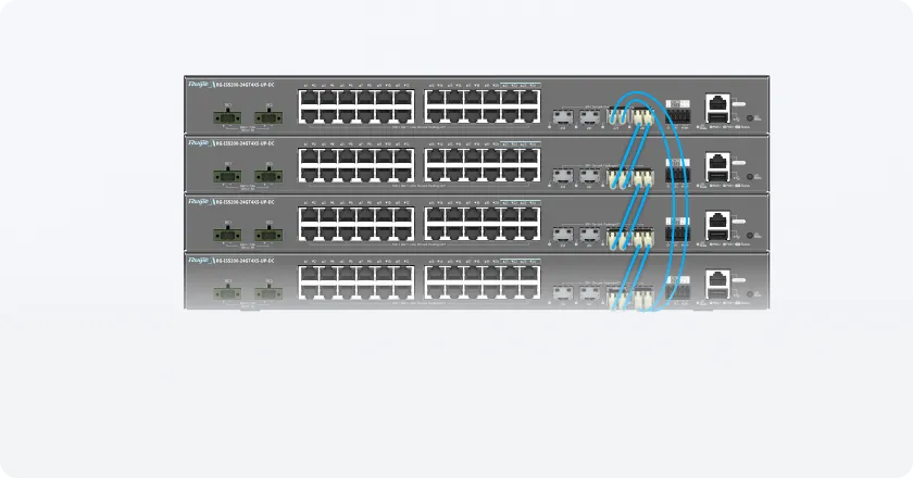

  • Virtual switching unit (VSU) for simplified network management and more efficient network operation

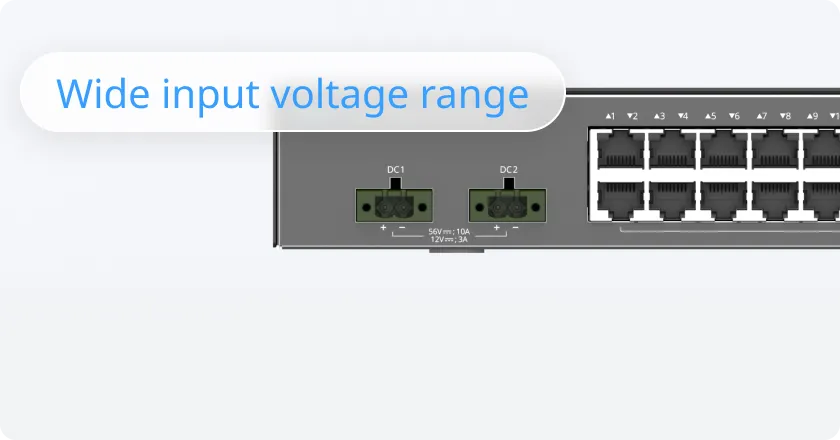

Industrial-Grade Dual Power Input for High Safety and Availability
A wide input voltage range protects the switch against reverse polarity, short circuits, overcurrent, and overvoltage, ensuring continuous operation without power interruptions.

VSU for Simplified Network Management
VSU helps achieve unified management of multiple devices, millisecond-level fault recovery, and flexible device expansion, ensuring efficient network operation.

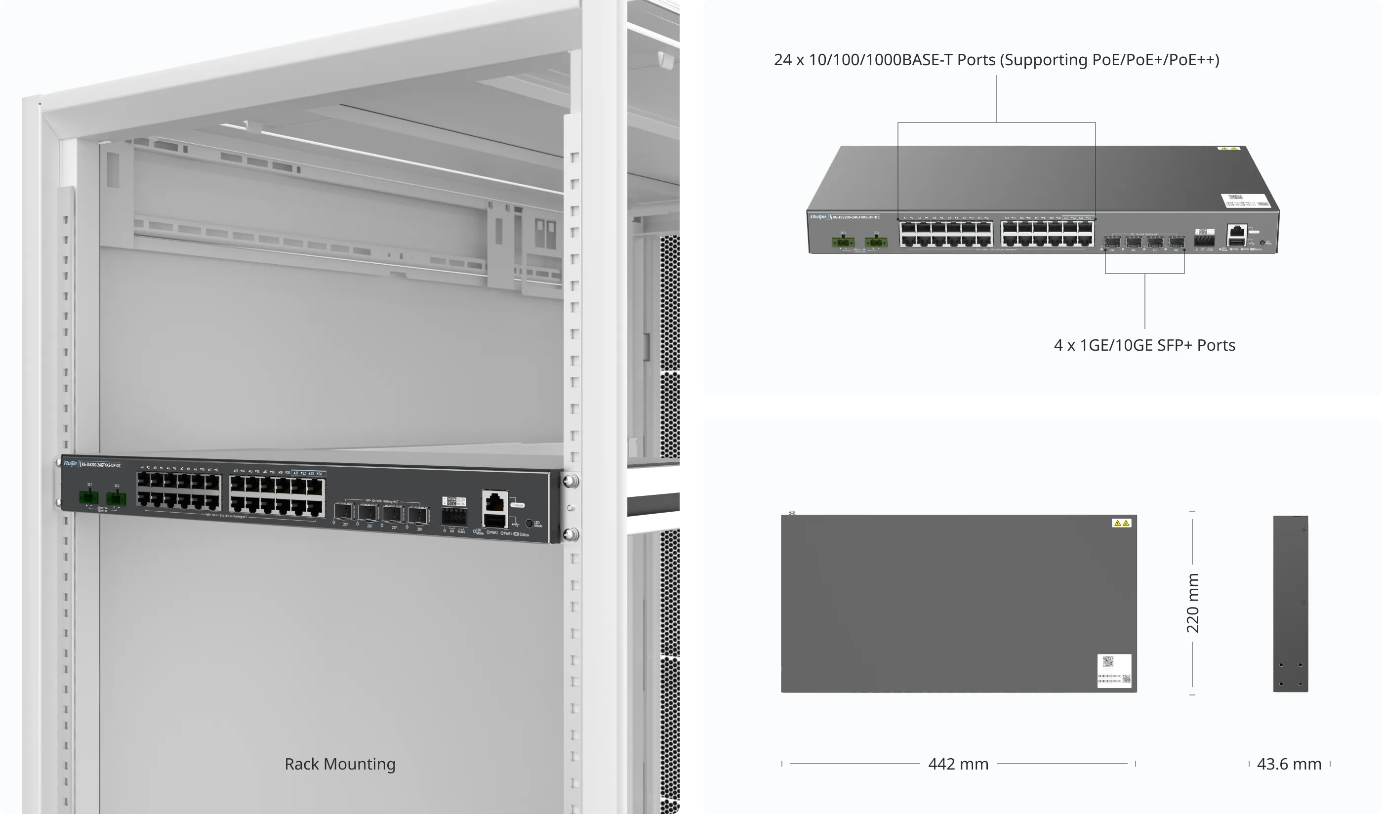

Unit dimensions (W x D x H)
150mm x 133mm x 86mm
442mm x 220mm x 43.6mm

installation method
Desktop mounting, DIN rail mounting, and wall mounting
Desktop mounting, rack mounting, and wall mounting
