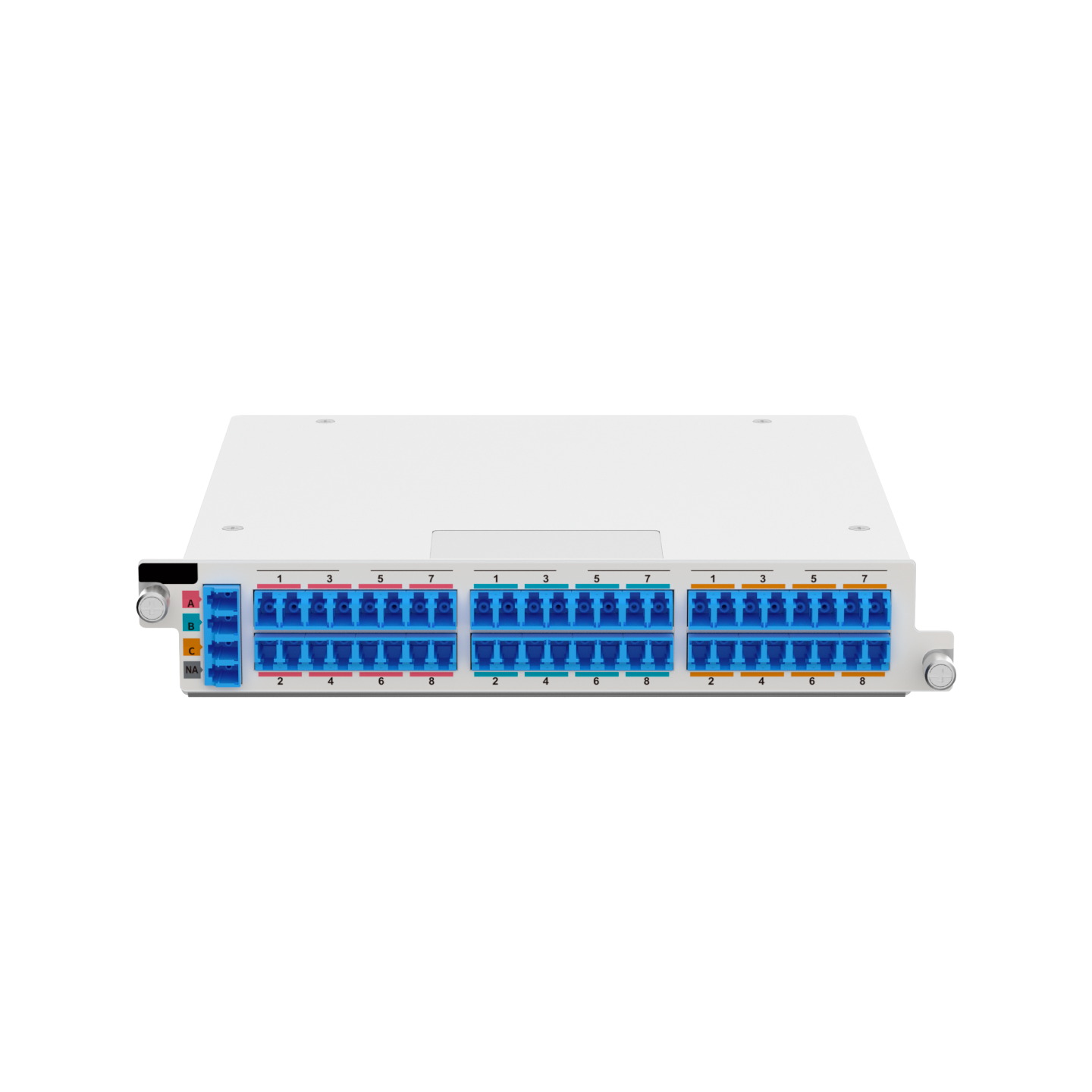

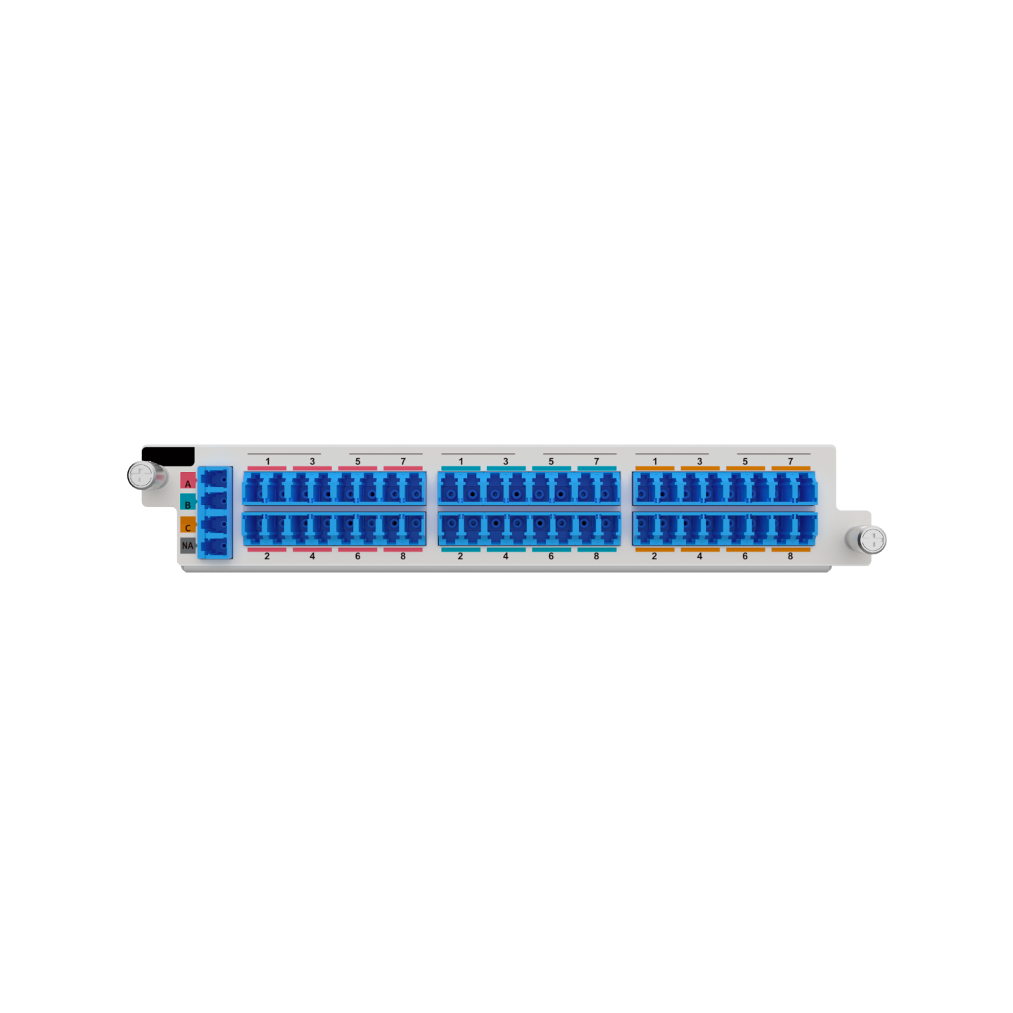

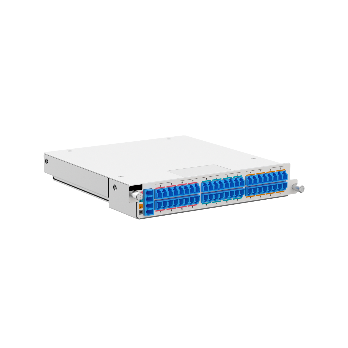

Expansion Module of RG-DEMUX Series 24-Port Core Combiner
Used in Simplified Optical Ethernet solution to make distribution nodes passive and provide exclusive Gigabit/10G bandwidth for Fiber-to-The-Room (FTTR)
Dòng
Tính năng nổi bật
  • The expansion module of the 24-port core combiner uses three WDM fibers for transmission, which effectively reduces trunk optical fibers required in buildings.
  • The unique colored optical technology is used to provide exclusive Gigabit/10G bandwidth for indoor use, which meets network requirements.
  • The all-optical network involves only passive devices, exempting ELV rooms from O&M management and making distribution nodes passive completely.
  • The modular expansion module is easy to fix and install.
RG-DEMUX/MUX Series 24-Port Combiner/Transparent Distribution Device
They are applied to enterprise-class all-optical network scenarios. The products innovatively combine the colored optical technology with passive devices using the Ethernet architecture to physically isolate channels of the device. They can be used together with Simplified Optical Ethernet solution 2.X to make distribution nodes passive completely and achieve 1G/10G bandwidth to the room.
