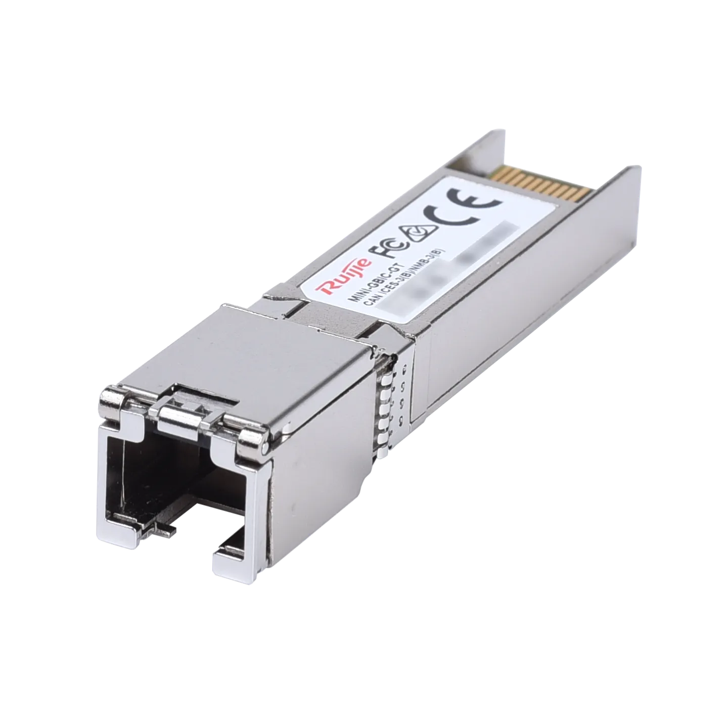

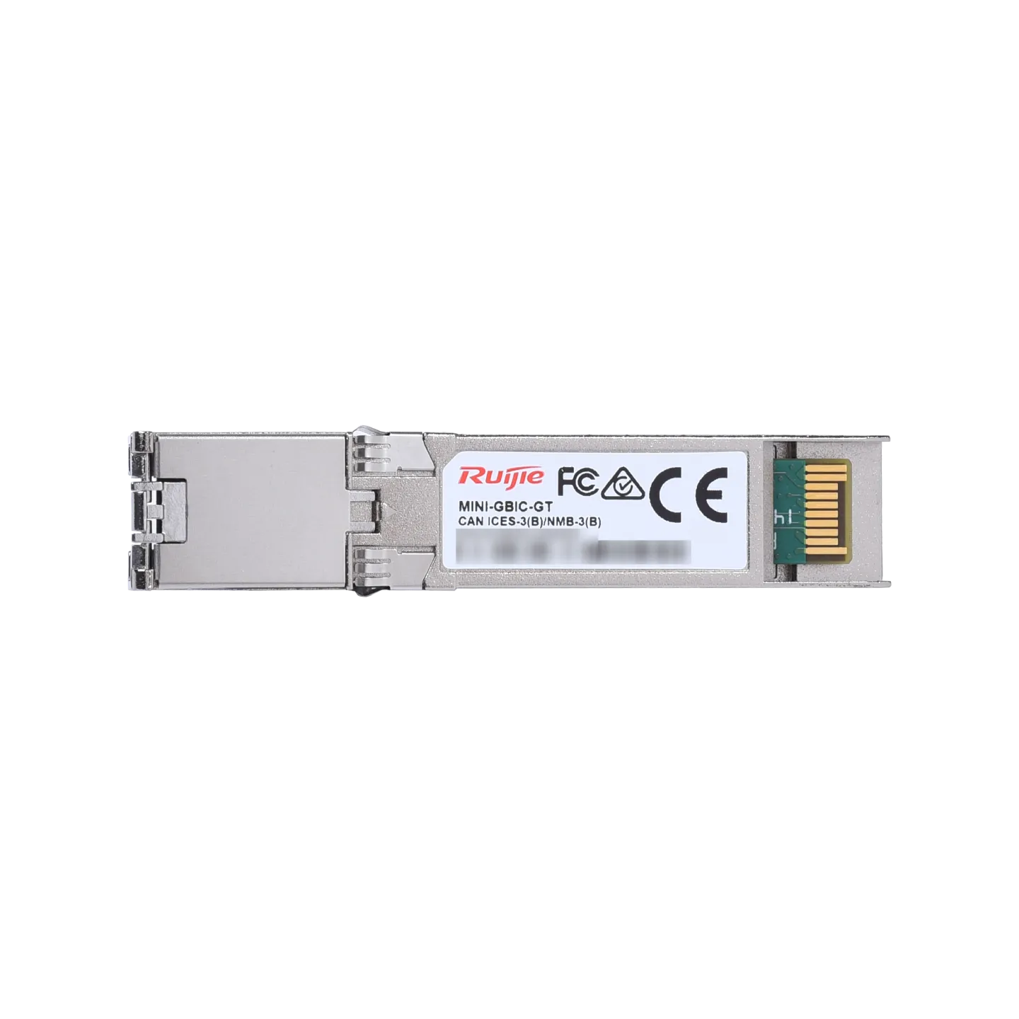

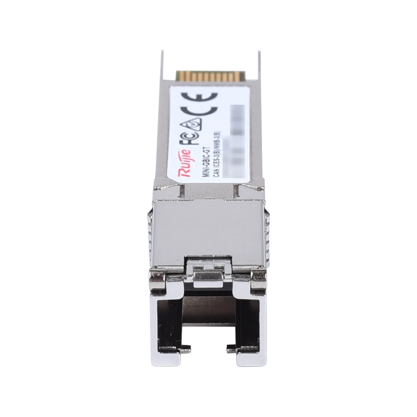

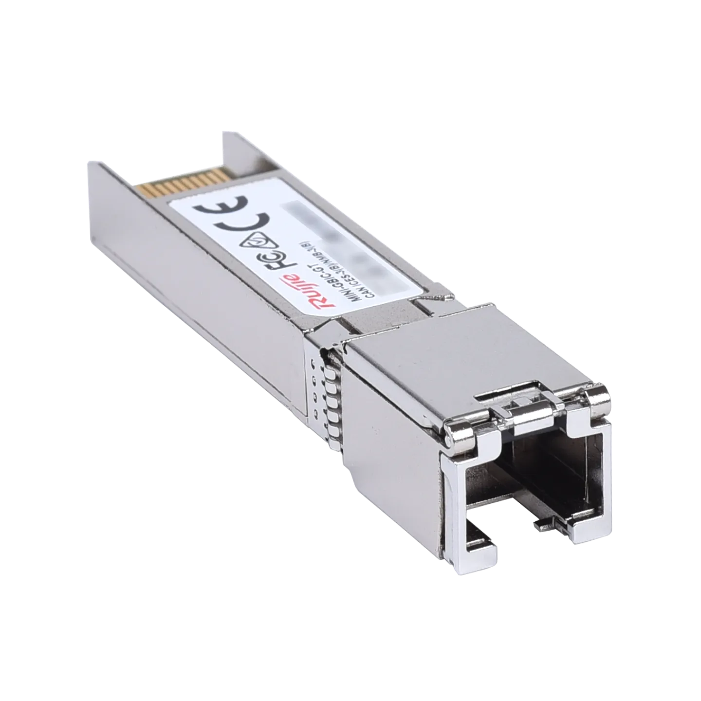

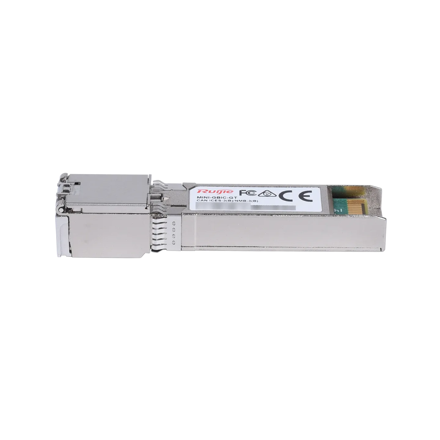

Mini-GBIC-GT 1000BASE-T SFP Copper RJ45 100-m Transceiver Module
Applicable to data center and campus networks, enabling cost-effective, efficient, and high-speed interconnection among switches, routers, servers, and network interface controllers (NICs)
Seri
Fitur Penting
  • High-speed data transmission of up to 1.25Gbps
  • Maximum transmission distance of up to 100 meters
  • Hot-pluggable feature allows for easy installation or removal without disrupting the network
  • Compatible with various networking equipment, making it a versatile choice for different setups
  • Conforming to IEEE 802.3ab, SFP+ MSA, and RoHS standards
Fitur
As an industry-leading ICT infrastructure and industry solution provider, Ruijie offers customers a wide variety of high-density and low-power 1G optical modules. They are applicable to data center and campus networks, enabling cost-effective, efficient, and high-speed interconnection among switches, routers, servers, and network interface controllers (NICs).
MINI-GBIC-GT Module
The MINI-GBIC-GT is an IEEE 1000base-X to 1000base-T media converter and supports a link length of up to 100 meters over a Cat 5e/6/6a cable with an RJ45 connector. It adopts the SFP form factor. The port needs to be conffgured with auto-negotiation. The transceiver conforms to IEEE 802.3ab, SFP+ MSA, and RoHS standards.
