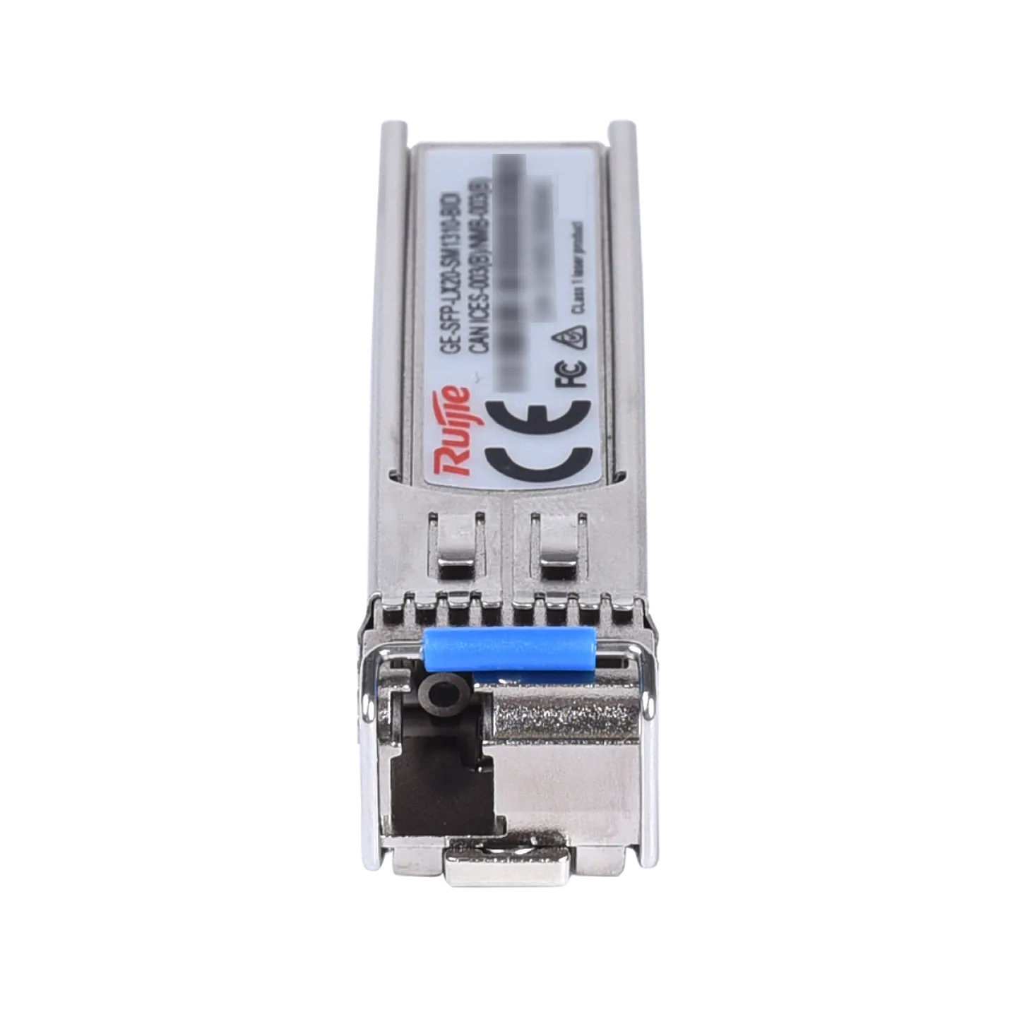

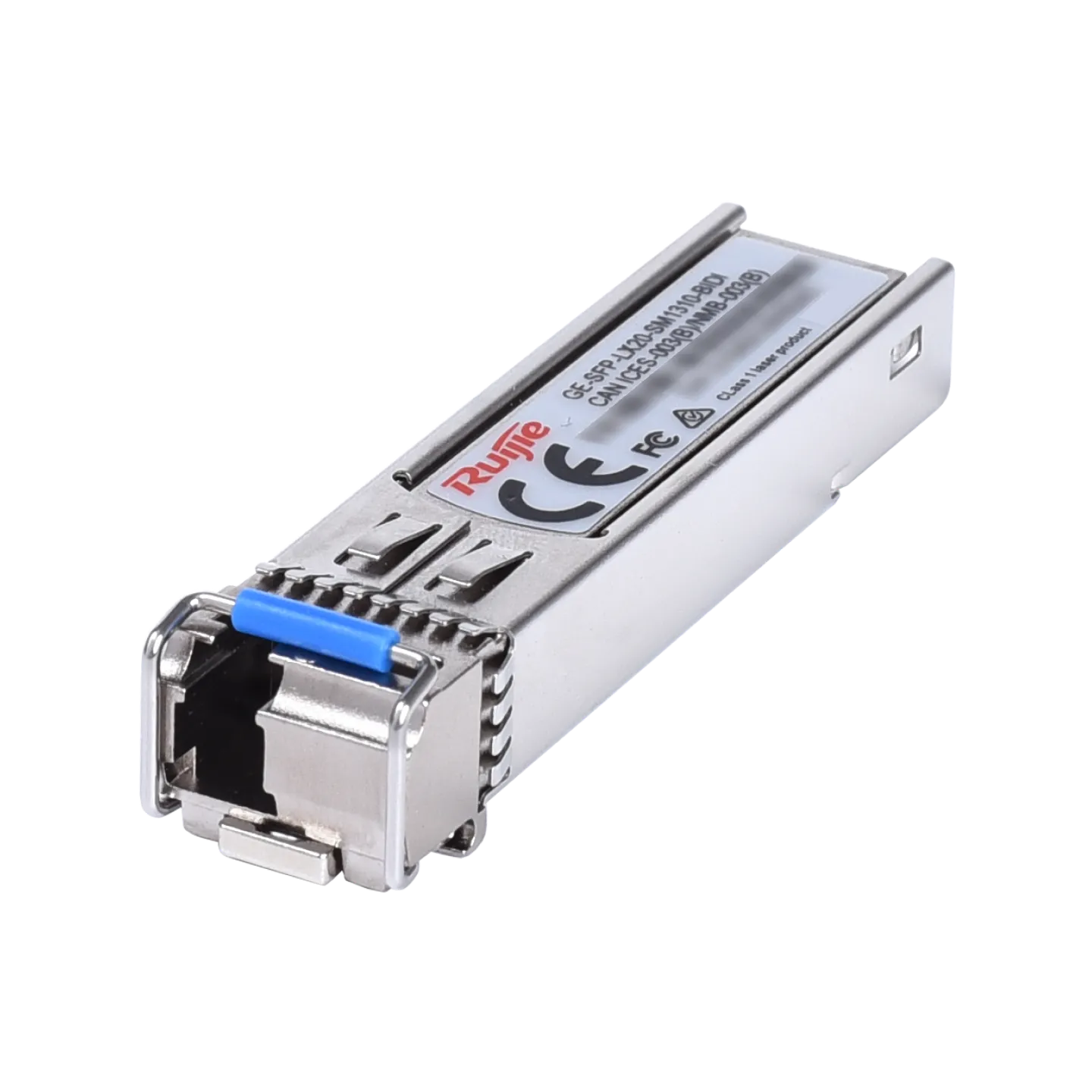

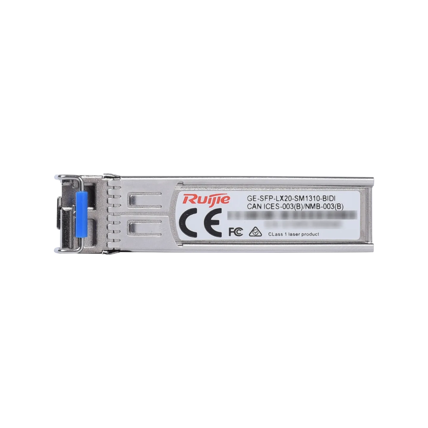

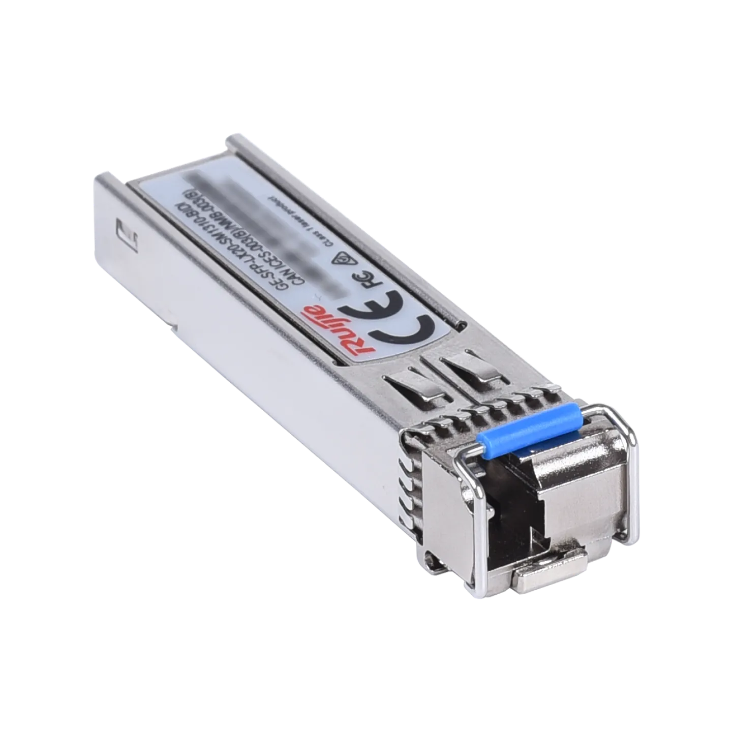

GE-SFP-LX20-SM1310-BIDI 1000BASE-LX SFP 1310nm-TX/1550nm-RX 20-km DDM Simplex LC SMF Transceiver Module
Applicable to data center and campus networks, enabling cost-effective, efficient, and high-speed interconnection among switches, routers, servers, and network interface controllers (NICs)
Seri
Fitur Penting
  • Max. power consumption 1.5 W
  • Saving half fiber by using only one fiber for transmiting and receiving
  • Hot pluggable SFP MSA compliant
  • Digital optical monitoring capability for strong diagnostic capabilities
  • Compliant with IEEE 802.3z Gigabit Ethernet
  • Class 1 Laser safety and RoHS compliant
Fitur
As an industry-leading ICT infrastructure and industry solution provider, Ruijie offers customers a wide variety of high-density and low-power 1G optical modules. They are applicable to data center and campus networks, enabling cost-effective, efficient, and high-speed interconnection among switches, routers, servers, and network interface controllers (NICs).
GE-SFP-LX20-SM1310-BIDI Module
The GE-SFP-LX20-SM1310-BIDI is aligned to IEEE 1000BASE-LX optical specifications and supports a link length of up to 20 kilometers over an SMF with a BIDI LC connector. It adopts the SFP form factor and operates at a wavelength of 1310 nm. The transceiver conforms to the IEEE 802.3, SFF-8472, SFF-8431, SFF-8432, SFP+ MSA, and RoHS standards.
