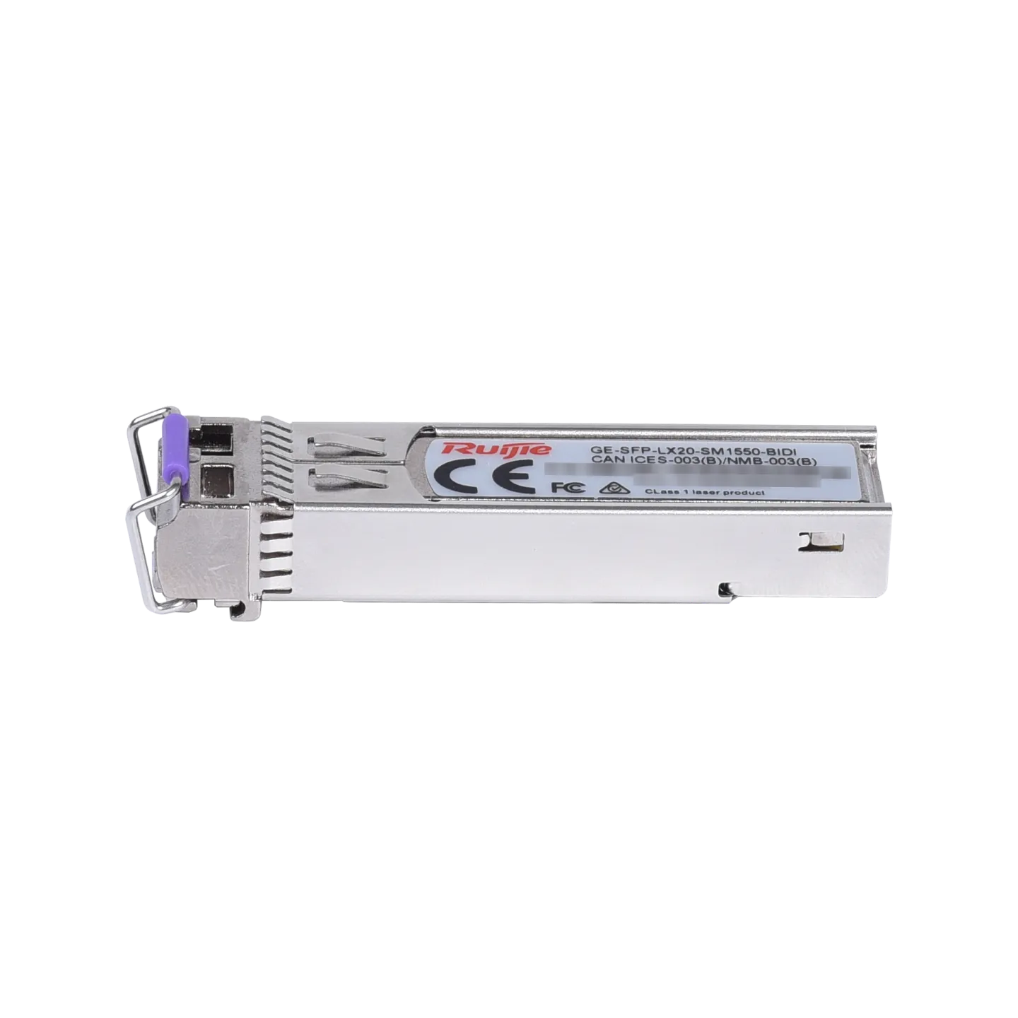

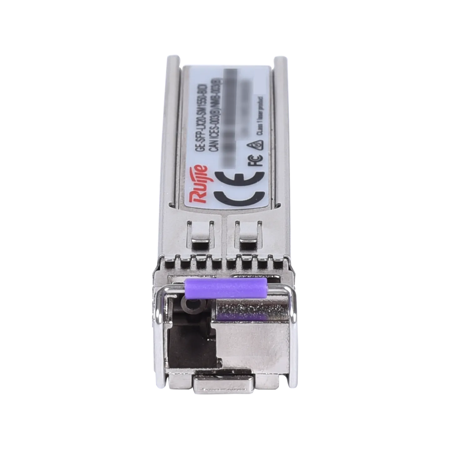

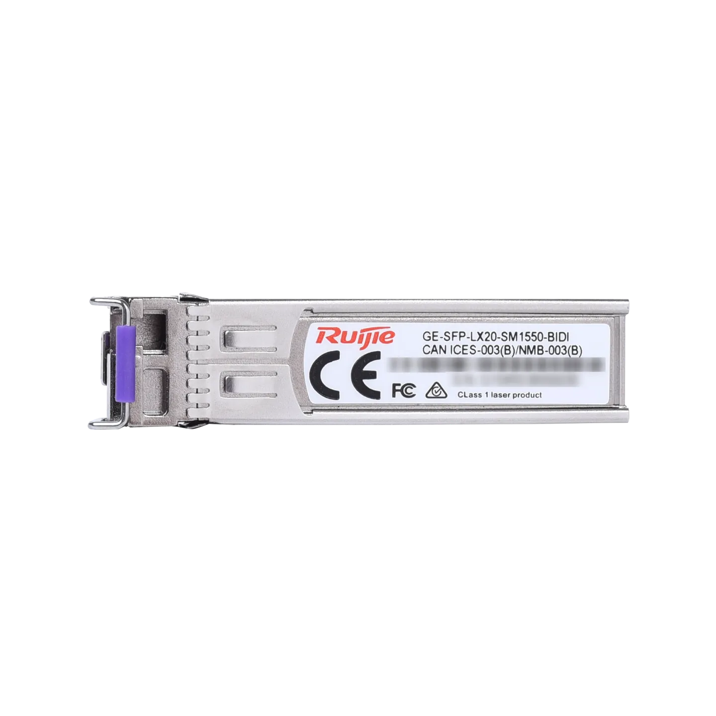

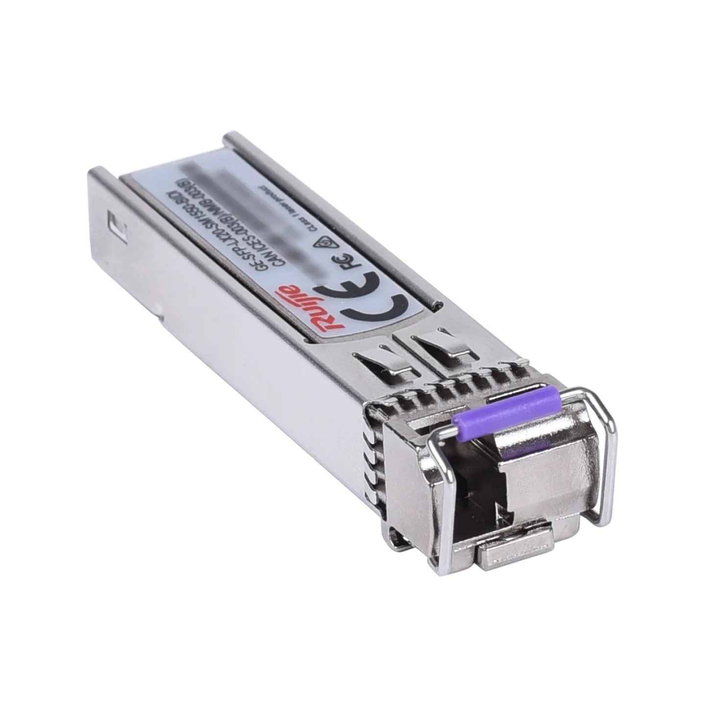

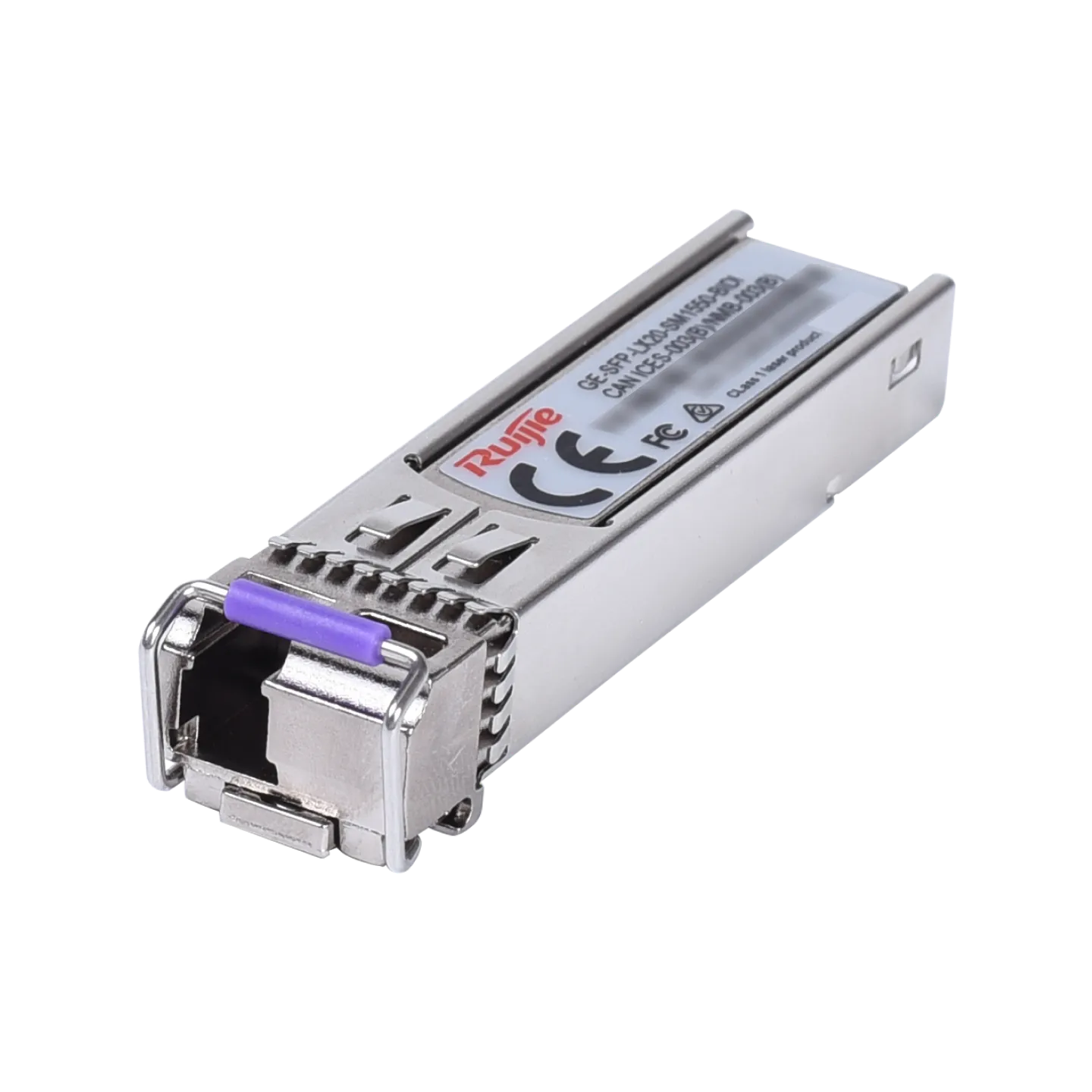

GE-SFP-LX20-SM1550-BIDI 1000BASE-LX SFP 1550nm-TX/1310nm-RX 20-km DDM Simplex LC SMF Transceiver Module
Applicable to data center and campus networks, enabling cost-effective, efficient, and high-speed interconnection among switches, routers, servers, and network interface controllers (NICs)
Seri
Fitur Penting
  • Max. power consumption 1.5 W
  • Saving half fiber by using only one fiber for transmiting and receiving
  • Hot pluggable SFP MSA compliant
  • Digital optical monitoring capability for strong diagnostic capabilities
  • Compliant with IEEE 802.3z Gigabit Ethernet
  • Class 1 Laser safety and RoHS compliant
Fitur
As an industry-leading ICT infrastructure and industry solution provider, Ruijie offers customers a wide variety of high-density and low-power 1G optical modules. They are applicable to data center and campus networks, enabling cost-effective, efficient, and high-speed interconnection among switches, routers, servers, and network interface controllers (NICs).
GE-SFP-LX20-SM1550-BIDI Module
The GE-SFP-LX20-SM1550-BIDI is aligned to IEEE 1000BASE-LX optical specifications and supports a link length of up to 20 kilometers over an SMF with a BIDI LC connector. It adopts the SFP form factor and operates at a wavelength of 1550 nm. The transceiver is compliant to IEEE 802.3, SFF-8472, SFF-8431, SFF-8432, SFP+ MSA, and RoHS standards.

Single-Fiber SFP Series Module (BIDI) Specifications
GE-SFP-LH40-SM1310-BIDI
GE-SFP-LH40-SM1550-BIDI
GE-SFP-LX20-SM1310-BIDI
GE-SFP-LX03-SM1310-BIDI-I
GE-SFP-LX03-SM1550-BIDI-I
Data rate
1.25 Gbps
Form factor
SFP
Connector type
BIDI LC
Cable type
SMF
Fiber end face finish type
Ultra Physical Contact (UPC)
Transmitter type
DFB
DFB
FP
DFB
FP
DFB
Receiver type
PIN
Reach
40 km (131,233.60 ft.)
20 km (65,616.80 ft.)
3 km (9,842.52 ft.)
Bit error ratio (BER)
1.00E-12
Data diagnosis-capable (DDM/DOM)
Yes
Power consumption
≤ 1.5 W
Transmitter Optical Parameters
Wavelength
1310 nm TX
1550 nm RX
1550 nm TX
1310 nm RX
1310 nm TX
1550 nm RX
1550 nm TX
1310 nm RX
1310 nm TX
1550 nm RX
1550 nm TX
1310 nm RX
Max. transmit power (AVG)
0 dBm
–3 dBm
Min. transmit power (AVG)
–5 dBm
–9 dBm
Min. extinction ratio
≥ 9 dB
Receiver Optical Parameters
Receive sensitivity (OMA)
< –23 dBm
< –20 dBm
< –22 dBm
Overload optical power (AVG)
–3 dBm
0°C to 70°C (32°F to 158°F)
Operating humidity
5% RH to 95% RH
Storage temperature
–40°C to +85°C (–40°F to +185°F)
Storage humidity
5% RH to 95% RH
Dimensions (W x D x H)
56.5 mm x 13.5 mm x 8.5mm (2.22 in. x 0.53 in. x 0.33 in.)
Weight
35 g (0.08 lbs.)
