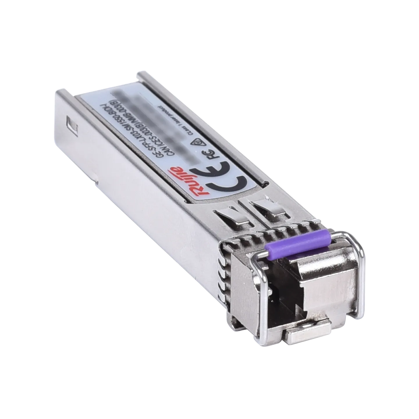

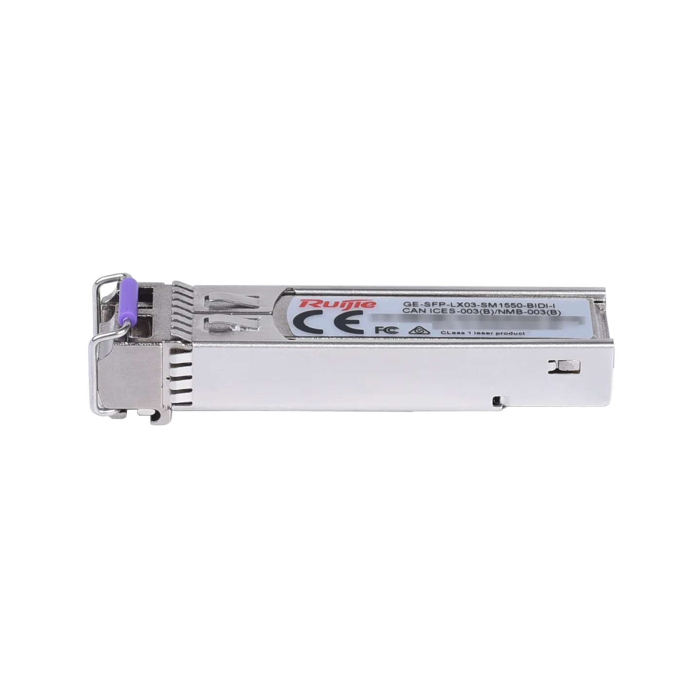

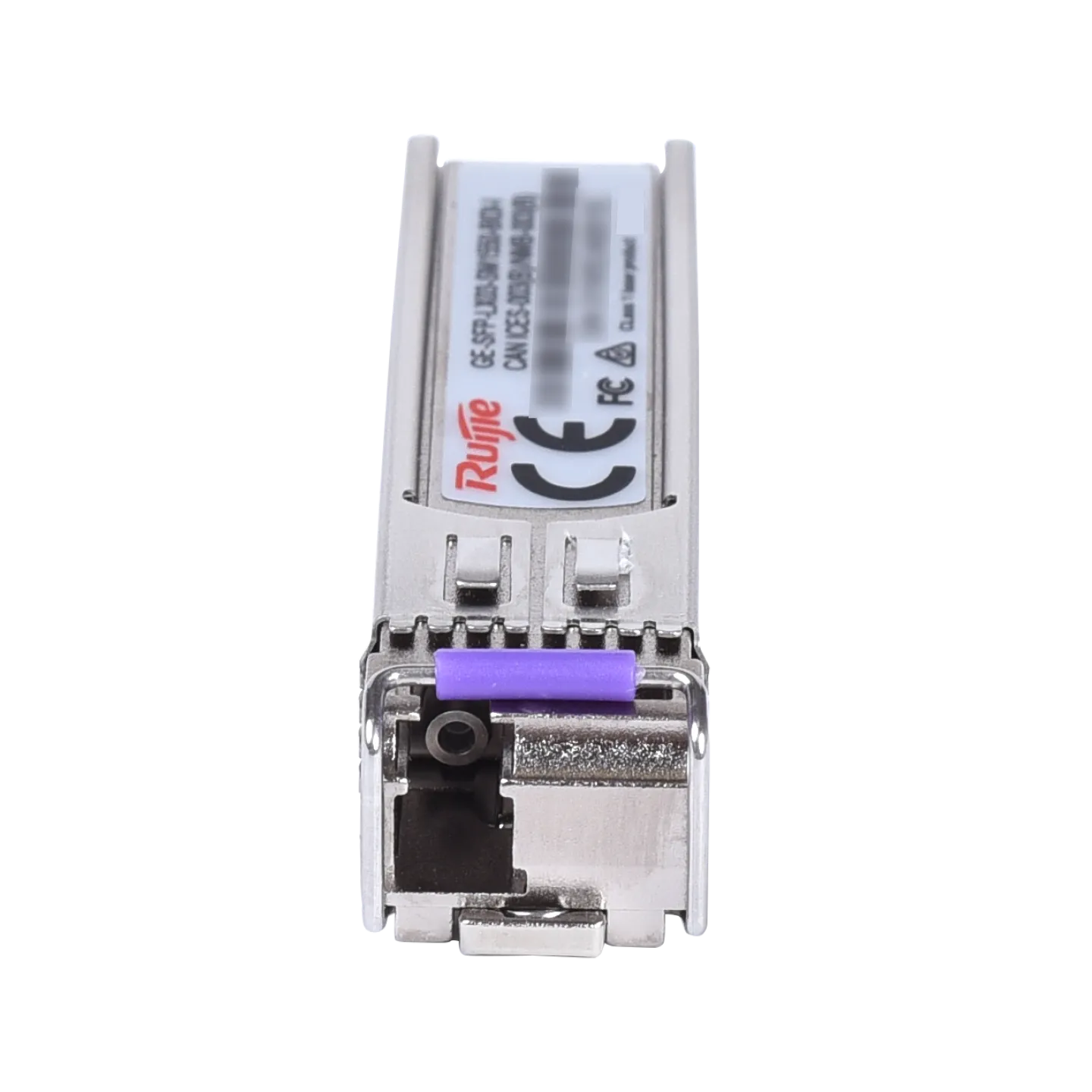

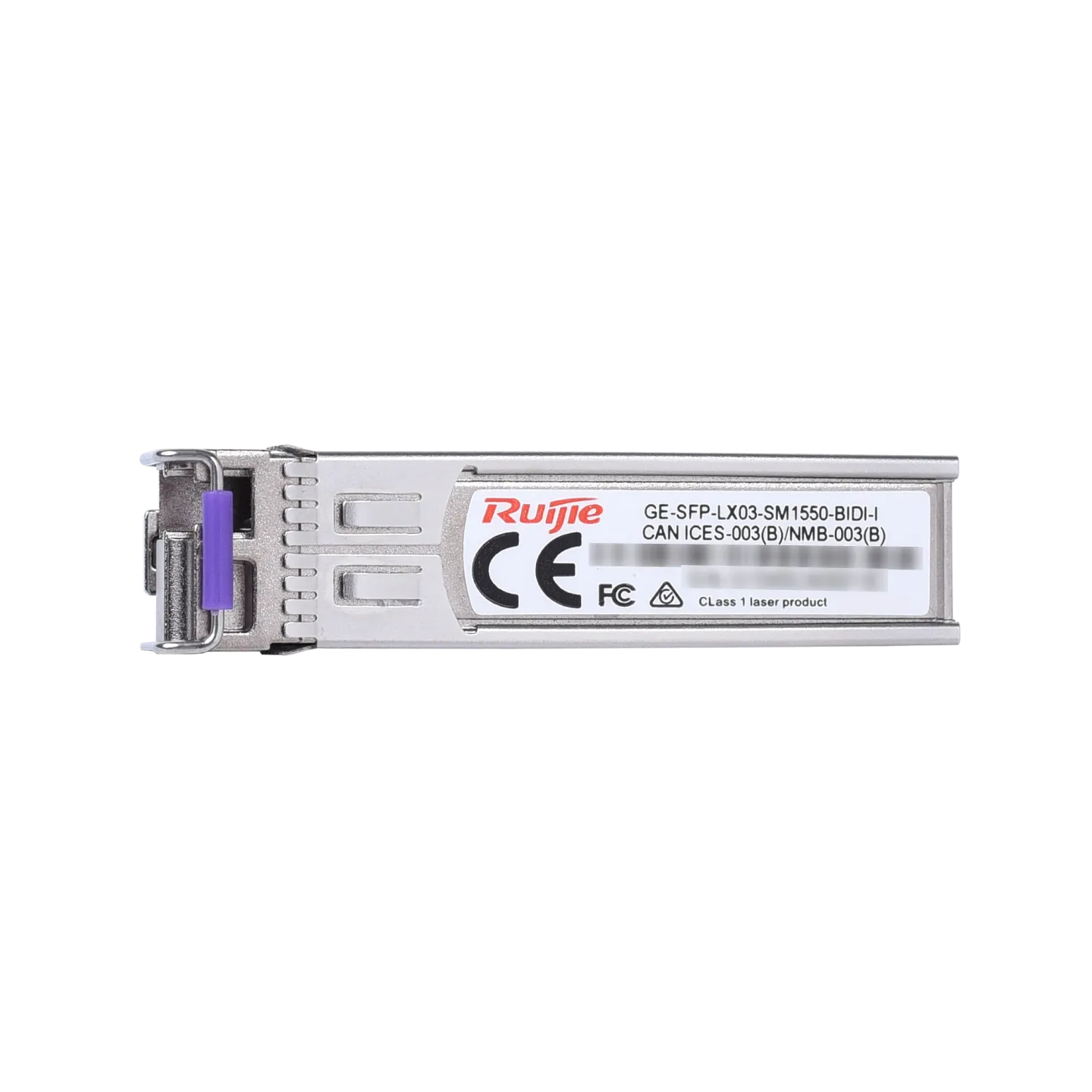

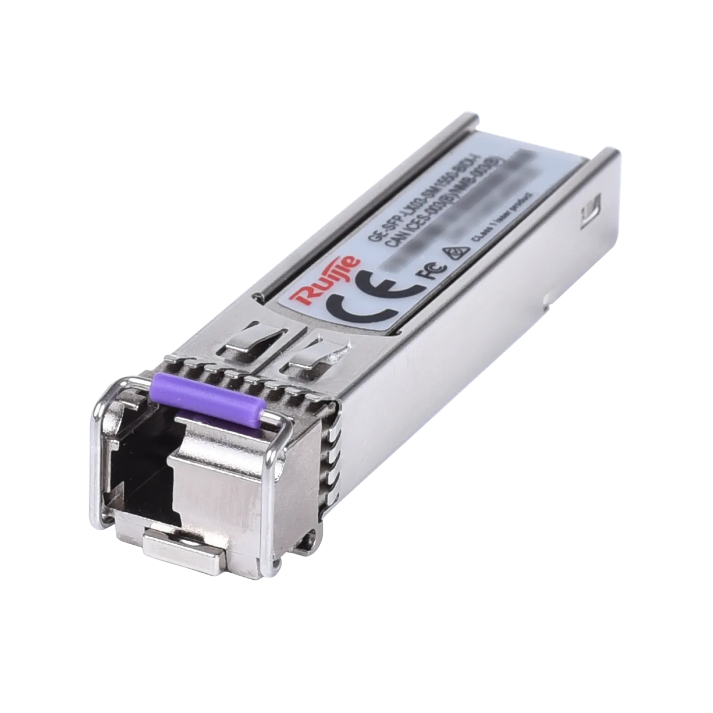

GE-SFP-LX03-SM1550-BIDI-I 1000BASE-LX SFP 1550nm-TX/1310nm-RX 3-km DDM Simplex LC SMF Transceiver Module
Applicable to data center and campus networks, enabling cost-effective, efficient, and high-speed interconnection among switches, routers, servers, and network interface controllers (NICs)
Seri
Fitur Penting
  • Max. power consumption 1.5 W
  • Saving half fiber by using only one fiber for transmiting and receiving
  • Hot pluggable SFP MSA compliant
  • Digital optical monitoring capability for strong diagnostic capabilities
  • Compliant with IEEE 802.3z Gigabit Ethernet
  • Class 1 Laser safety and RoHS compliant
Fitur
As an industry-leading ICT infrastructure and industry solution provider, Ruijie offers customers a wide variety of high-density and low-power 1G optical modules. They are applicable to data center and campus networks, enabling cost-effective, efficient, and high-speed interconnection among switches, routers, servers, and network interface controllers (NICs).
GE-SFP-LX03-SM1550-BIDI-I Module
The GE-SFP-LX03-SM1550-BIDI-I is aligned to IEEE 1000BASE-LX optical specifications and supports a link length of up to 3 kilometers over an SMF with a BIDI LC connector. It adopts the SFP form factor and operates at a wavelength of 1550 nm. The transceiver conforms to IEEE 802.3, SFF-8472, SFF-8431, SFF-8432, SFP+ MSA, and RoHS standards.
