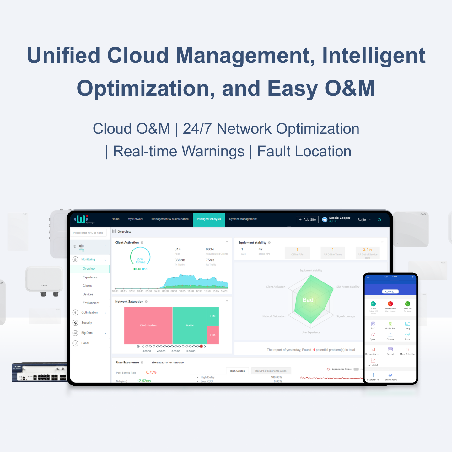

Unified Cloud Management
Intelligent Optimization, and Easy O&M
The WIS cloud network configuration and optimization can be completed without onsite operations.You can use Wi-Fi Moho for easier O&M.
With early warning of network failures, wireless networks can be monitored anytime and anywhere
Go to WIS cloud network >
Cloud O&M
24/7 Network Optimization
Real-time Warnings
Fault Location

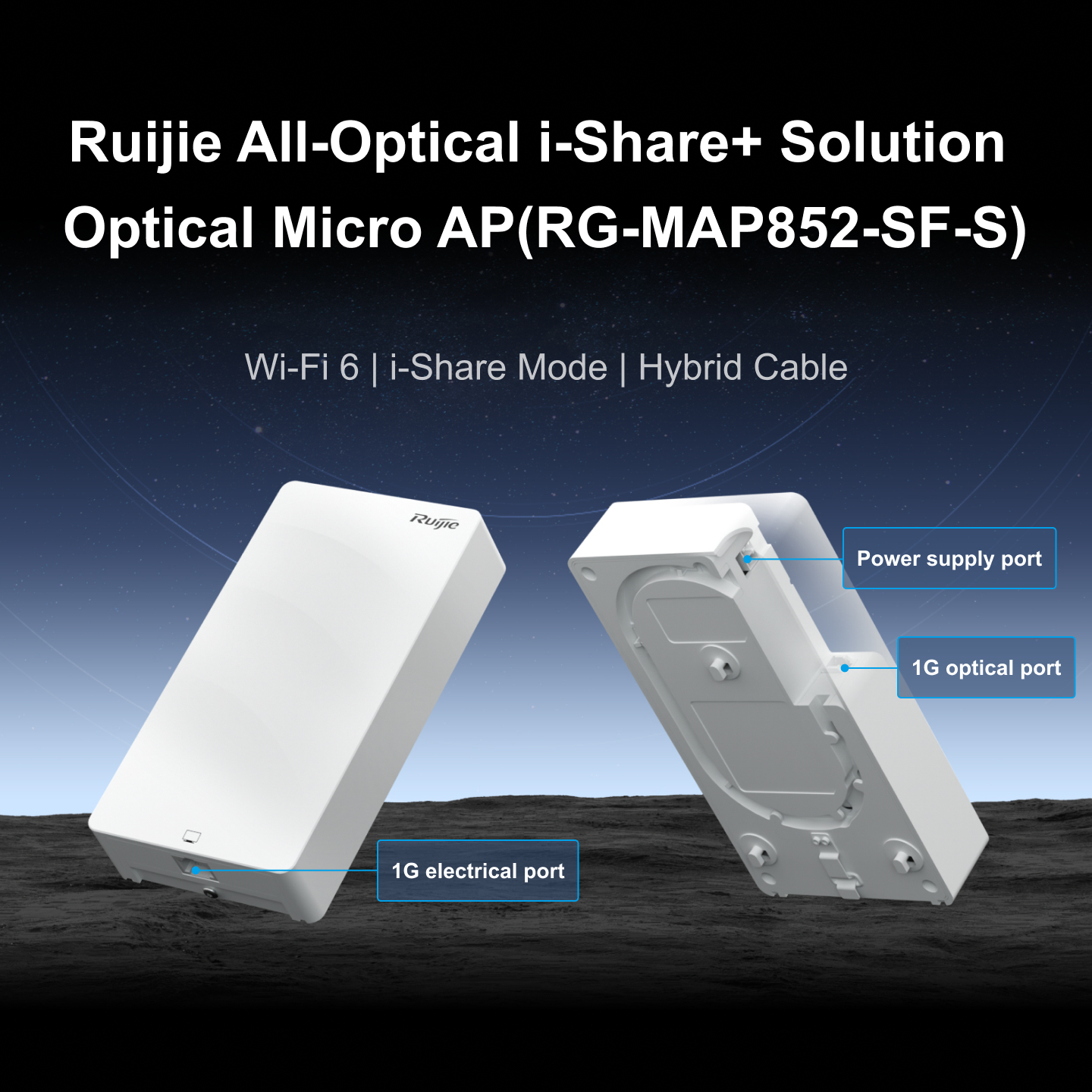

Fixed service port
Uplink: 1 x 1000Base-X LC port
Downlink: 1 x 10/100/1000Base-T adaptive Ethernet electrical port

When the AP works in cloud mode, it can be managed through Ruijie Cloud.

RG-MAP852-SF-S
Wi-Fi 6 dual-radio wall plate micro AP for Ruijie O-Share Solution
1 × SFP port
1 ×10/100/1000Base-T Ethernet port with auto-negotiation
2.4 GHz and 5 GHz frequency bands
A wireless data rate of up to 1.775 Gbps per device
BOB structure
One 1G optical module of the master AP
