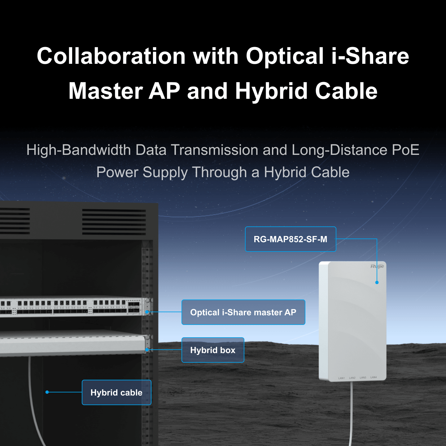

RG-MAP852-SF-M works with the optical i-Share master AP to realize high-bandwidth data transmission and long-distance PoE power supply through a hybrid cable, integrating wired and wireless coverage.

P2P Power Supply Through a Hybrid Cable

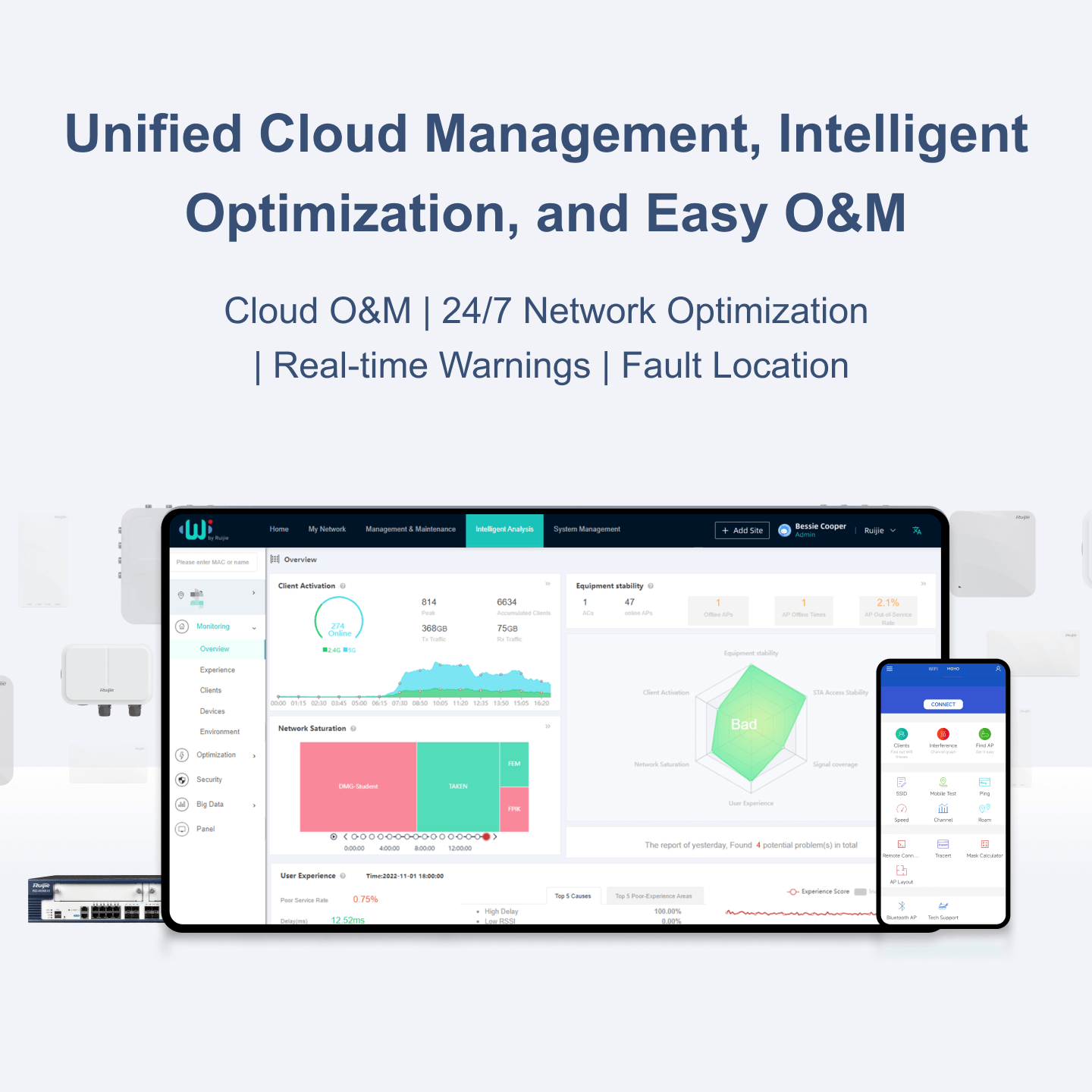

Unified Cloud Management
Intelligent Optimization, and Easy O&M
The WIS cloud network configuration and optimization can be completed without onsite operations.You can use Wi-Fi Moho for easier O&M.
With early warning of network failures, wireless networks can be monitored anytime and anywhere
Go to WIS cloud network >
Cloud O&M
24/7 Network Optimization
Real-time Warnings
Fault Location
