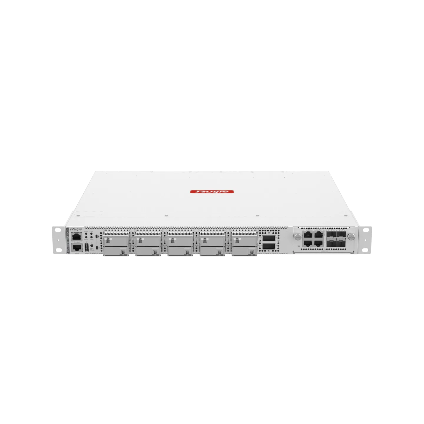

RG-S7610-10SFX2CQ 1 U Ultra High-Density CWDM Fixed Core Switch
Designed for all-optical scenarios, this series adopts CWDM technology and integrates a combiner, reducing core port usage and simplifying deployment.
Dòng
Tính năng nổi bật

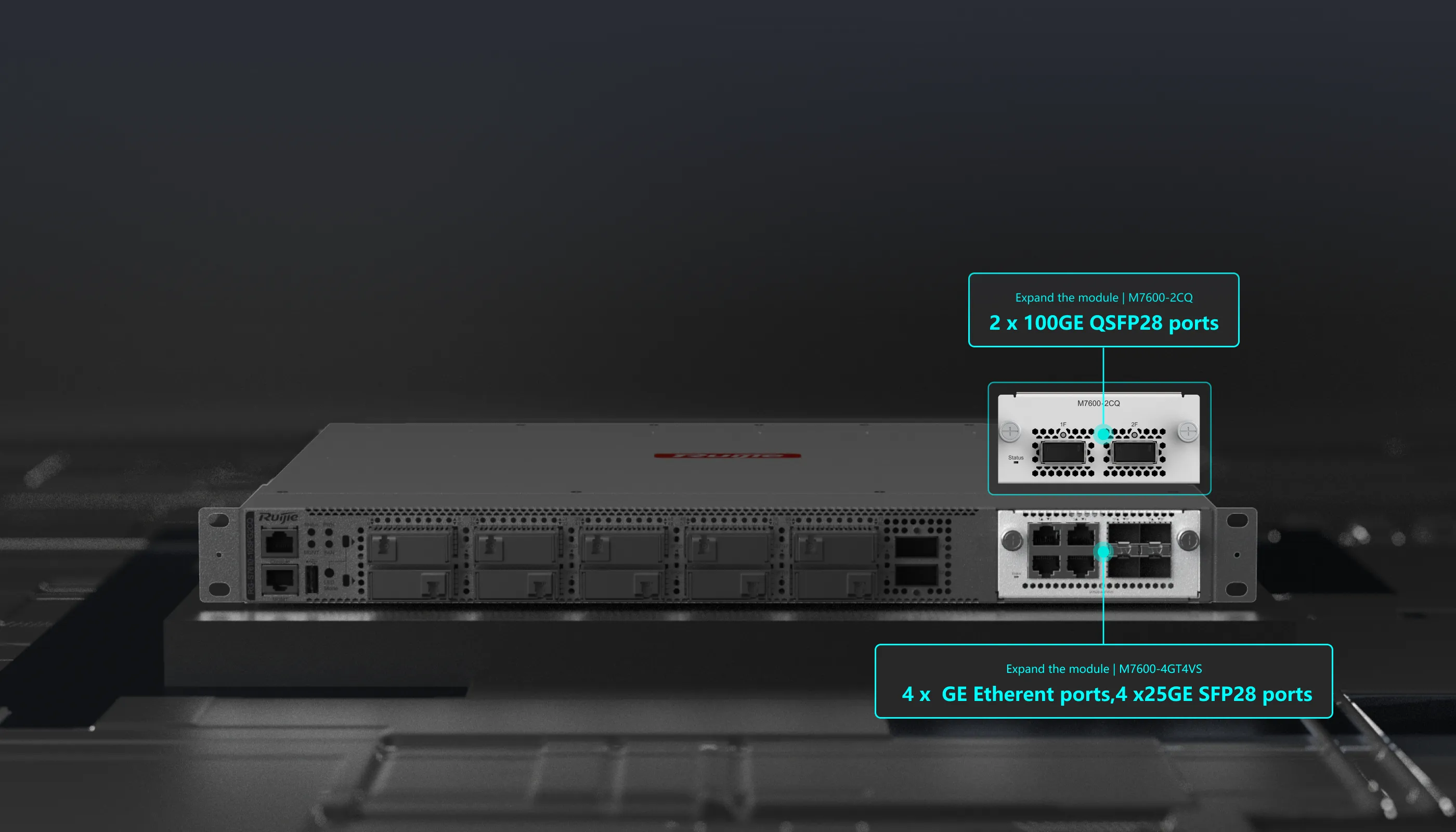

  • Ten SFX ports (equivalent to 80 SFP+ channels) and two 100GE uplink ports, backward compatible with 40GE, and allowing flexible configuration
  • Integrated traditional fixed switch and combiner functions and simplified management and deployment
  • Multi-level hardware protection, ensuring continuous device operation and stable network connectivity

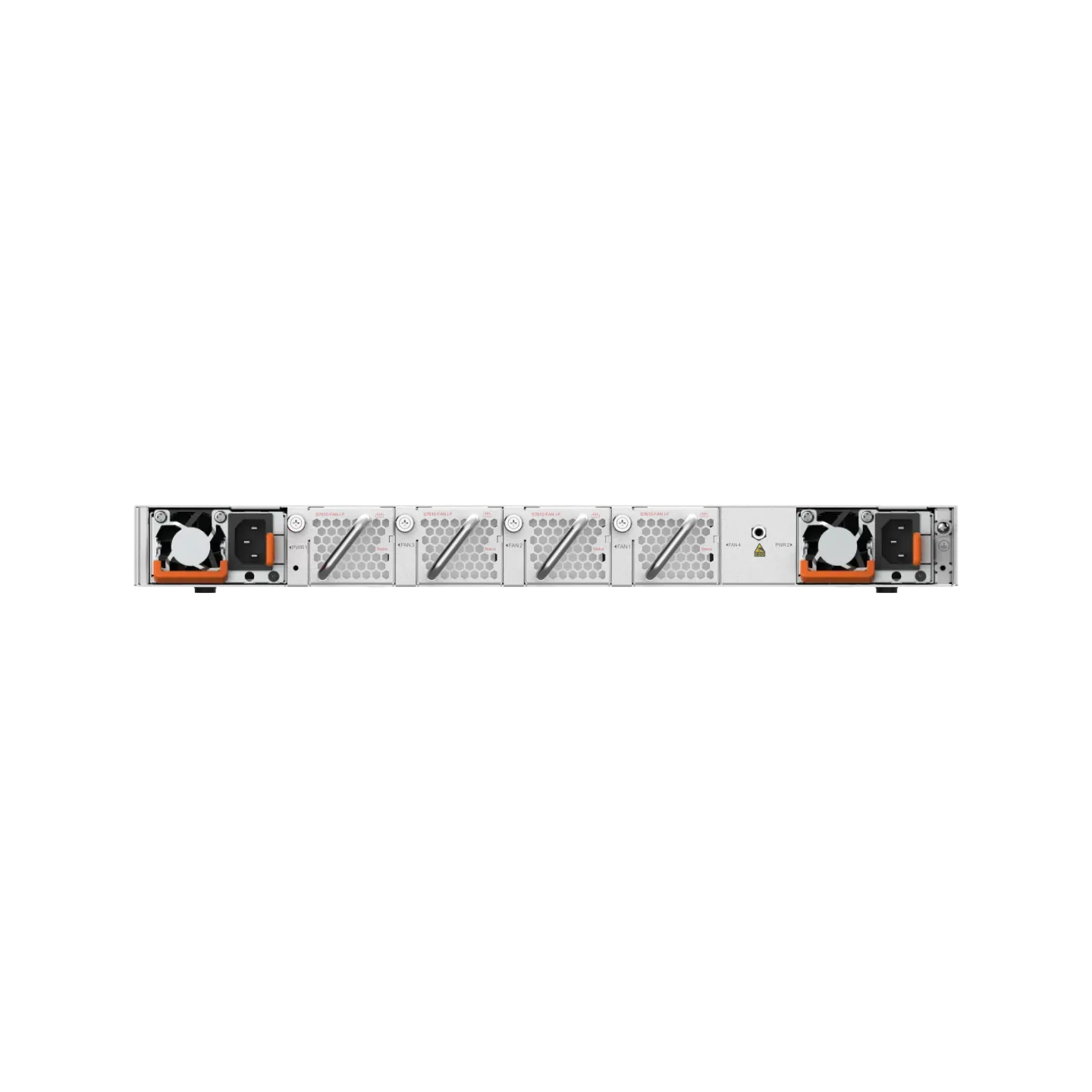

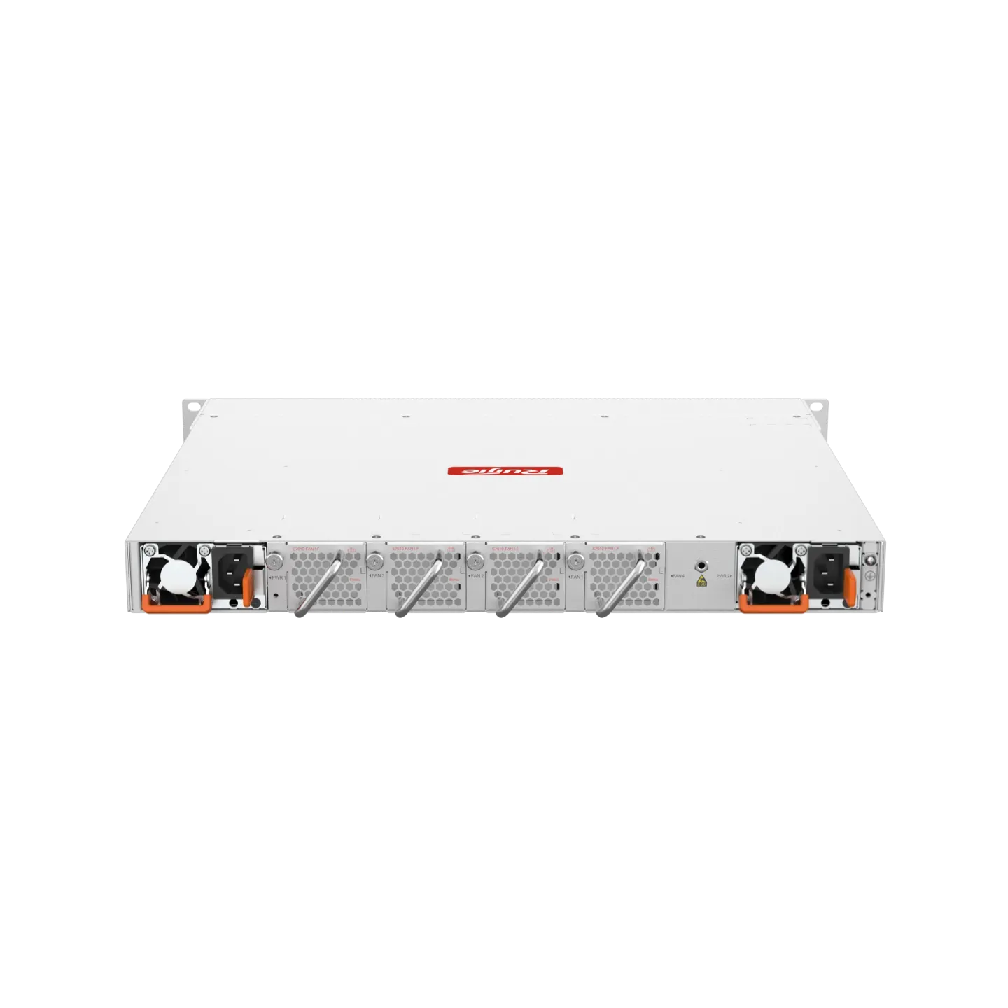

Hot-swappable Redundant Power
Hot-swappable Redundant Fan
Supply 1+1 power supply redundancy, allowing for second-level failover and providing extra protection for network links

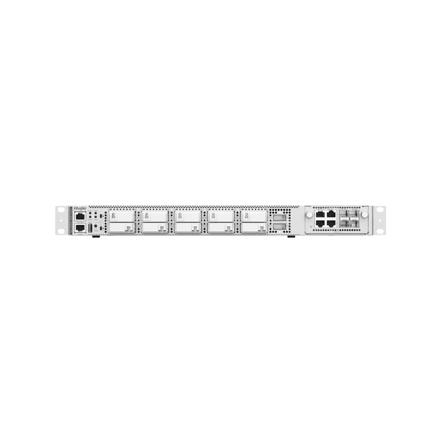

Fixed service port
10 x SFG ports (80 x 1GE logical channels)
2 x 40GE/100GE QSFP28 ports (supporting 4 x 10GE/4 x 25GE)
10 x SFX ports (80 x 10GE logical channels)

1 x expansion module slot
2 x power module slots
3 x fan module slots
Expansion module
M7600-2CQ
M7600-4GT4VS
Power module
RG-PA550I II-F
Fan module
S7610-FAN I-F
S7620-FAN I-F
Fixed management port
1 x RJ45 console port
1 x RJ45 MGMT port
USB
1 x USB 2.0 port
