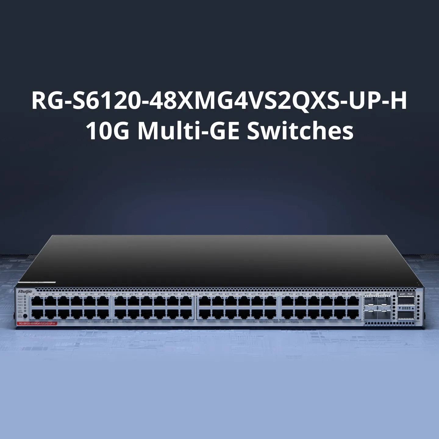

RG-S6120-48XMG4VS2QXS-UP-H 10G Multi-GE Switches
48 x 100/1000/2.5G/5G/10GBASE-T ports and 4 x 25GE and 2 x 40GE uplink ports are provided to realize flexible networking.
High-power PoE++ is provided and a maximum of 90 W PoE power supply meets different end-use needs.

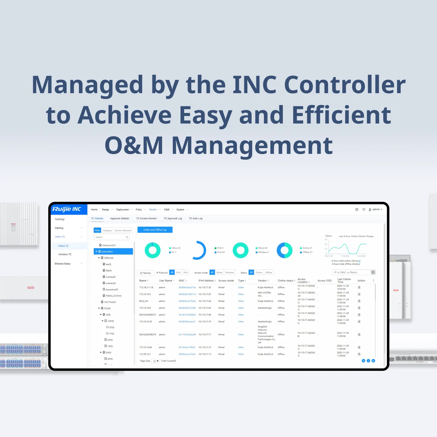

The switch automatically completes registration and configuration after it accesses the all-optical network, achieving plug and play, no commissioning and fast onboarding.
You can check the link health status, handle alarms and troubleshoot faults through the INC, which dramatically improves the O&M efficiency.
A switch can be flexibly replaced based on service needs without reconfiguration. Service ports supports auto-sensing, achieving automatic O&M.
