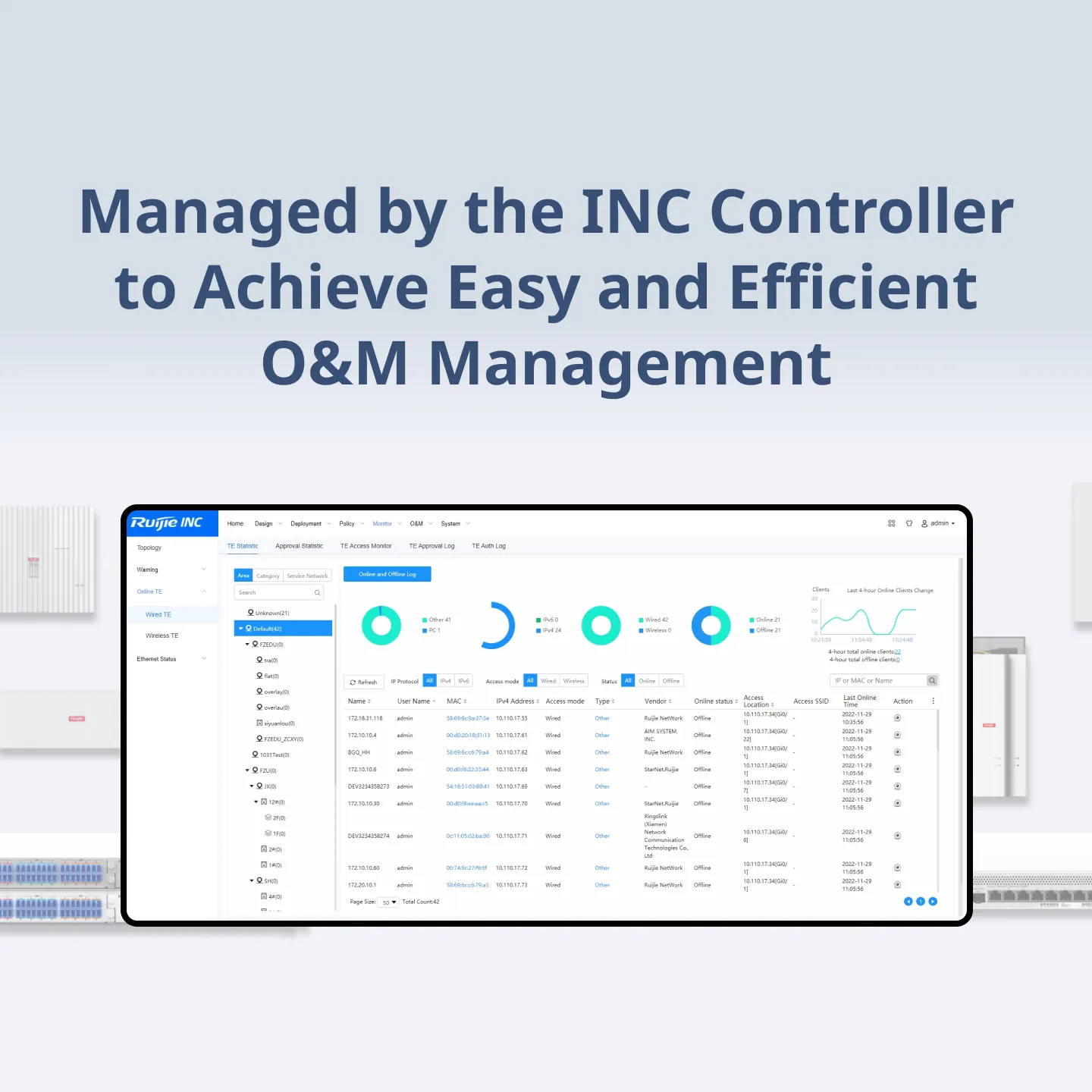

The switch automatically completes registration and configuration after it accesses the all-optical network, achieving plug and play, no commissioning and fast onboarding.
You can check the link health status, handle alarms and troubleshoot faults through the INC, which dramatically improves the O&M efficiency.
A switch can be flexibly replaced based on service needs without reconfiguration. Service ports supports auto-sensing, achieving automatic O&M.

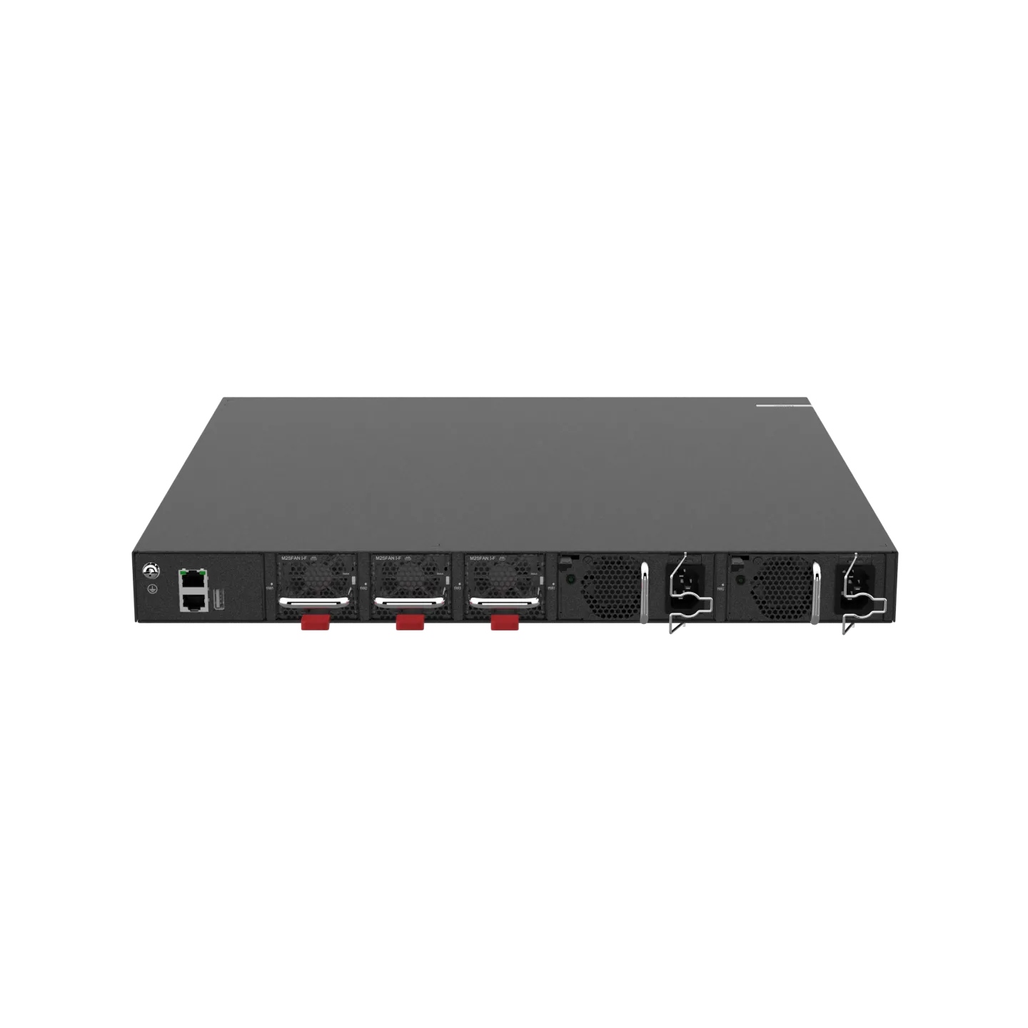

Module slot
Not Supported
2 x power module slots
3 x fan module slots
Power module
Not Supported
RG-PA600I-P-F
RG-PA1000I-P-F
Fan module
Not Supported
M2SFAN I-F (pre-installed 3)
