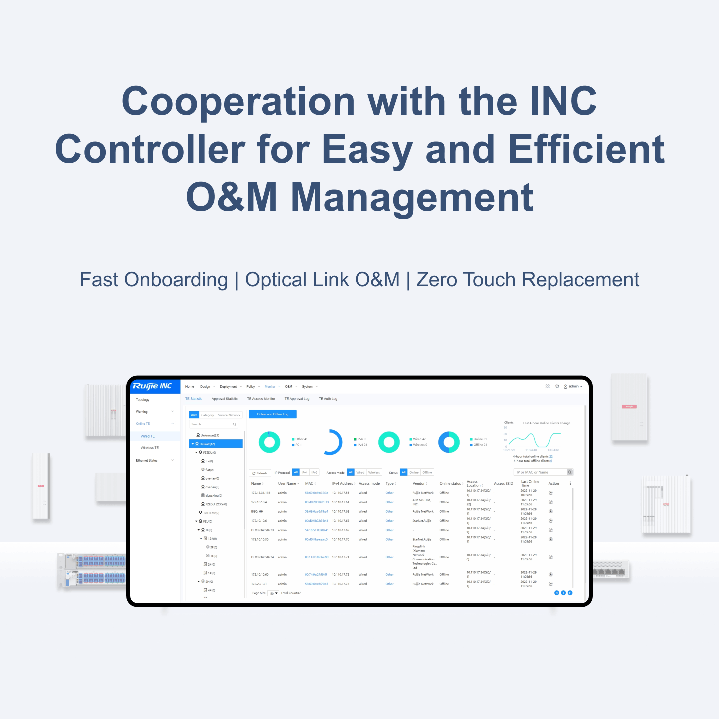

The switch automatically completes registration and
configuration after it accesses the all-optical network, achieving
plug and play, no commissioning and fast onboarding.
A switch can be flexibly replaced based on service needs
without reconfiguration. Service ports supports auto-sensing,
achieving automatic O&M.
Fast Onboarding
Zero Touch Replacement
