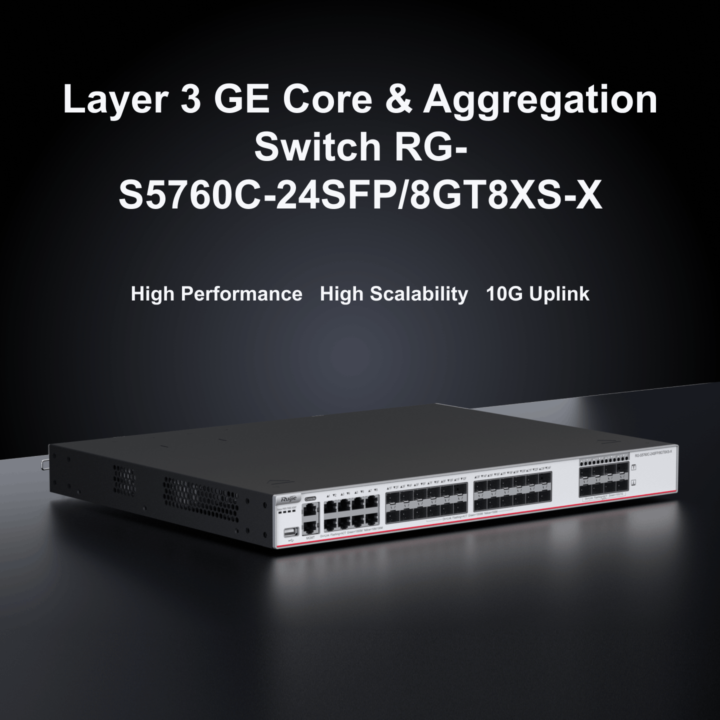

RG-S5760C-24SFP/8GT8XS-X 24-Port Layer 3 Enterprise-Class Core or Aggregation Switch (with Eight Combo Ports), 8-Port 10GE Uplink
Aggregation switch for large-sized networks, or core switch for small and medium-sized networks
Dòng
Tính năng nổi bật
  • Rich port types, 24 x 1GE SFP ports for access, and 8 x 1GE/10GE SFP+ ports for uplink
  • Hardware redundancy, guaranteed service continuity and network connectivity
  • Layer 3 routing control, adaptive to multiple services, efficient and guaranteed data transmission
  • Network security policies, real-time monitoring, CPP and NFPP, delivering enhanced network robustness
  • SNMP, RMON, Syslog, USB log backup features, CLI, Eweb, telnet and other management modes, easy network maintenance

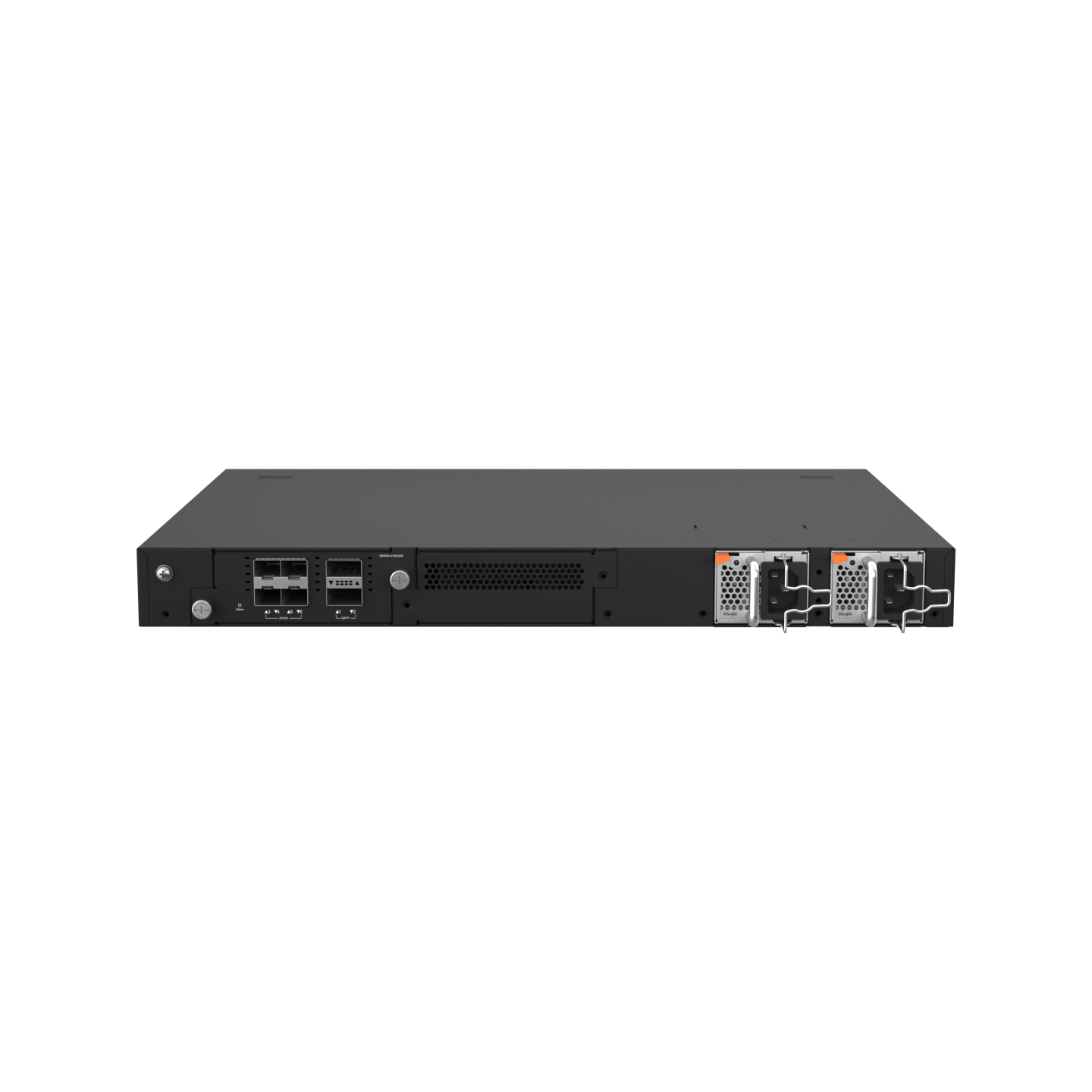

Module slot
1 x expansion module slot
2 x power module slots
3 x fan module slots
2 x fan module slots
Expansion module
M5000X-4XS2CQ
Note: The V1.X switch needs to be upgraded to version 12.5(4)B0701 or later to support the expansion module.
Power module
RG-PA150IB-F
RG-PD150IB-F
RG-PA150IB-F
RG-PD150IB-F
RG-PA150IB-F
RG-PD150IB-F
RG-PA150IB-F
RG-PD150IB-F
RG-PA600I-P-F
RG-PA1000I-P-F
