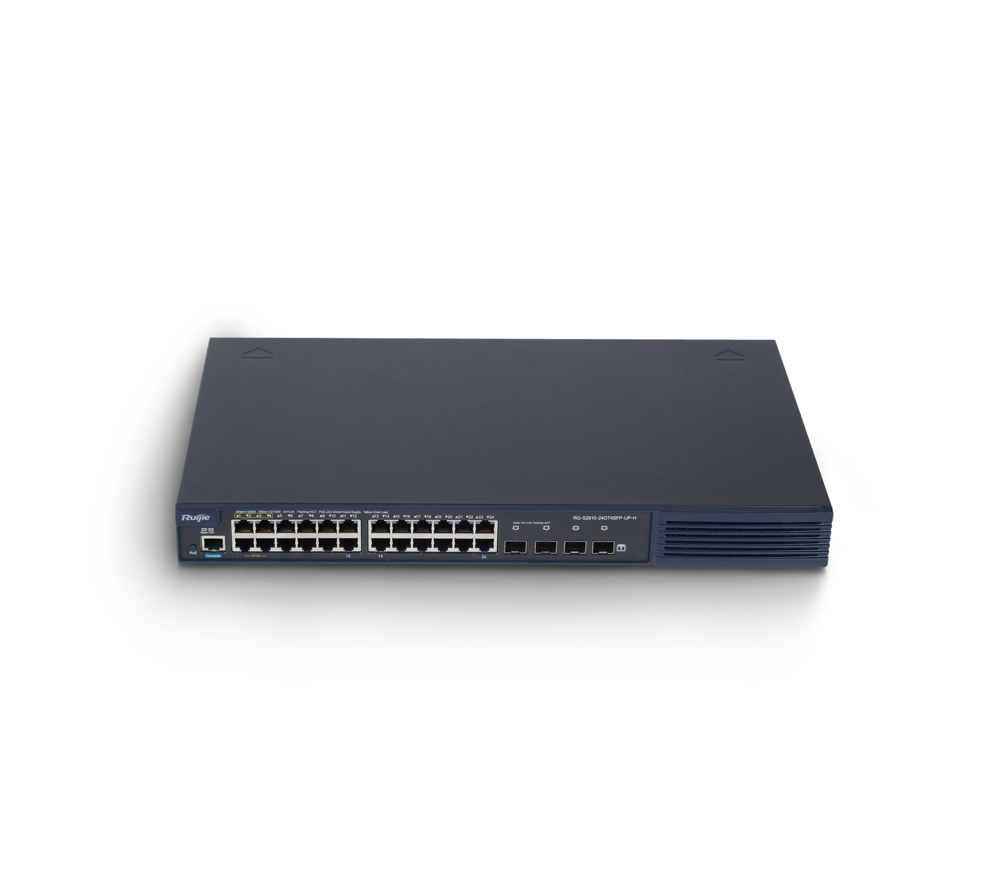

RG-S2910-24GT4XS-UP-H, 24-Port Gigabit L2+ Managed PoE Switch with SFP+

RG-S2910-24GT4SFP-UP-H
