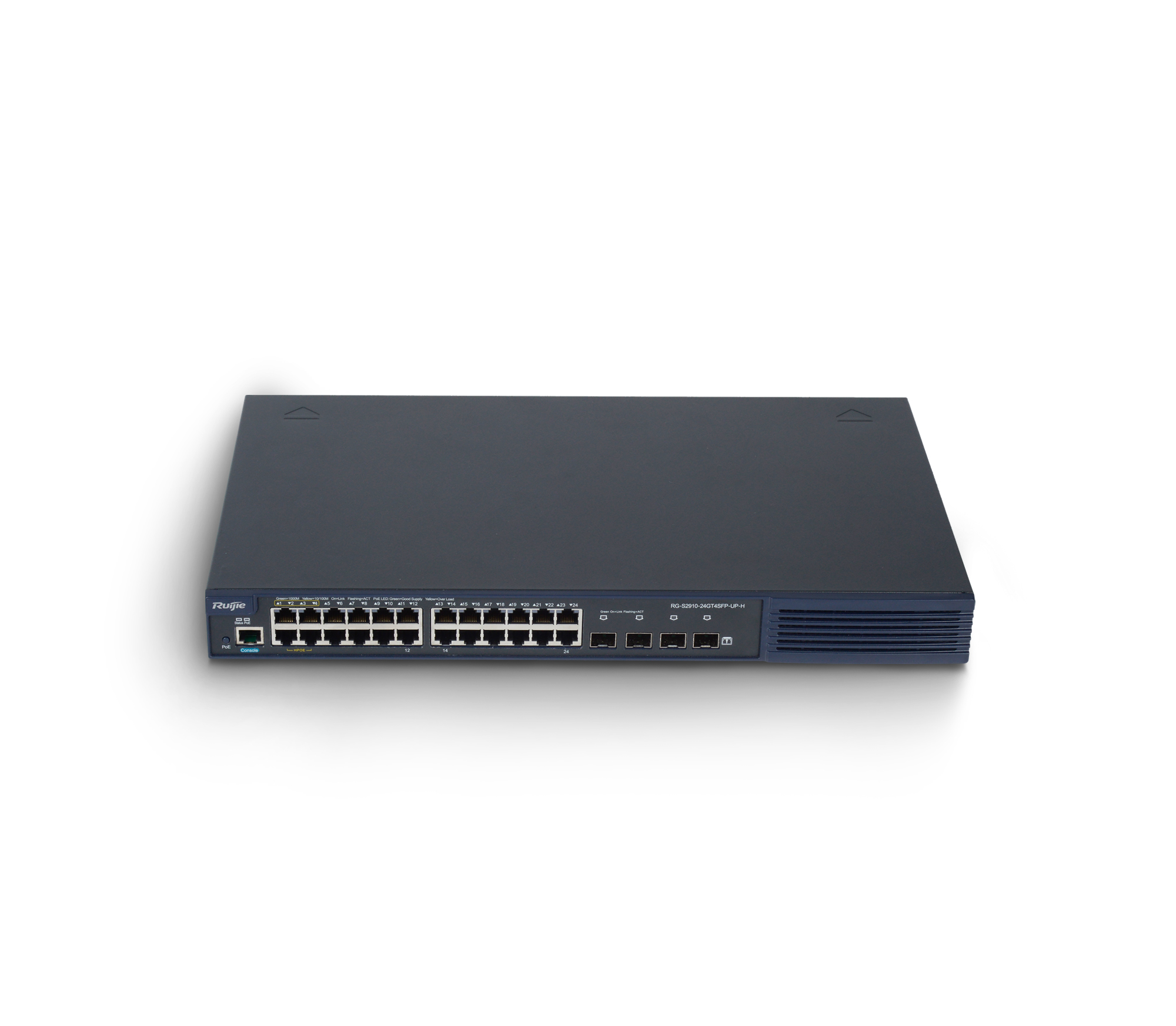

RG-S2910-24GT4SFP-UP-H, 24-Port Gigabit L2+ Managed POE Switch
Various outdoor wireless deployment scenarios to meet the power supply requirements of outdoor high-power wireless access points.
RG-S2910-24GT4XS-UP-H
Ports
Fixed service port
24 x 10/100/1000M electrical ports supporting auto negotiation + 4 x 1GE SFP ports
24 x 10/100/1000M electrical ports supporting auto negotiation + 4 x 10GE/1GE SFP+ ports
System
56 Gbps
128 Gbps
Packet forwarding rate
42 Mpps
96 Mpps
Dimensions (W x D x H)
440 mm x 260 mm x 44 mm (17.32 in. x 10.24 in. x 1.73 in.)
Rated input voltage
AC input: rated voltage range 100 V to 240 V, frequency 50/60 Hz
Maximum input voltage
AC input: rated voltage range 90 V to 264 V, frequency 50/60 Hz
Input voltage
High voltage DC (HVDC) input: input voltage range 192 V to 290 V
PoE power supply
24 x electrical ports supporting PoE and PoE+
Maximum output power of a PoE interface
Maximum PoE/PoE+ output power: 370 W
Fan monitoring
Fan speed adjustment and fault alarms
0°C to 50°C (32°F to 122°F)
Storage temperature
Operating humidity
10% to 90% RH
Storage humidity
5% to 95% RH
Operating altitude
–500 m to +5000 m (–1640.42 ft to +16404.20 ft)
