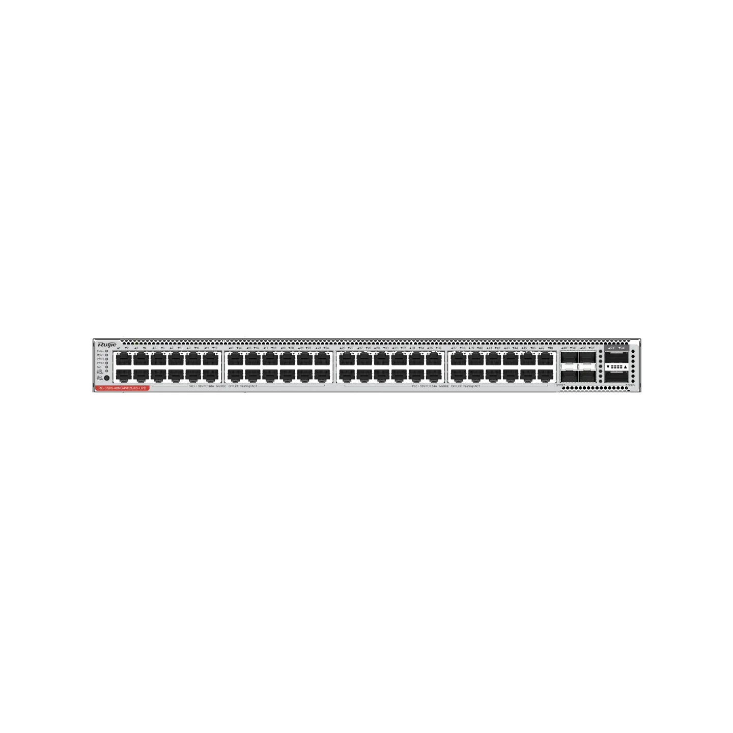

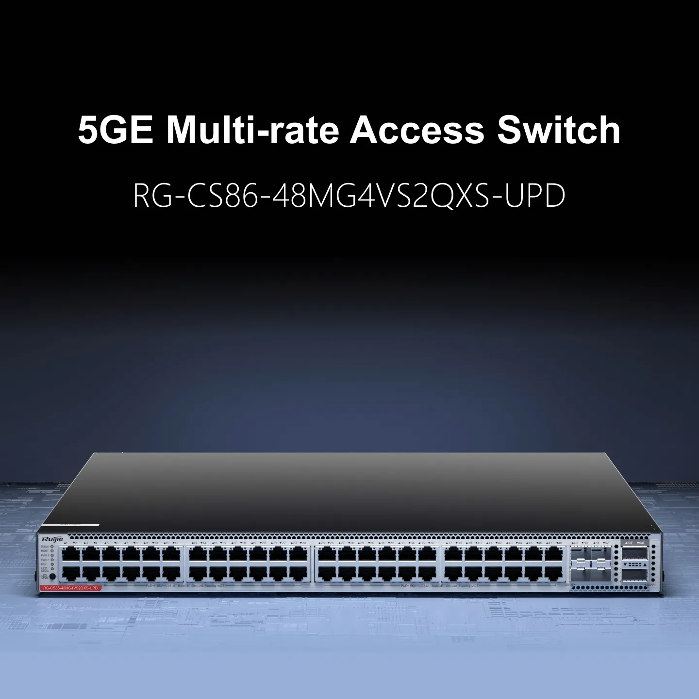

RG-CS86-48MG4VS2QXS-UPD 48-Port Multi-GE Switch with Cloud Management, Full 1GE/2.5GE/5GE Access with PoE/PoE+/PoE++
Delivering fast hardware processing and good operation experience, and satisfying requirements on high speed, security, and intelligence for enterprise campus networks.
  • 48 x 100/1000/2.5G/5GBASE-T ports for access, 4 x 10GE/25GE SFP28 ports and 2 x 40GE QSFP+ ports for uplink, meeting high-bandwidth campus network demands

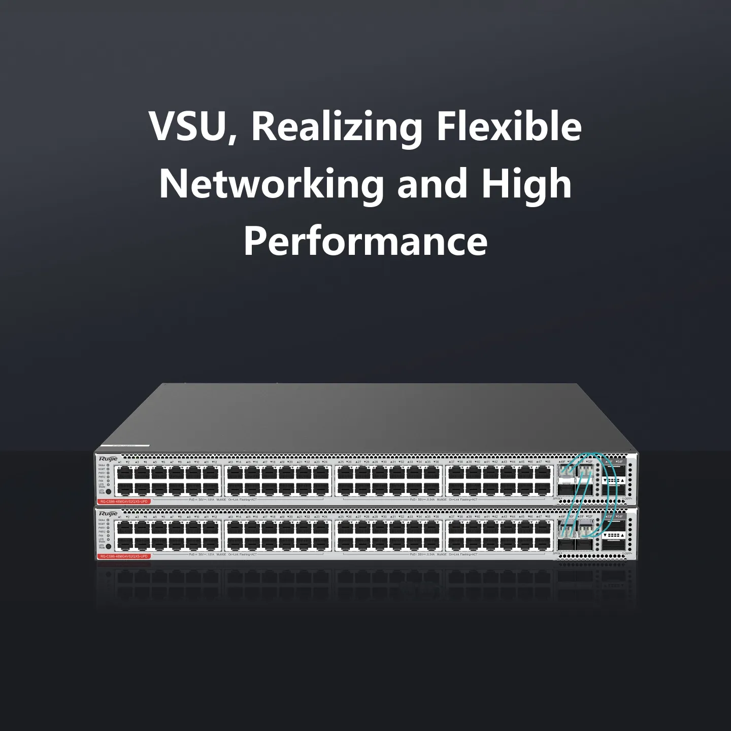

  • VSU, realizing flexible networking and high performance

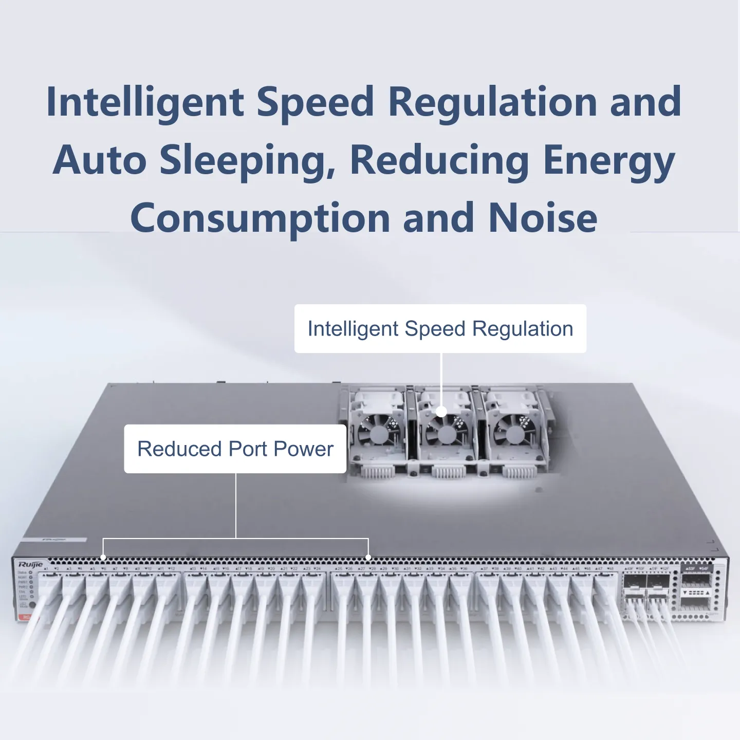

  • Intelligent speed regulation and auto sleeping, reducing energy consumption and noise

RG-CS86-48MG4VS2QXS-UPD, 5GE Multi-rate Access Switch
4 x 25GE SFP28 ports and 2 x 40GE QSFP28 ports for uplink, enabling flexible networking High-power PoE++, offering up to 90 W output and adapting to services in Wi-Fi 6E and Wi-Fi 7 eras

VSU Virtualization, Flexible Networking and High Performance
Millisecond Failover
High Scalability
Simplified Networking
Connected by an aggregate link, the VSU virtual system and peripherals switch links in milliseconds to ensure service continuity in case of a failure.

Intelligent Speed Regulation and Auto Sleeping, Reducing Energy Consumption and Noise
Intelligent fan speed regulation based on monitored component temperatures, saving energy, Auto service port sleeping, reducing device power consumption
