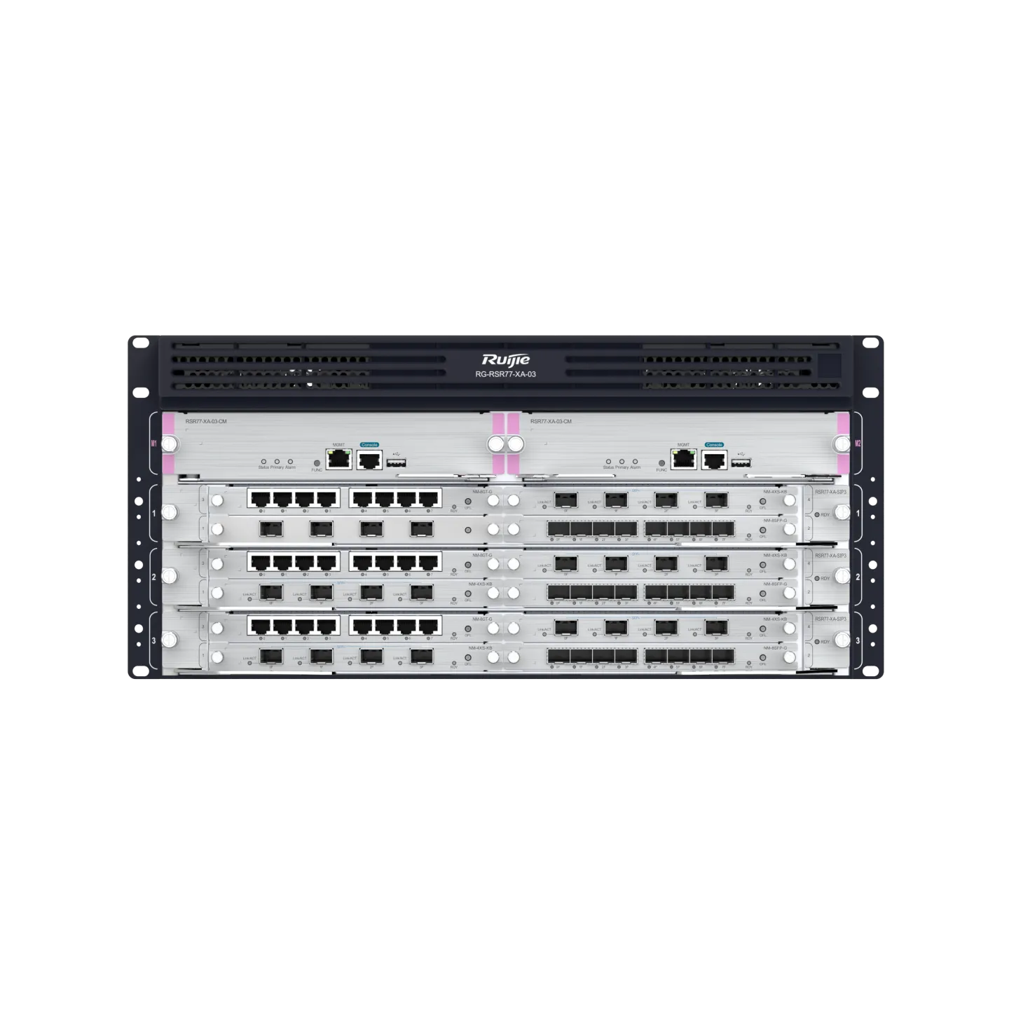

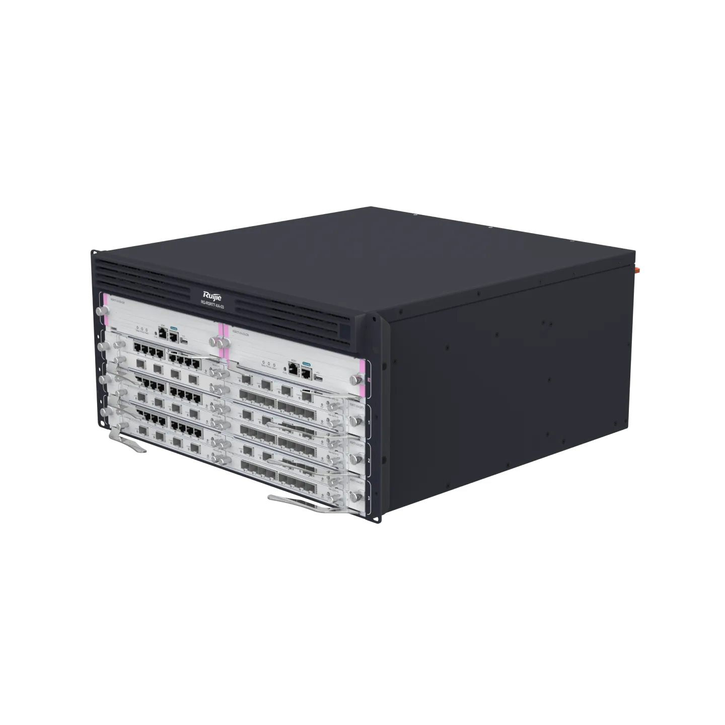

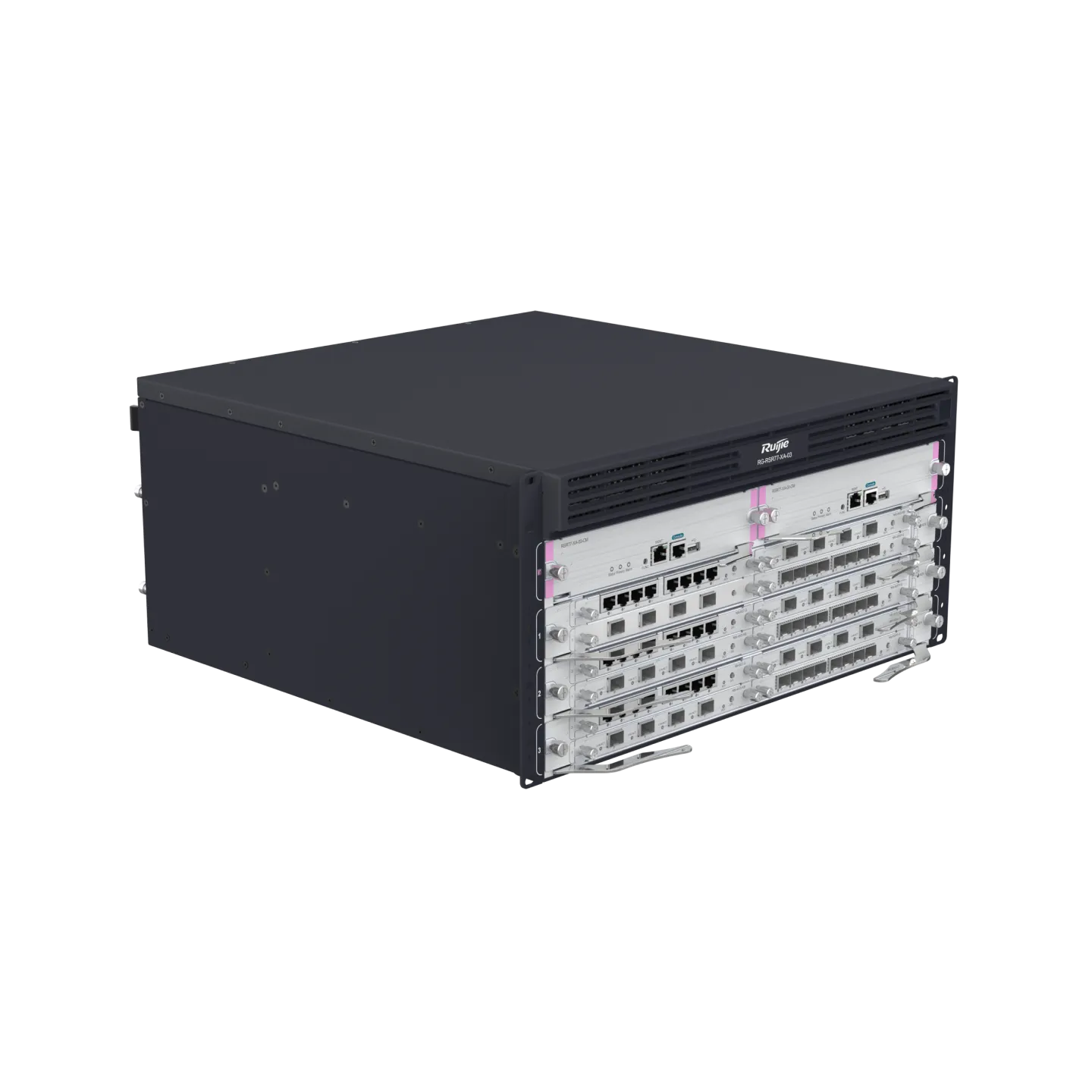

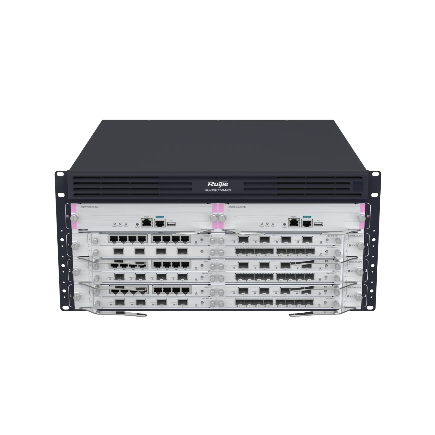

RG-RSR77-XA-03 5 RU Multiservice Core Modular Router
Mainly used as the core or aggregation node on a WAN of the government, finance, carrier, education, or large- and medium-sized enterprise network.
  • A modular design with various expansion card interfaces, supporting rates ranging from 2 Mbps to 100 Gbps.
  • Support for Segment Routing over IPv6 (SRv6), simplifying protocol configuration and facilitating quick service rollout.
  • Redundancy for critical components, ensuring uninterrupted services and improving overall reliability.
  • Y-shaped airflow design, improving cooling efficiency and lowering energy consumption.
Özellikler
Multiservice Core Router RG-RSR77-XA-03
The router supports eight line card slots and 32 subcards and offers high-density GE, 10GE, and 100GE ports. This series is designed to fit into cabinets with a depth of 600 mm (23.62 in.), saving approximately 30% of space compared to similar products in the industry.
Appearance
Dimensions

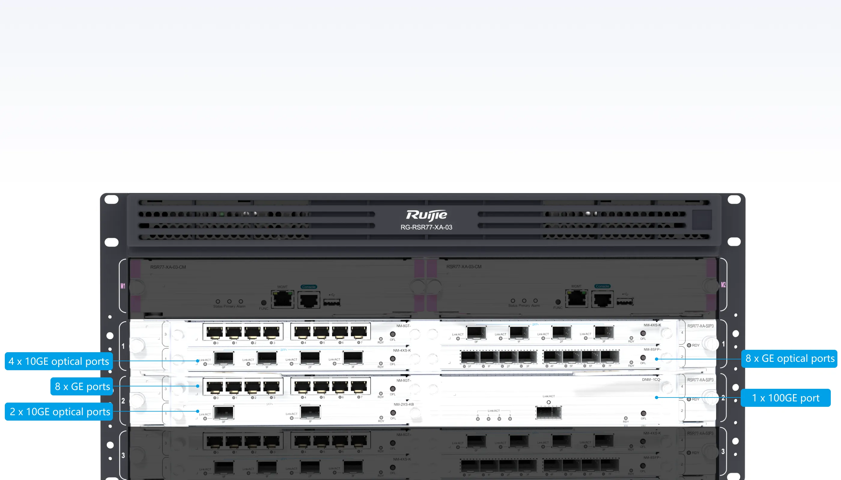

A Modular Design with Various Subcard Ports, Supporting Rates Ranging from 2 Mbps to 100 Gbps
Line cards include main cards and subcards. The subcards support multiple types of ports, including GE, 10GE, and 100GE ports. You can install subcards as needed to meet different networking requirements.

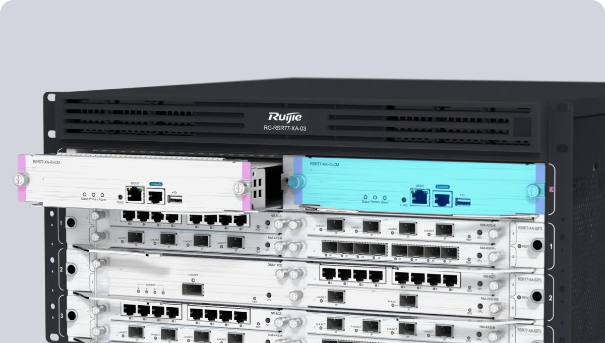

Redundancy for Critical Hardware Components, Ensuring Uninterrupted Services and Improving Overall Reliability
A redundant design is adopted for key components, such as the supervisor engine, switch fabric module, and power supply module. All modules support hot swapping, reducing the risk of device failures and service interruptions, and significantly enhancing system reliability.
1:1 Redundancy for Engine Integrating Routing and Switching
If the active routing engine fails, the data or service is switched to the standby routing engine within seconds. Hot swapping is supported for the active and standby engines, ensuring zero packet loss.

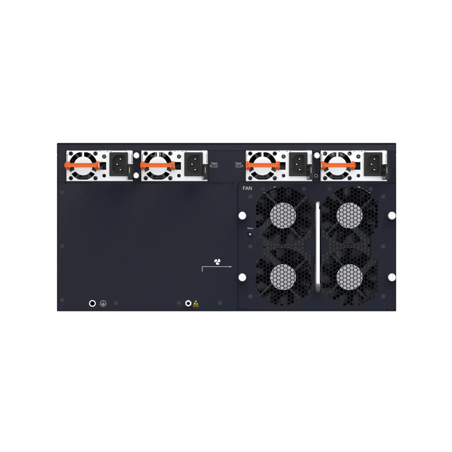

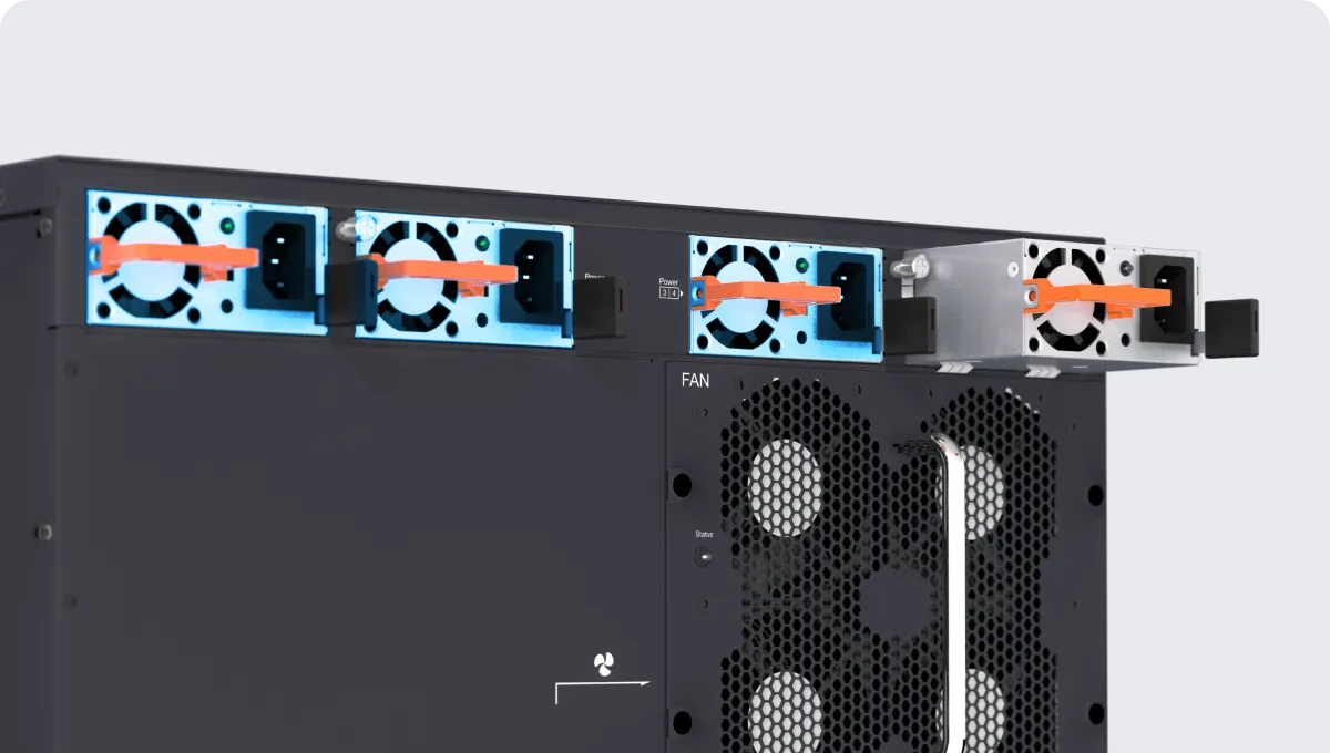

N+M Power Supply Module Redundancy
The router supports AC/DC power supply redundancy and hot swapping, ensuring uninterrupted power supply.

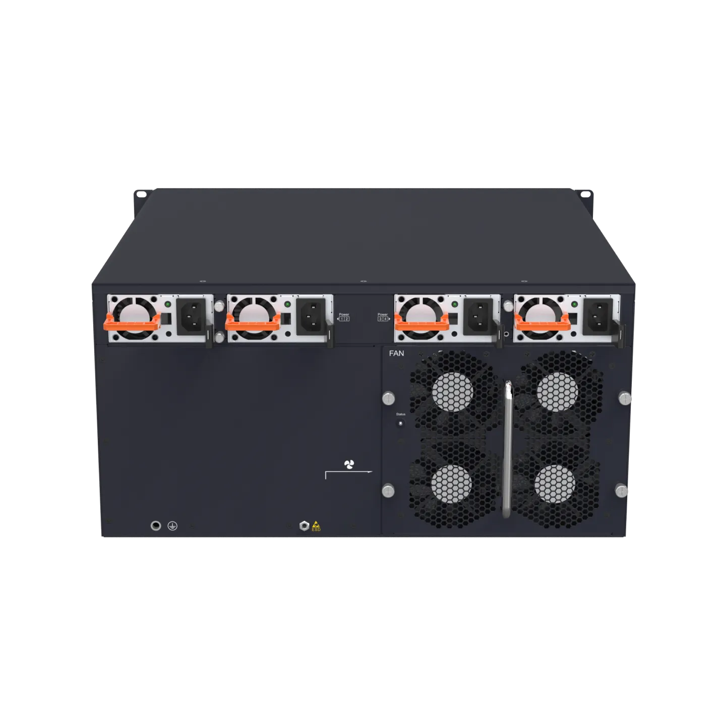

Y-shaped Airflow Design, Improving Cooling Efficiency and Lowering Energy Consumption
The side-to-rear Y-shaped airflow design creates a three-dimensional heat dissipation channel, increasing the airflow by 30% and enhancing the overall efficiency of heat dissipation. Independent airflows of line cards and switch fabric modules,
improving the heat dissipation efficiency and achieving a minimum power consumption of 0.5 W per gigabyte of data transmission.

Module slot
2 x supervisor module slots
3 x modular line card slots(A maximum of 12 modular port adapters are supported.)
4 x power module slots
1 x fan module slot
8 x modular line card slots(A maximum of 32 modular port adapters are supported.)
4 x switch fabric module slots
2 x fan module slots

Power supply
4 x power modules(N+M redundancy)
Power input
RG-PA460-RI (AC input):
● Rated input voltage: 100 V AC to 240 V AC, 50 Hz to 60 Hz
● Maximum input voltage: 90 V to 290 V AC, 45 Hz to 65 Hz
● Maximum input current: 6 A
RG-PA1600I (AC Input):
● Rated input voltage: 100 V to 240 V AC, 50Hz~60Hz
● Max. input voltage: 90 V to 290V AC, 47Hz to 63Hz
● Max. input current: 16 A
RG-PD600I (DC Input):
● Rated input voltage: -48 V to -60 V DC
● Max. input voltage: -38 V to -75 V DC
● Max. input current: 20 A
Power output
● Output voltage: 12 V
● Maximum output current: 36 A
RG-PA1600I:
● 90V to 176V AC Input:
 ○ Output Voltage: 12 V DC
 ○ Maximum output current: 100 A
● 176V to 290V AC Input:
 ○ Maximum output current: 133.4 A
RG-PD600I:
● DC Input:
 ○ Output voltage: 12 V DC
 ○ Maximum output current: 50 A
Maximum output power
RG-PA460-RI:
● 90 V AC to 290 V AC:460W
RG-PA1600I:
90 V AC to 176 V AC, 1200 W
176 V to 290 V AC, 1600 W
RG-PD600I: 600 W
