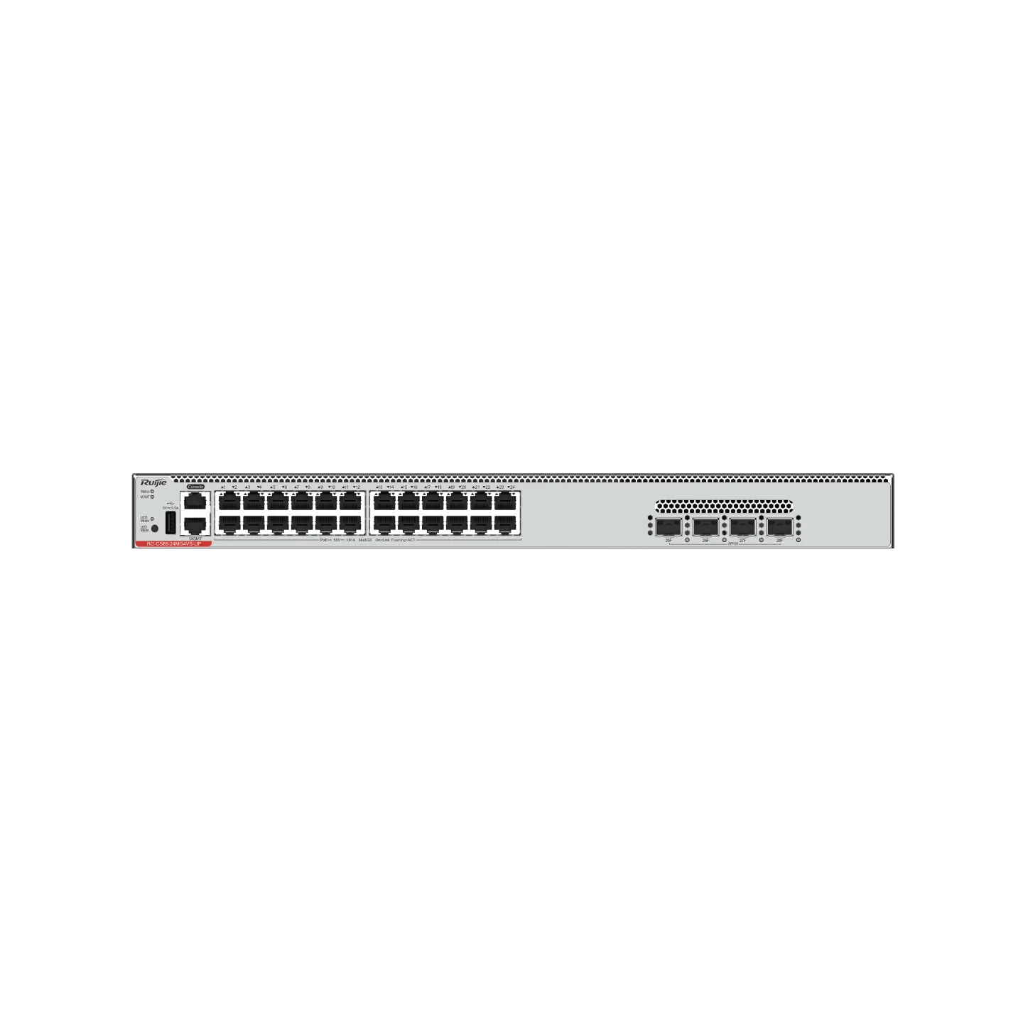

RG-CS86-24MG4VS-UP 24-Port Multi-GE Switch with Cloud Management, Full 1GE/2.5GE/5GE Access with PoE++
Delivering fast hardware processing and good operation experience, and satisfying requirements on high speed, security, and intelligence for enterprise campus networks.
  • 24 x 100/1000/2.5G/5GBASE-T ports for access, 4 x 10GE/25GE ports for uplink, meeting high-bandwidth campus network demands
  • Hardware-level multi-protection, ensuring service continuity
  • VSU, realizing flexible networking and high performance
  • Network security policies and real-time monitoring, enhancing network robustness
  • Intelligent speed regulation and auto sleeping, reducing energy consumption and noise
  • Diverse network management modes, enabling simple maintenance
Özellikler
RG-CS86-24MG4VS-UP, 5GE Multi-rate Access Switch
4 x 25GE SFP28 ports for uplink, enabling flexible networking
High-power PoE++, offering up to 90 W output and adapting to services in Wi-Fi 6E and Wi-Fi 7 eras
