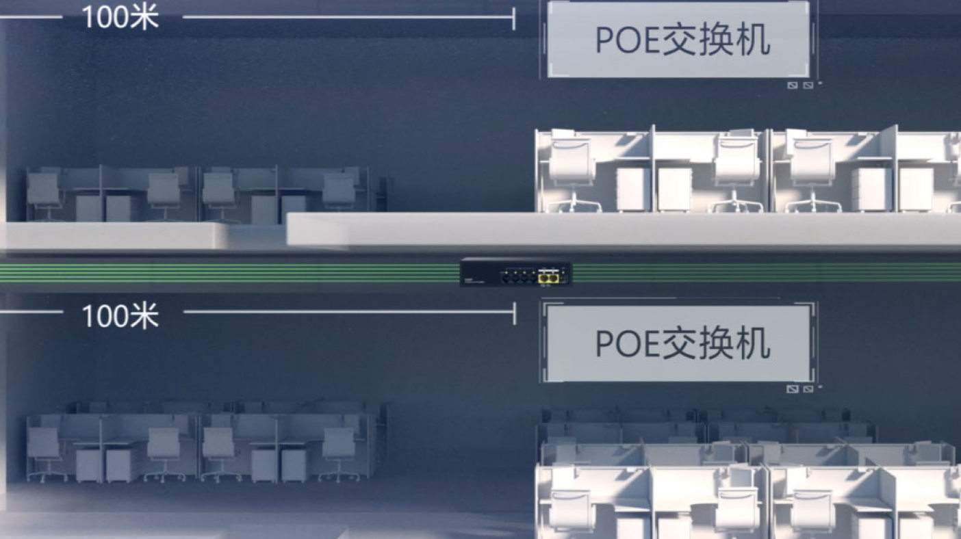

Extra difficulty for O&M due to limited transmission distance and excessive relay nodes
  • Copper cables can only transmit data signals over a distance up to 100 meters so that access switches are used as relay stations in the long-distance transmission, which adds to the maintenance efforts.

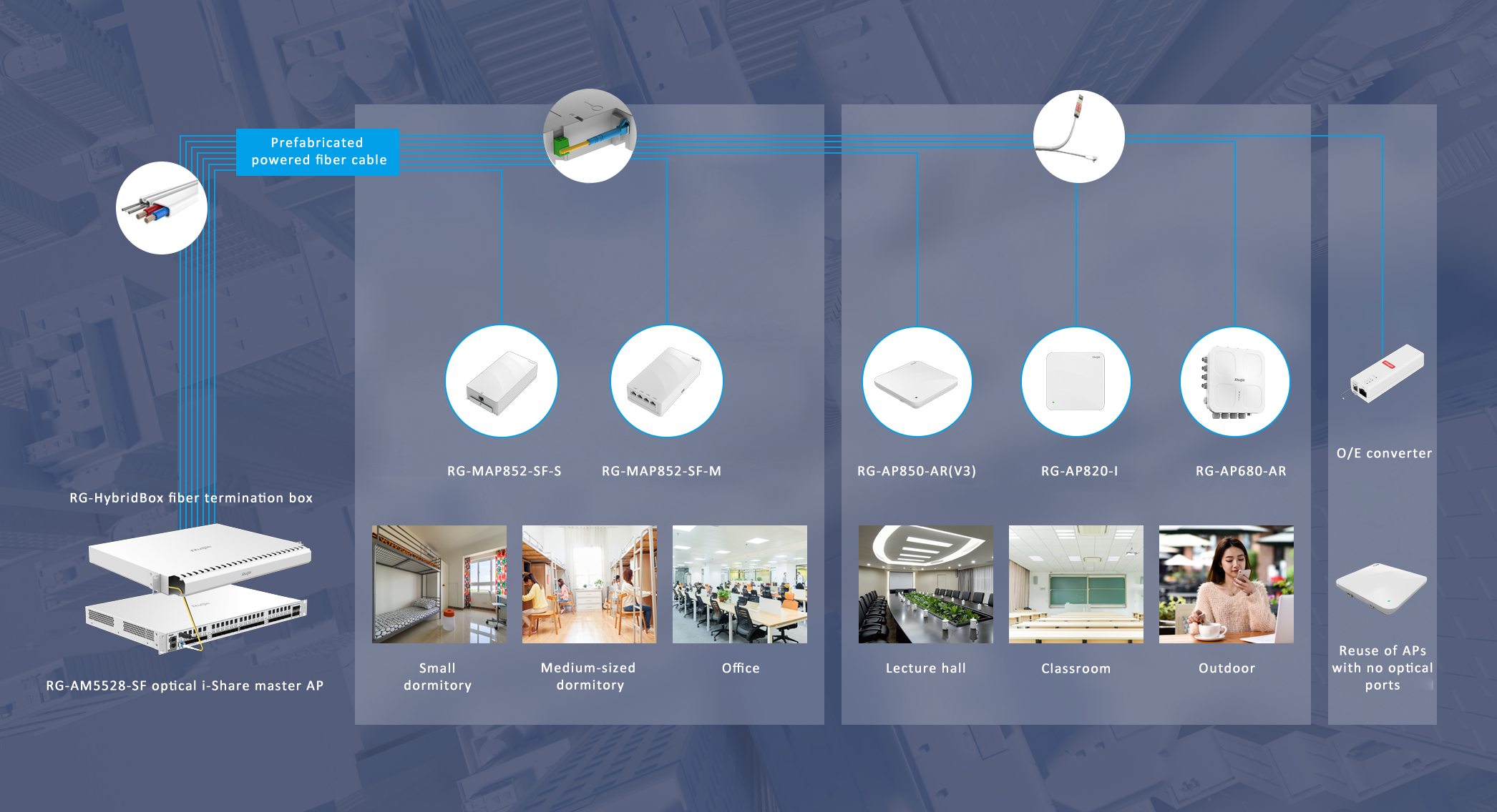

Architecture of the All-optical O-Share Solution
Deployment Mode

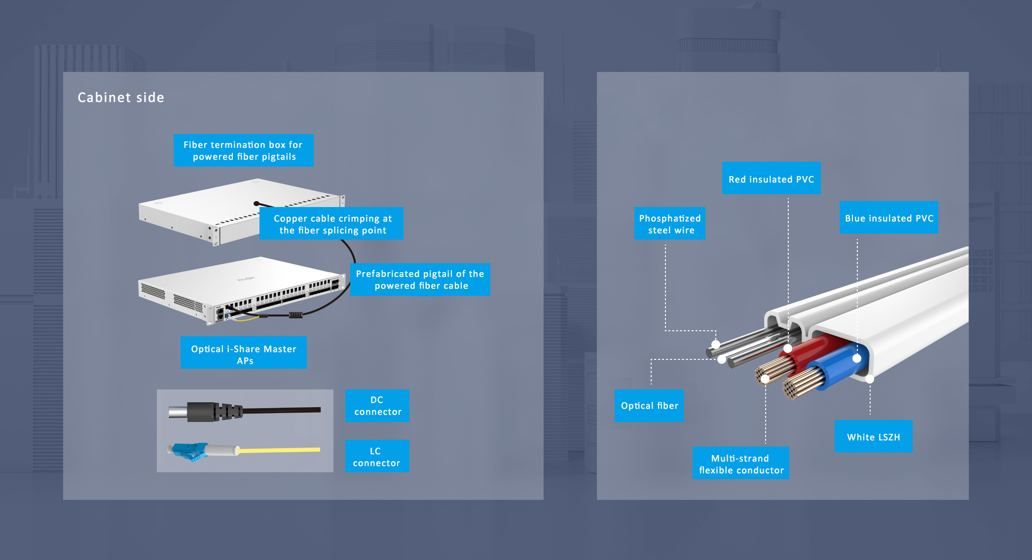

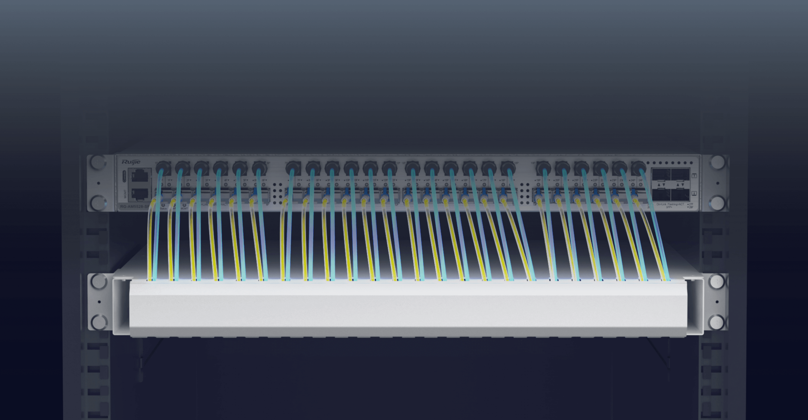

  • Master APs are connected to the fiber termination box through powered fiber cables and pigtails.
  • In the fiber termination box, the powered optical cables are connected to the pigtails (two copper cables are crimped and the optical fiber is spliced). APs receive power supply and transmit data through powered fiber cables.

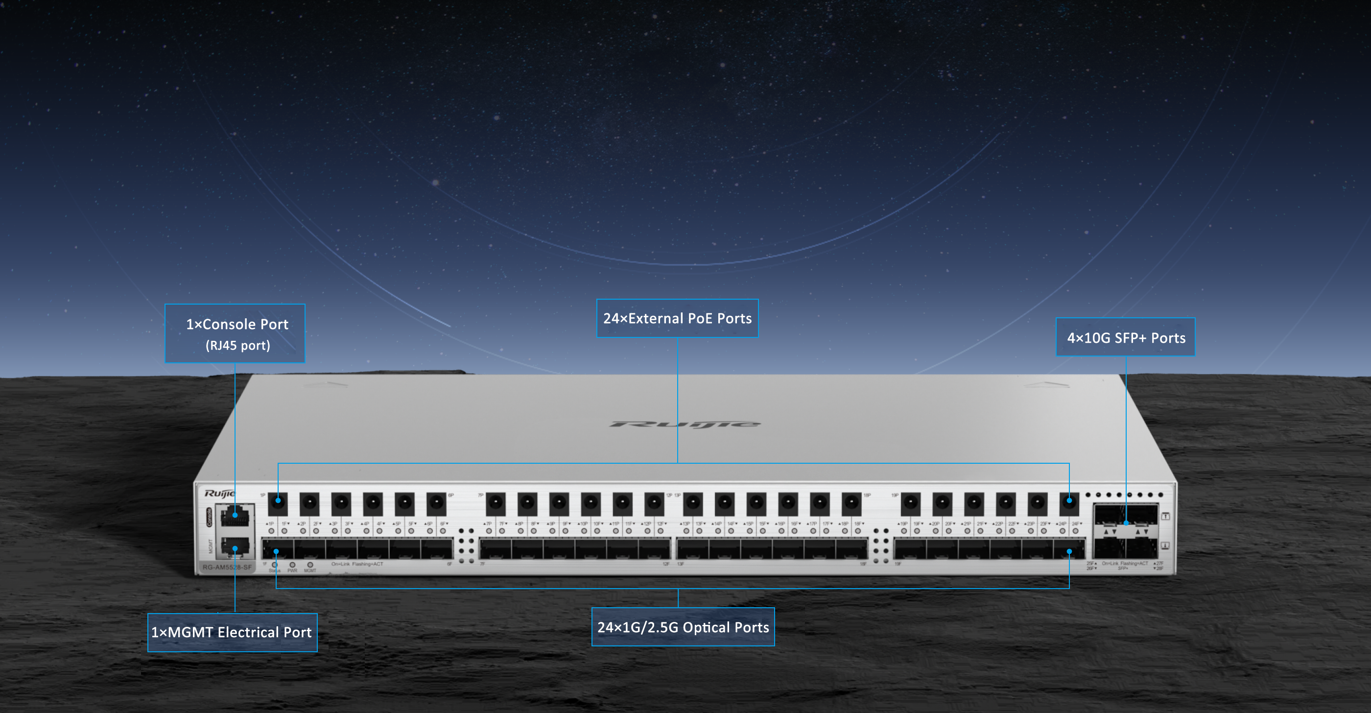

  • Master APs are deployed in the equipment rooms of buildings. They manage and supply power to all micro APs.
Power Supply
  • The phoenix connector, PoE via the RJ45 connector, and O/E converter can be chosen for power supply according to AP connectors.
  • Master APs deliver point-to-point power supply connectors for APs and conduct power supply negotiation through power-over-fiber (PoF).
  • Each master AP can supply power for up to 24 micro APs, cutting down on the devices at each floor and reducing the number of ELV rooms. In this way, no active devices are required on floors, ensuring electricity safety.

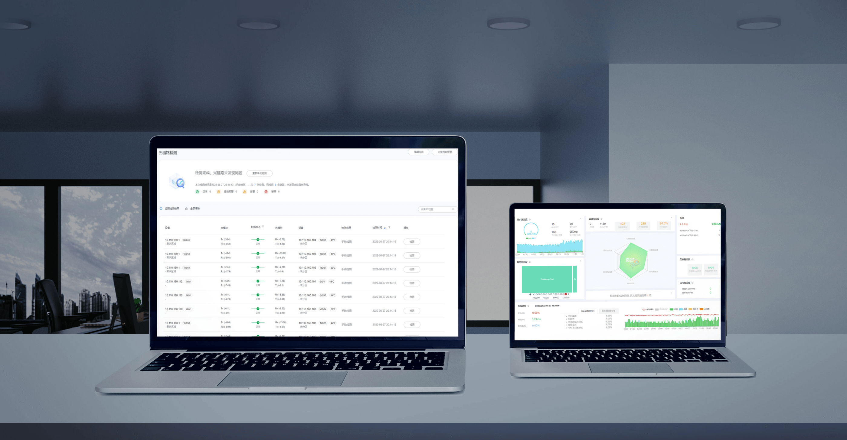

WIS cloud-based visualized O&M allows you to achieve intelligent network optimization through visualized experience, active prediction, and professional fault rectification, improving the O&M efficiency by 100%.
The INC management platform helps perceive statuses of network-wide devices in real time and reports alarms. The platform ensures efficient O&M of the all-optical network through link diagnosis and automatic optimization.
