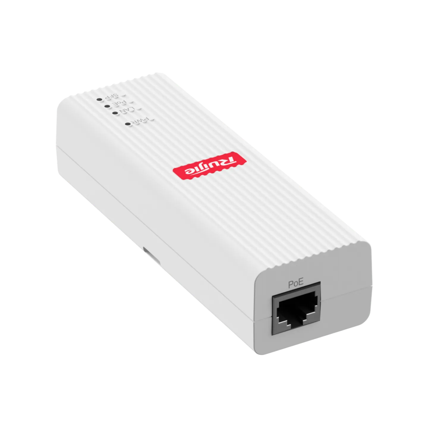

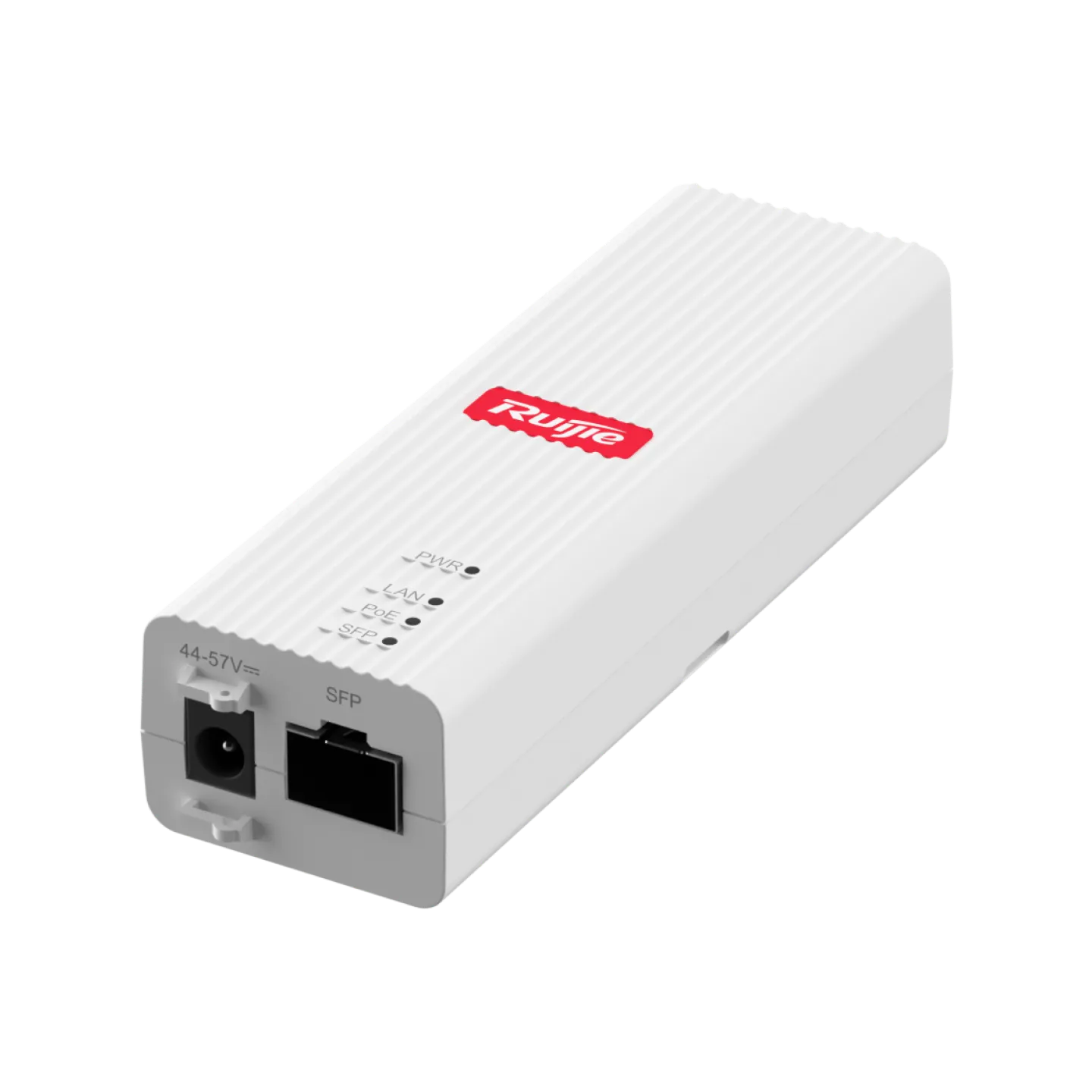

RG-PF2920-DPBOX-P, Single-Port Media Converter, Connecting to a Hybrid Cable in the Uplink Direction, with a PoE Port in the Downlink Direction
Indoor hybrid cable connection, fit for monitoring, wireless connection, and other scenarios on campus networks
  • Hybrid cable connection for power and optical transmission, supporting Ruijie Networks PoF Solution for simplified network deployment
  • Compact size and flexible installation, adapting to various scenarios
  • Fanless design, low noise and energy consumption
Функции
Single-Port Media Converter RG-PF2920-DPBOX-P
The converter supports gigabit fiber-to-the-room, 2.5GE uplink, and hybrid cable connection. It applies to Ruijie Networks Power over Fiber (PoF) Solution and meets the requirements of monitoring, wireless connection, and other scenarios on campus networks.
