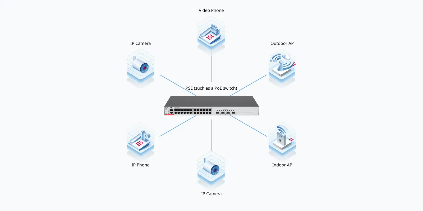

A PoE system involves two roles:
● Power Sourcing Equipment (PSE): provides power, such as a PoE switch or PoE injector. A PSE supplies power to terminals, such as wireless APs and VoIP phones, through Ethernet cables.
● Powered Device (PD): receives power over Ethernet cables.
