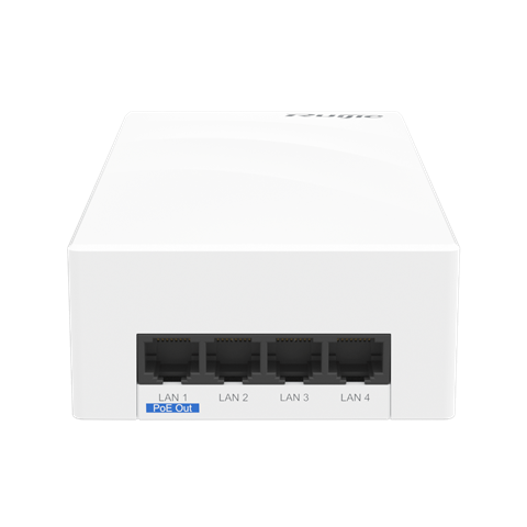

PoE Out for IP Phones and Other IoT Devices
PoE out on LAN1, one cable for data and power transmission
Plug-and-play IP phones, no service interruption in a power failure

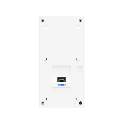

Ports Specifications
RG-AP180P-L
Fixed service port
Uplink:
1 x 100/1000/2.5GBASE-T port, in compliance with IEEE 802.3af/802.3at standard (PoE/PoE+)
When powered by 802.3af PoE, LAN 1 cannot supply power to an attached device.
Downlink:
4 x 10/100/1000BASE-T ports
LAN 1 supports 48 V/10 W power supply to an attached device.
