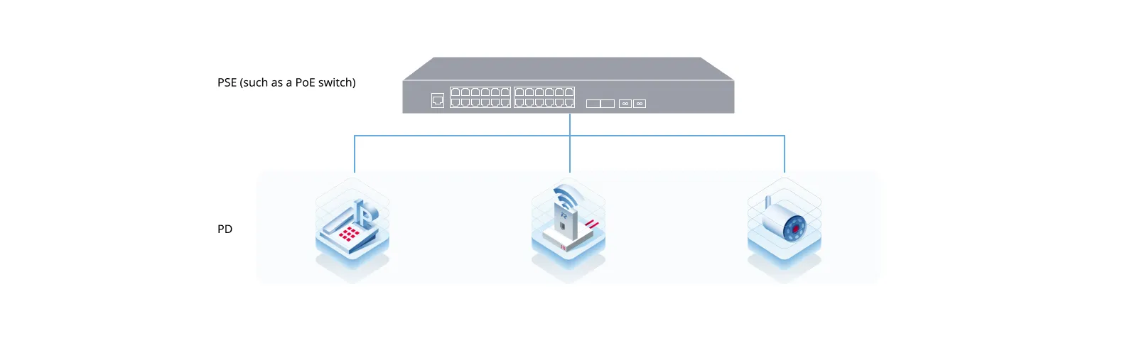

A complete PoE system consists of the Power Sourcing Equipment (PSE) and Powered Devices (PDs). A PSE refers to an Ethernet switch, a router, or other network switching device that supports the PoE function. In wireless network projects, a PD mainly refers to an AP.

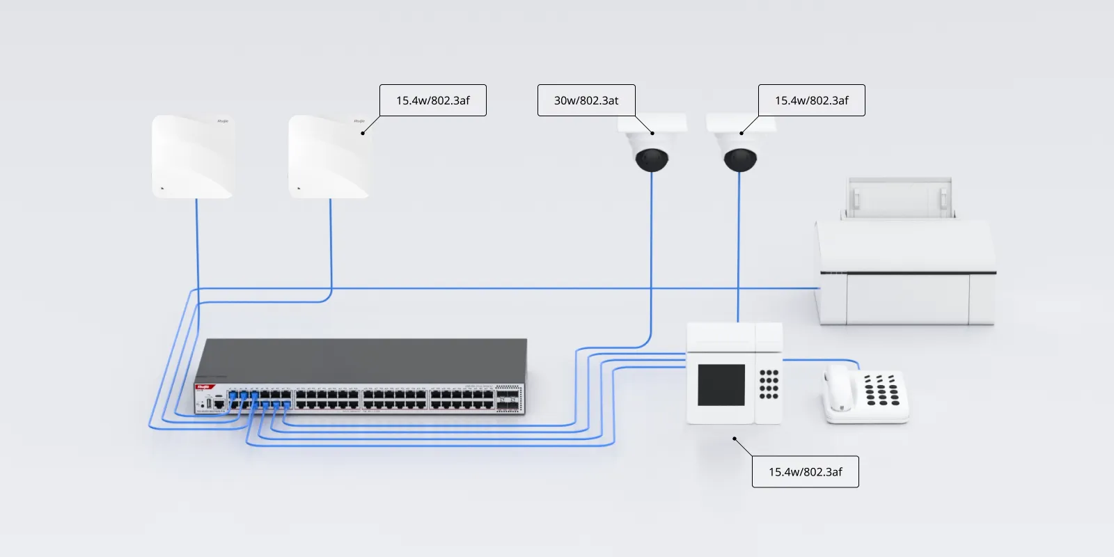

Ruijie 24-port PoE switches RG-S2915-24GT4MS-P-L and RG-S5310-24GT4XS-P-E, as well as 4-port in-room access switches RG-SF2920U-4GT1MS-P support PoE power supply. A device's support for PoE is determined by its hardware. You cannot convert a non-PoE device into a PoE device just by upgrading the software. The following figure shows the application scenarios of PoE. The RG-S5310-E series switches support PoE and can power different types of terminals. For more information, feel free to contact us.
