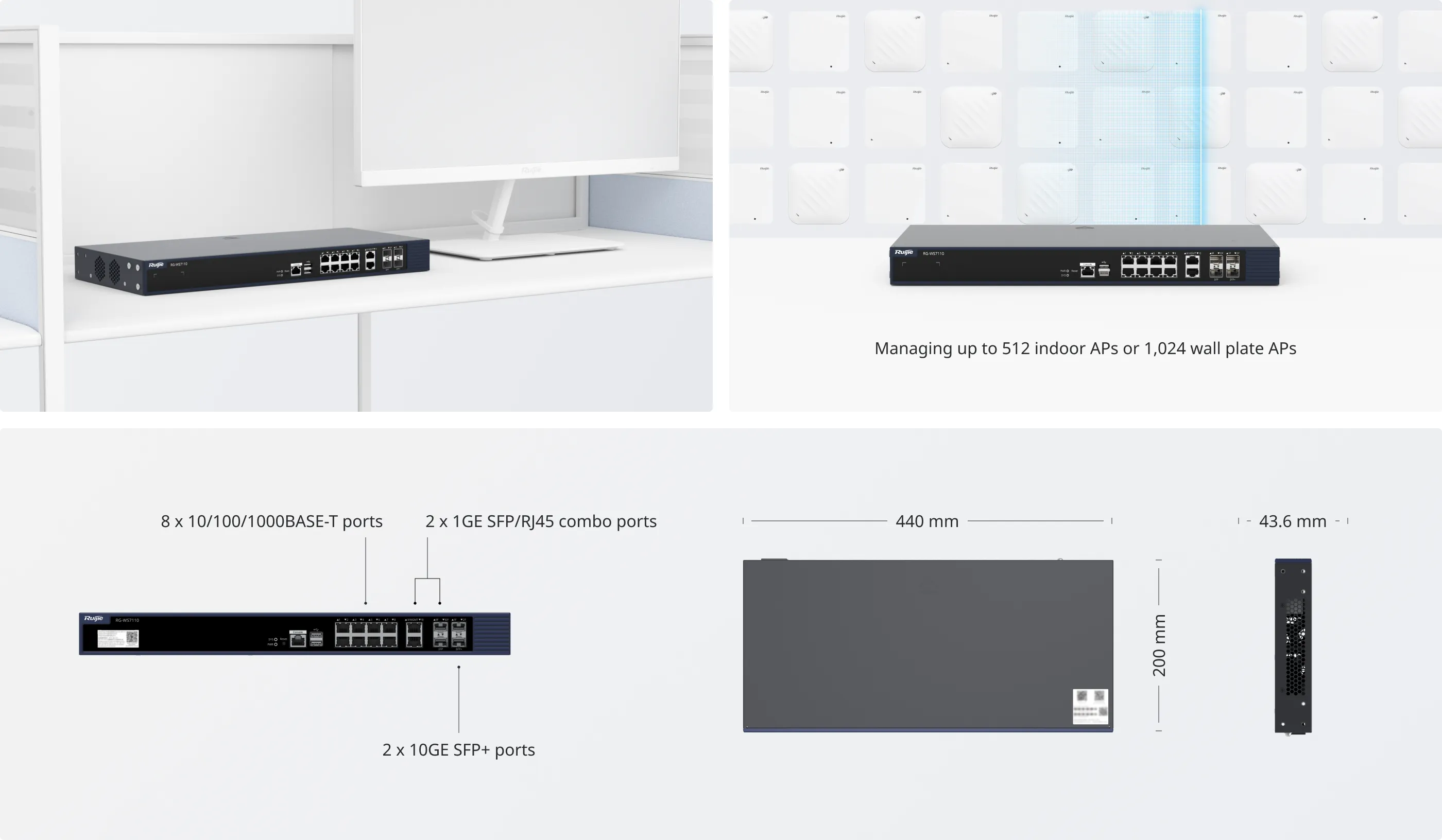

RG-WS7110, 차세대 고성능 10Gbps 무선 액세스 컨트롤러
Applicable to large- and medium-sized network management and suitable for deployment on a Layer 2 or Layer 3 network
  • Supporting 32 licenses by default and up to 512 licenses after expansion
  • Intelligent load balancing, improving network performance
  • MAB, 802.1X, and Web-based authentication, ensuring network security
  • Unified cloud management, enabling remote O&M
Key Specification
View More

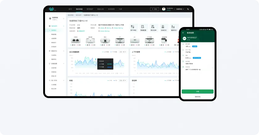

Unified Cloud Management
Unified management through WIS Cloud, eliminating the need for on-site provisioning.Real-time warning and intelligent troubleshooting, improving O&M efficiency.

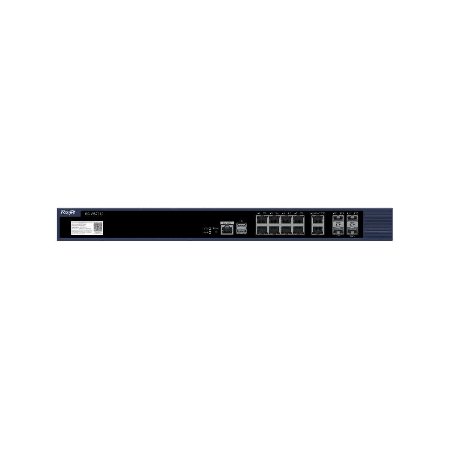

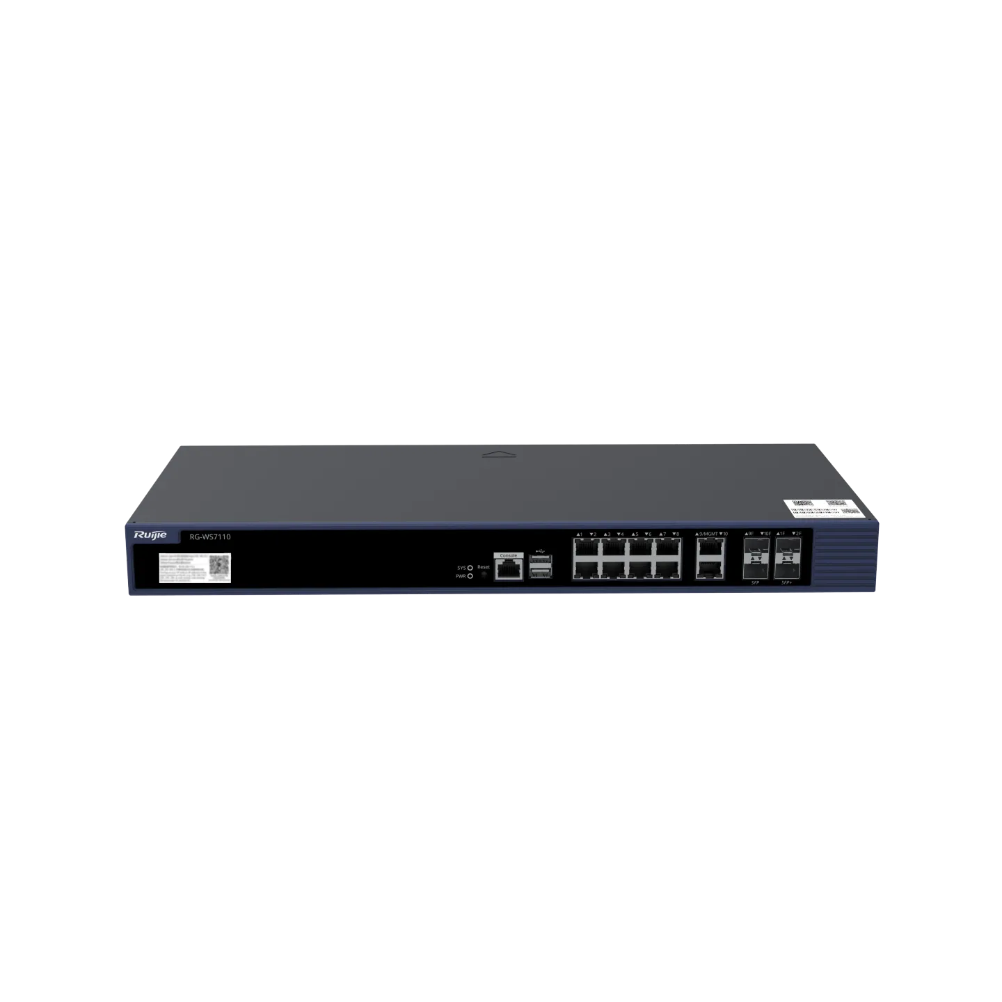

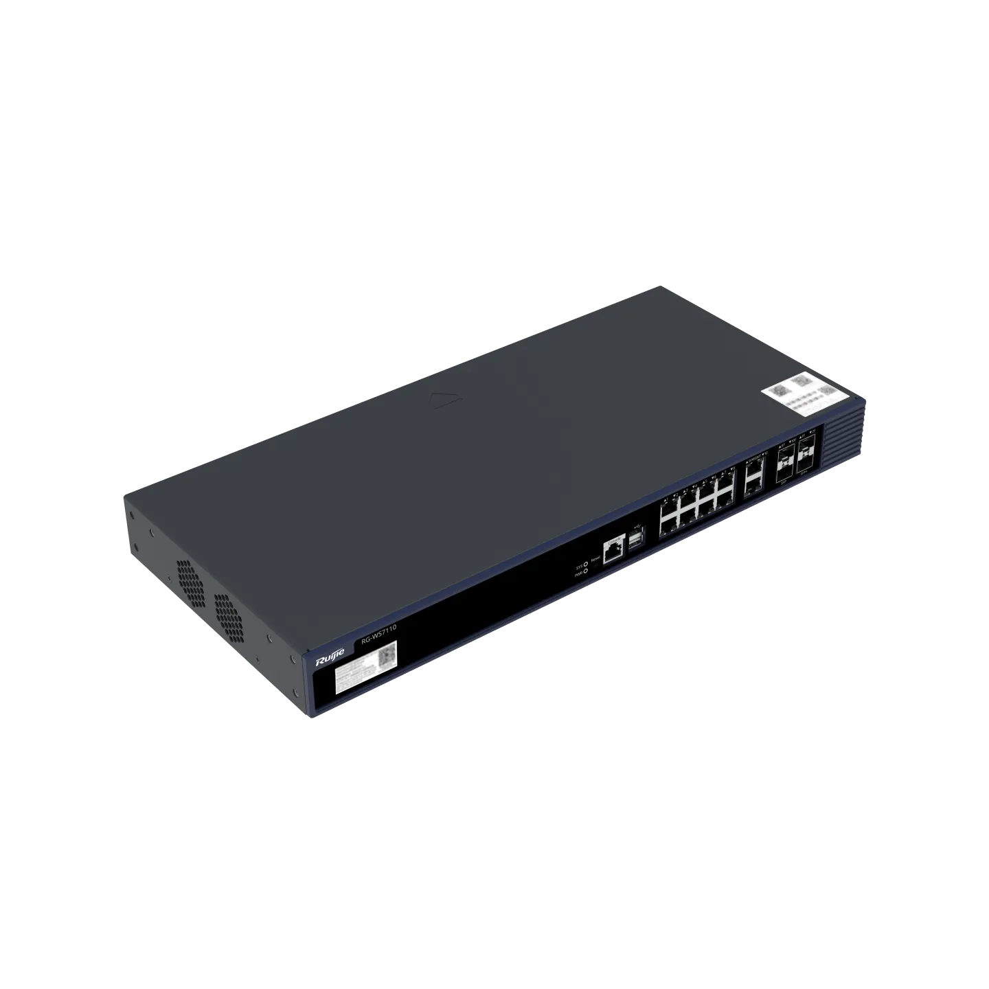

Specifications
System specifications
RG-WS7110
Memory
4 GB
Flash memory
16 MB
RG-WS7110
Unit dimensions (W x D x H)
440 mm x 200 mm x 43.6 mm (17.32 in. x 7.87 in. x 1.72 in., without rack-mount brackets)
486.2 mm x 205 mm x 43.6 mm (19.14 in. x 8.07 in. x 1.72 in., including rack-mount brackets)
Rack size
1 RU
Unit weight
2.7 kg (5.95 lbs)
Shipping weight
3.5 kg (7.72 lbs)
Mounting
Rack-mount
RG-WS7110
Fixed service port
8 x 10/100/1000BASE-T ports
2 x 1GE SFP/RJ45 combo ports
● RJ45 ports support 10/100/1000BASE-T.
● Port 9/MGMT can also be used as a management port.
2 x 10GE SFP+ ports
Fixed management port
1 x RJ45 console port
2 x USB 3.0 ports, compatibility with USB 2.0
Status LED
1 x system status LED
1 x power status LED
8 x 10/100/1000BASE-T port LEDs
2 x 1GE SFP/RJ45 combo port LEDs
2 x 10GE SFP+ port LEDs
Button
1 x Reset button
● Press the button for shorter than 3 seconds. Then the device restarts.
● Press the button for longer than 3 seconds. Then the device restores to factory settings.
  • Note
A combo port consists of an optical Ethernet port and an electrical Ethernet port on the panel and can be used as the optical or electrical port at one time. When either of the Ethernet ports is working, the other port is automatically shut down. You can select a port type as required.
