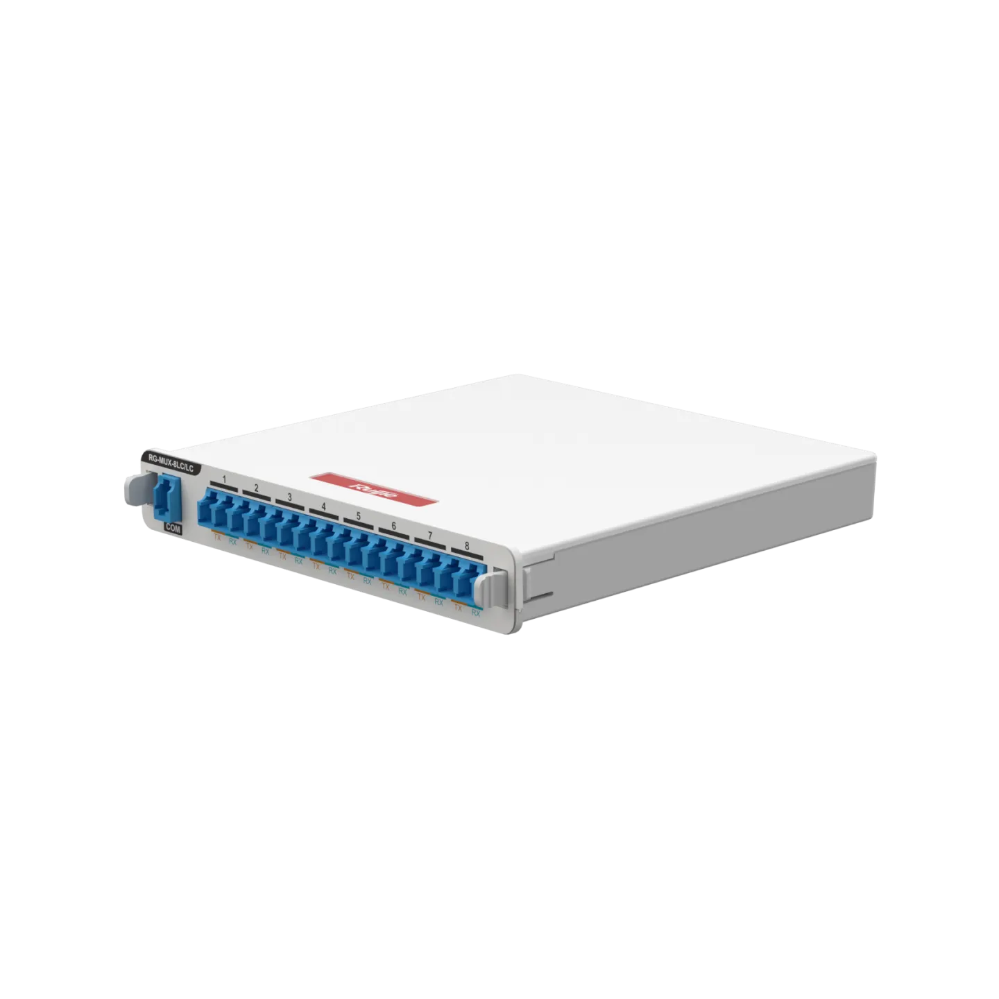

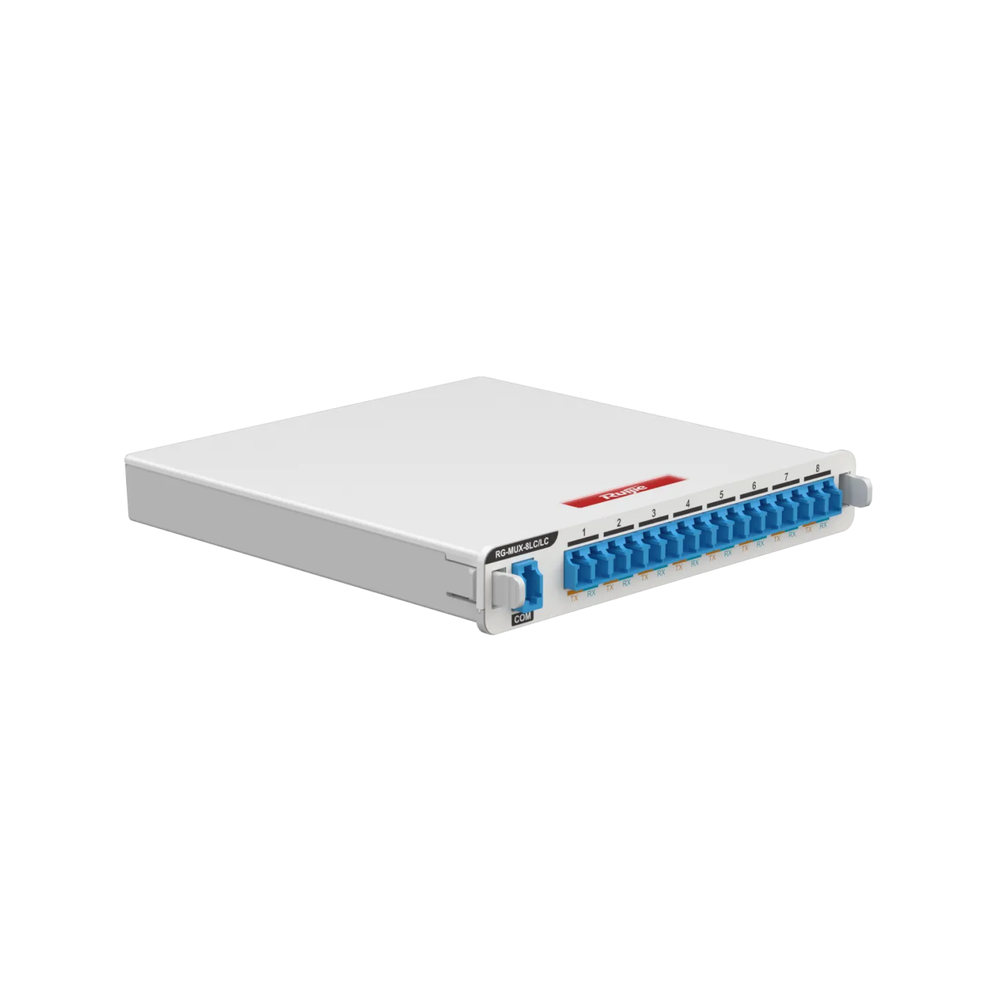

RG-MUX-8LC/LC 전광 모듈형 8포트 투명 분배 장치
Modular transparent distribution device supporting flexible configuration and realizing passive distribution nodes and exclusive FTTR bandwidth of 10 Gbps/1 Gbps
  • On-demand configuration of 8-port modular transparent distribution device, allowing flexible networking
  • CWDM technology with zero fiber splitting, providing exclusive indoor bandwidth of 10 Gbps
  • Fully passive all-optical network devices, making passive distribution nodes possible and solving the challenges of ELV rooms
  • All-optical deployment, easy to upgrade, and flexible extension of Ethernet networks

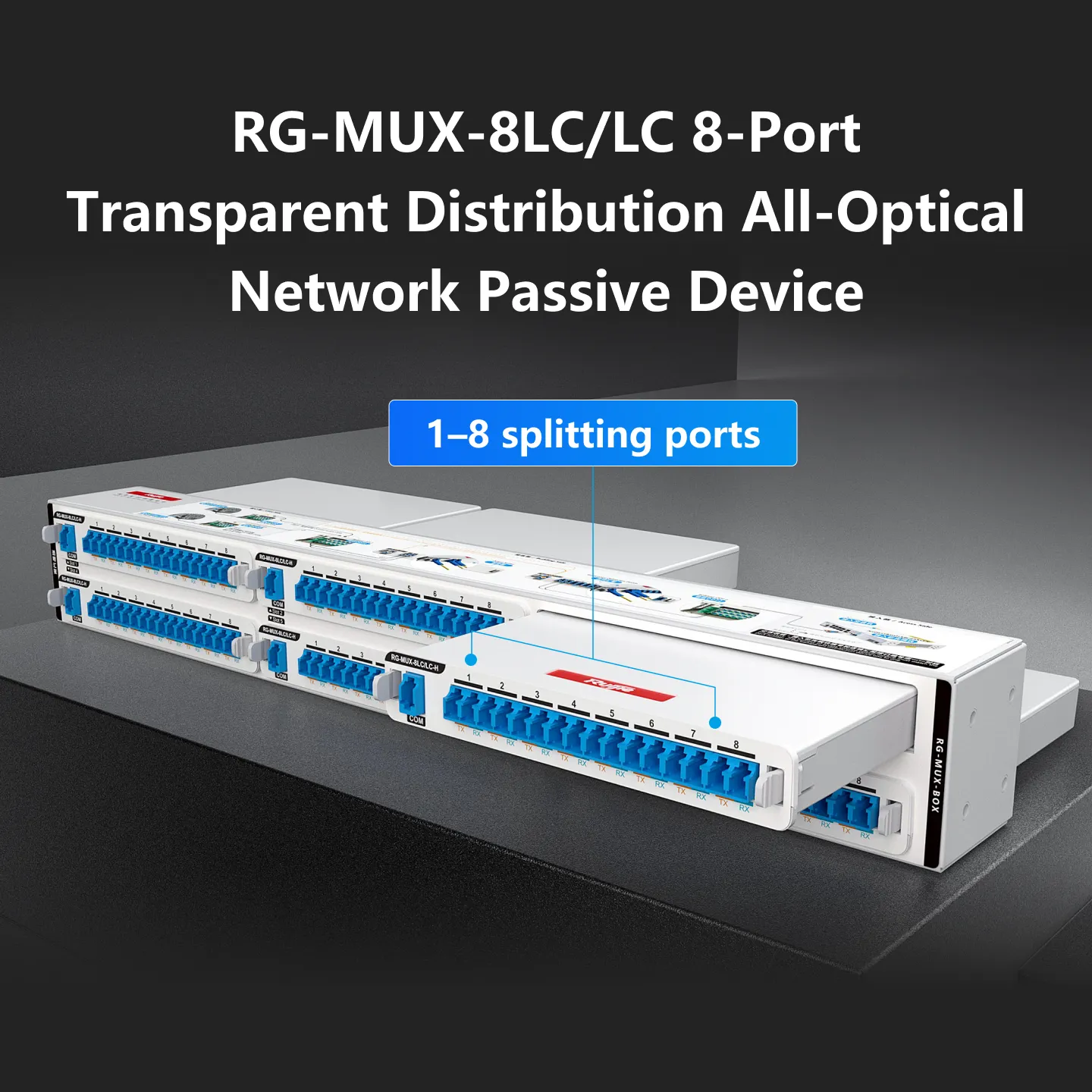

RG-MUX-8LC/LC 8-Port Transparent Distribution All-Optical Network Passive Device
An 8-port transparent distribution device on the building side supports both 10 Gbps and 1 Gbps per port, and can accommodate up to 48 ports when fully loaded.
The device integrates WDM technology, which allows for a network architecture reduced from three layers to two layers. With WDM, services from the core side to the access side are transparently transmitted, realizing passive distribution nodes.
CWDM Technology with Zero Fiber Splitting, Providing Exclusive Indoor Bandwidth of 10 Gbps/1 Gbps
The transparent distribution device enabled with WDM technology allows transparent transmission of services from the core side to the access side, ensuring 1:1 dedicated access to the bandwidth of 10 Gbps. This offering effectively meets high bandwidth requirements of device connections and networking needs of various terminals.
Fully Passive All-Optical Network Devices, Making Passive Distribution Nodes Possible and Solving Challenges of ELV Rooms
By replacing active devices with passive ones, such as optical fibers and transparent distribution devices, connections between the core network and the building side can be established without the ELV room and power supply. This significantly simplifies deployment and lowers the failure rate of external devices, without management and maintenance in ELV rooms.

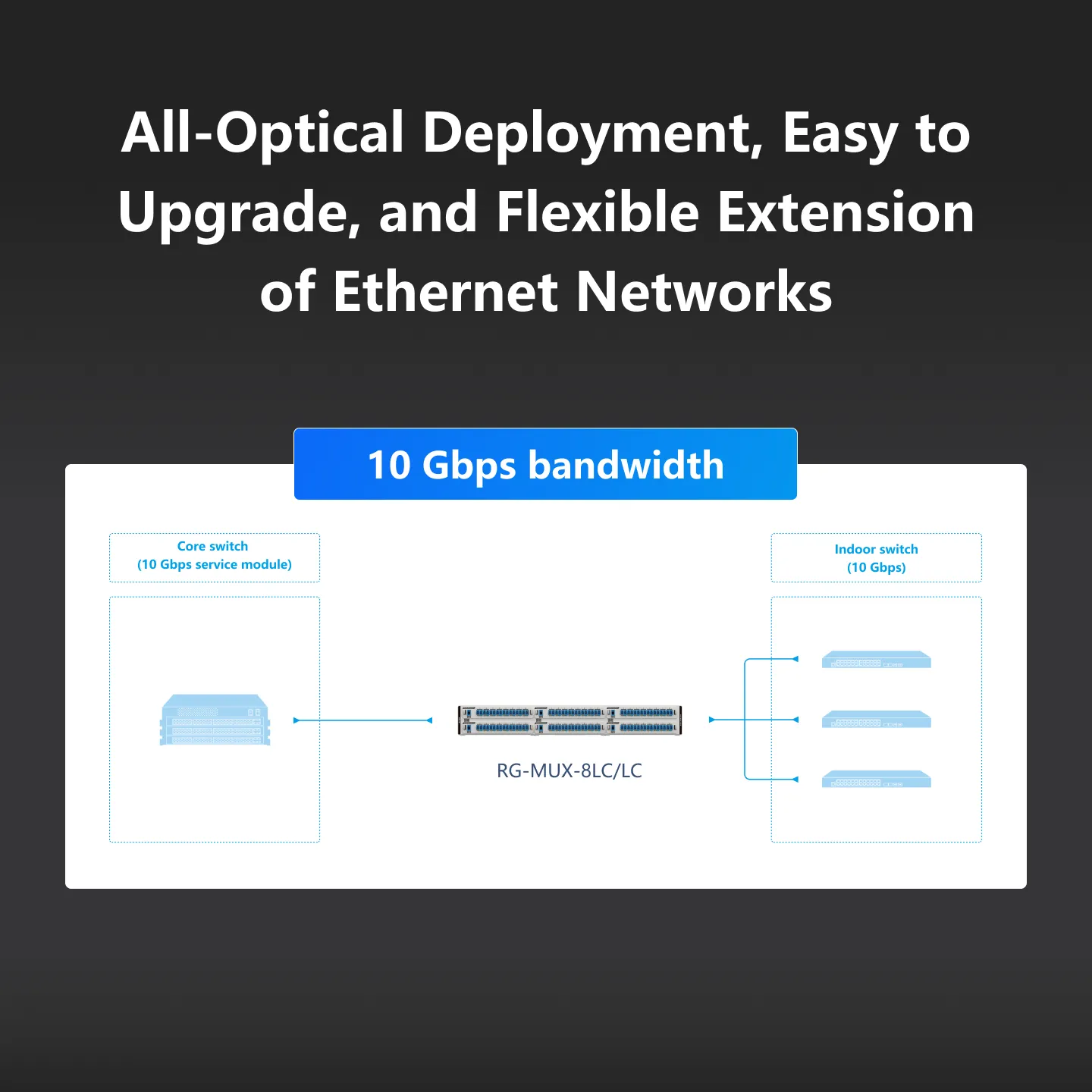

All-Optical Deployment, Easy to Upgrade, and Flexible Extension of Ethernet Networks
Bandwidth can be upgraded from 1 Gbps to 10 Gbps without need to change the backbone cabling area. Switches of different rates can be replaced or added as needed. Transparent distribution devices are plug-and-play, allowing for easy deployment and rapid capacity expansion.
