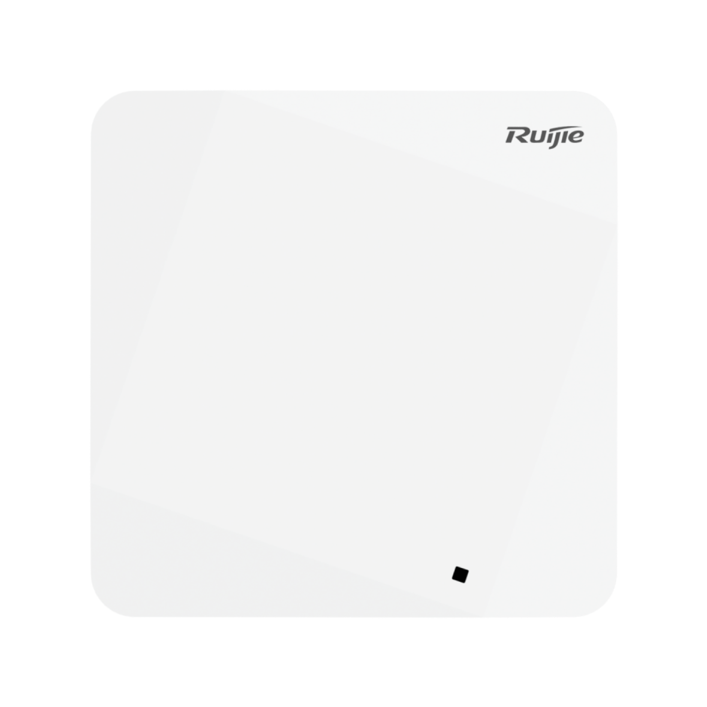

RG-AP720-L, Wi-Fi 5 Dual-Radio 1.167 Gbps Indoor AP
Indoor scenarios for higher education, government, general education, finance, and business sectors.
Modelos
Serie
Características destacadas
  • Dual Radios, Combined Rate Up to 1.167 Gbps
  • Signals Never Drop with Seamless Roaming
  • Auto Configuration, Simplified Provisioning, Easy Deployment
  • Unified Cloud Management, Intelligent Tuning, Easy O&M
Especificaciones clave
View More
Funciones
Ruijie Wi-Fi 5 Indoor AP
RG-AP720-L
2.4 GHz/5 GHz Dual Radios
PoE and DC Power Input
Ceiling Mounting and Wall Mounting
WIS-based Cloud Management
This AP provides both a stable 5 GHz band, and a wide-coverage 2.4 GHz band. Dual radios ensure stable connectivity for more STAs.

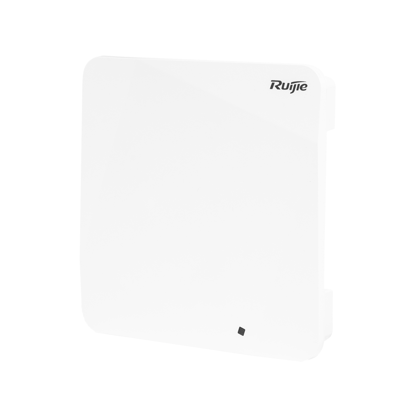

Unit dimensions(W x D x H)
194 mm x 194 mm x 37 mm (7.64 in. x 7.64 in. x 1.46 in.)
Shipping dimensions(W x D x H)
463 mm x 370 mm x 240 mm (18.23 in. x 14.57 in. x 9.45 in.)
Unit weight
Main unit: 0.42 kg (0.93 lbs)
Mounting bracket: 0.07 kg (0.15 lbs)
Shipping weight
7.31 kg (16.12 lbs)

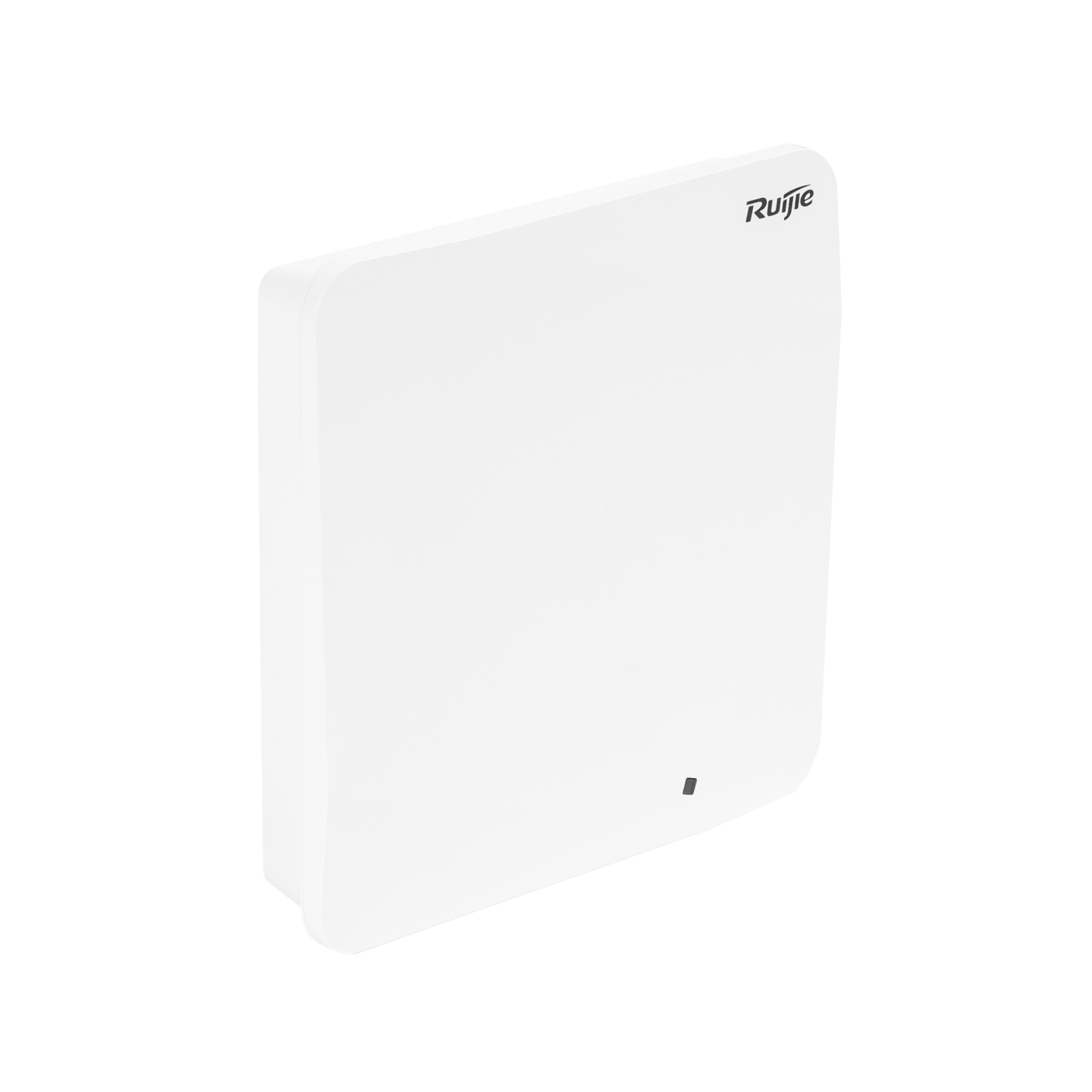

Mounting
Wall/Ceiling-mount (a mounting bracket is delivered with the main unit)
Lock option
Kensington lock and securing latch

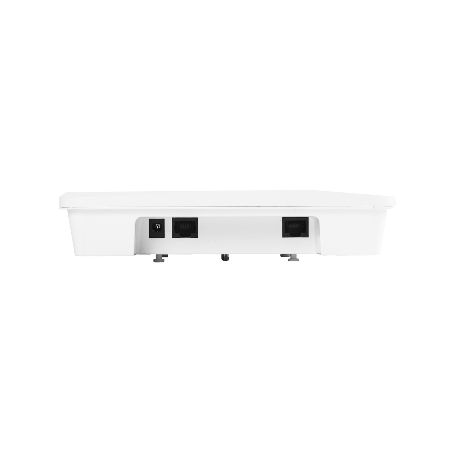

Ports Specifications
RG-AP720-L
Fixed service port
1 x 10/100/1000BASE-T port
● In compliance with IEEE 802.3af standard (PoE)
● Auto MDI/MDIX crossover
● PoE-PD: 54 V DC (nominal) 802.3af/at/bt (Class 3 or higher)
● 802.3az EEE
Fixed management port
Status LED
1 x multi-color system status LED
Button
1 x Reset button
● Press the button for longer than 3 seconds. Then the device restores to factory settings.
RG-AP720-L
Input power supply
● 12 V DC/1.5 A power input over DC connector: The DC connector accepts 2.1 mm/5.5 mm center-positive circular plug. A DC power adapter needs to be purchased separately.
● PoE input over LAN 1: The power source equipment (PSE) complies with IEEE 802.3af standard (PoE).
Note:
● If both DC power and PoE are available, DC power is preferred.
Overall power consumption
Maximum power consumption: 12.95 W
● DC powered: 12.95 W
● PoE powered (802.3af): 12.95 W
● PoE+ powered (802.3at): 12.95 W
● PoE++ powered (802.3bt): 12.95 W
● Idle mode: 6 W
