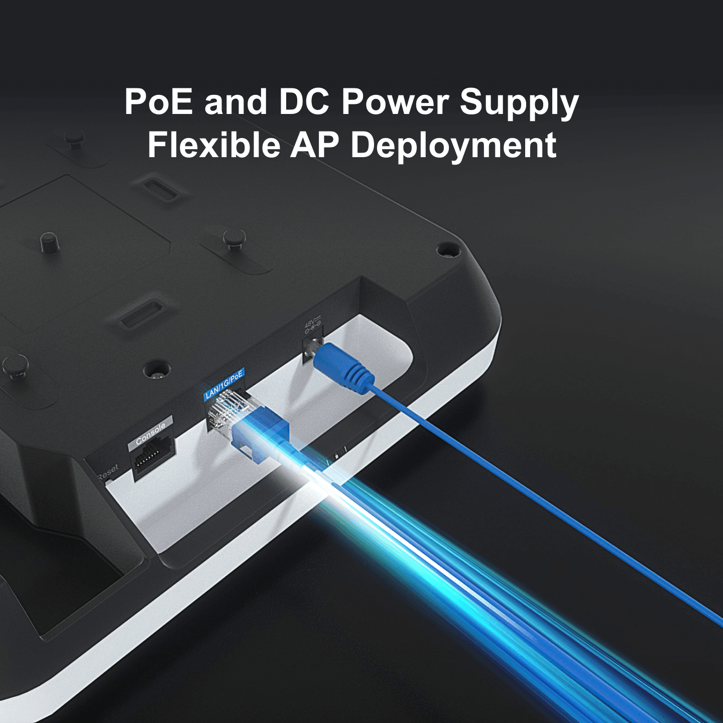

PoE and DC Power Supply, Flexible Deployment
With PoE in, a single network cable can transmit both data and power without external power supply.
With a 48V DC power supply, there's no need for PoE switches, reducing networking costs.
* Power adapters need to be purchased independently.

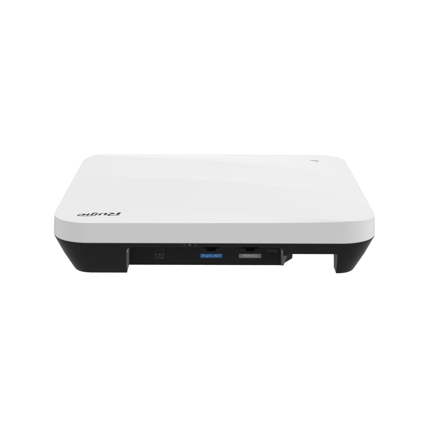

Ports Specifications
RG-AP810-L
Fixed service port
1 x 10/100/1000BASE-T port
● In compliance with IEEE 802.3af standard (PoE)
● Auto MDI/MDIX crossover
● PoE-PD: 54 V DC (nominal) 802.3af/at/bt (Class 3 or higher)
● 802.3az EEE
Fixed management port
Status LED
Button
1 x Reset button

1 x 10/100/1000Base-T uplink port, supporting PoE and DC power supply
Bundled with Ruijie Cloud Service lifetime license
 (The PoE injector is sold separately, which could be purchased from Ruijie.
The DC power adapter should be purchased from a third-party vendor separately if needed.)
