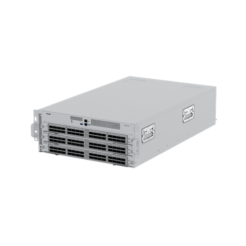

RG-S6910-3C – Data Center 100GE High-Density Modular Core Switch (Backward Compatible with 40GE) in the 4-RU Space
16 GB buffer that supports high-performance routing connections, and future evolution to 400GE data center network
Modelos
Características destacadas
  • Various ports, 100GE line cards, and up to 96 x 100GE ports
  • Hardware-level redundancy, ensuring service continuity
  • Telemetry-based network monitoring and automated O&M, making management simple and efficient
  • Support of IPv4/IPv6 dual-stack protocols, providing flexible networking
Especificaciones clave
View More
Funciones

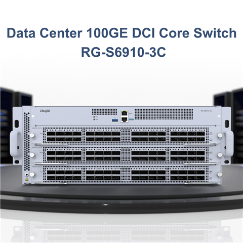

Data Center 100GE DCI Core Switch RG-S6910-3C
16 GB powerful buffer capability and buffer scheduling mechanism, providing a maximum of 96 x 100GE ports within 4 RU height,
which is suitable for DCI core scenarios in data centers
Support of high-performance routing connections, meeting future expansion needs of data center networks
Ports
Dimensions

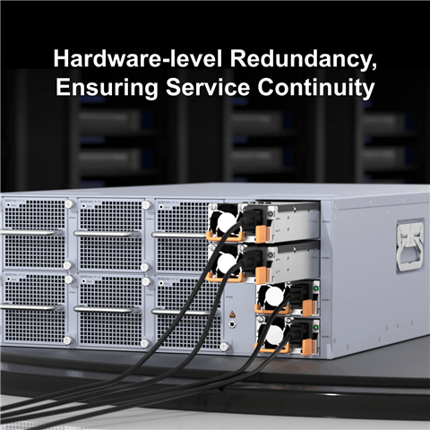

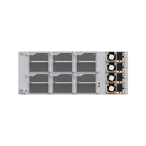

Hardware-level Redundancy, Ensuring Service Continuity
Hot-Swappable Redundant Power Modules
Hot-Swappable Redundant Fan Modules
Power modules in 2+2 redundancy mode, hot swapping, and failover in seconds, providing nonstop services

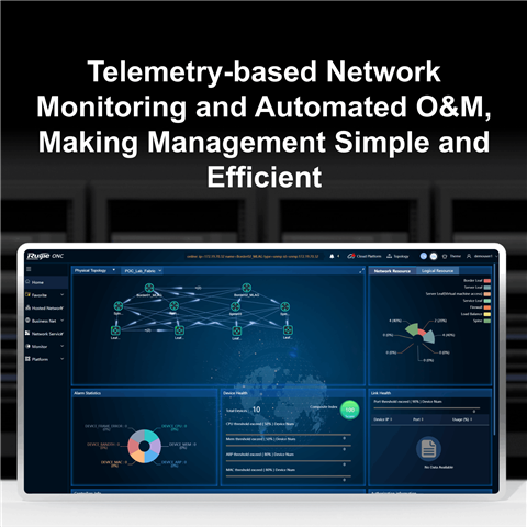

Telemetry-based Network Monitoring and Automated O&M,
Making Management Simple and Efficient
The switch enabled with telemetry provides clear data status and hierarchy.
The switch uses the push mode to proactively collect and push information and to provide sub-second-level network monitoring in real time,
making network management more efficient and accurate.

Item
RG-S6910-3C
Dimensions (W x D x H)
442 mm x 735 mm x 173.6 mm (17.40 in. x 28.94 in. x 6.83 in.)
Rack height
4 RU
Unit weight
22.9 kg (50.49 lbs., empty chassis)
32 kg (70.55 lbs., a chassis with four power modules and six fan modules)

Module slot
3 x expansion module slots
4 x power module slots
6 x  fan module slots

Power input
RG-PA1200I-F (AC input)
Rated input voltage: 100 V AC to 127 V AC, 200 V AC to 240 V AC, 50 Hz/60 Hz
Maximum input voltage: 90 V AC to 140 V AC, 180 V AC to 264 V AC, 47 Hz to 63 Hz
Rated input current: 13.8 A (100 V AC to 127 V AC)
8.5A (200 V AC to 240 V AC)
Power port type: C14
RG-PA1200I-F (HVDC input):
Rated input voltage: 240 V DC
Maximum input voltage: 180 V DC to 300 V DC
Rated current: 6.5 A
