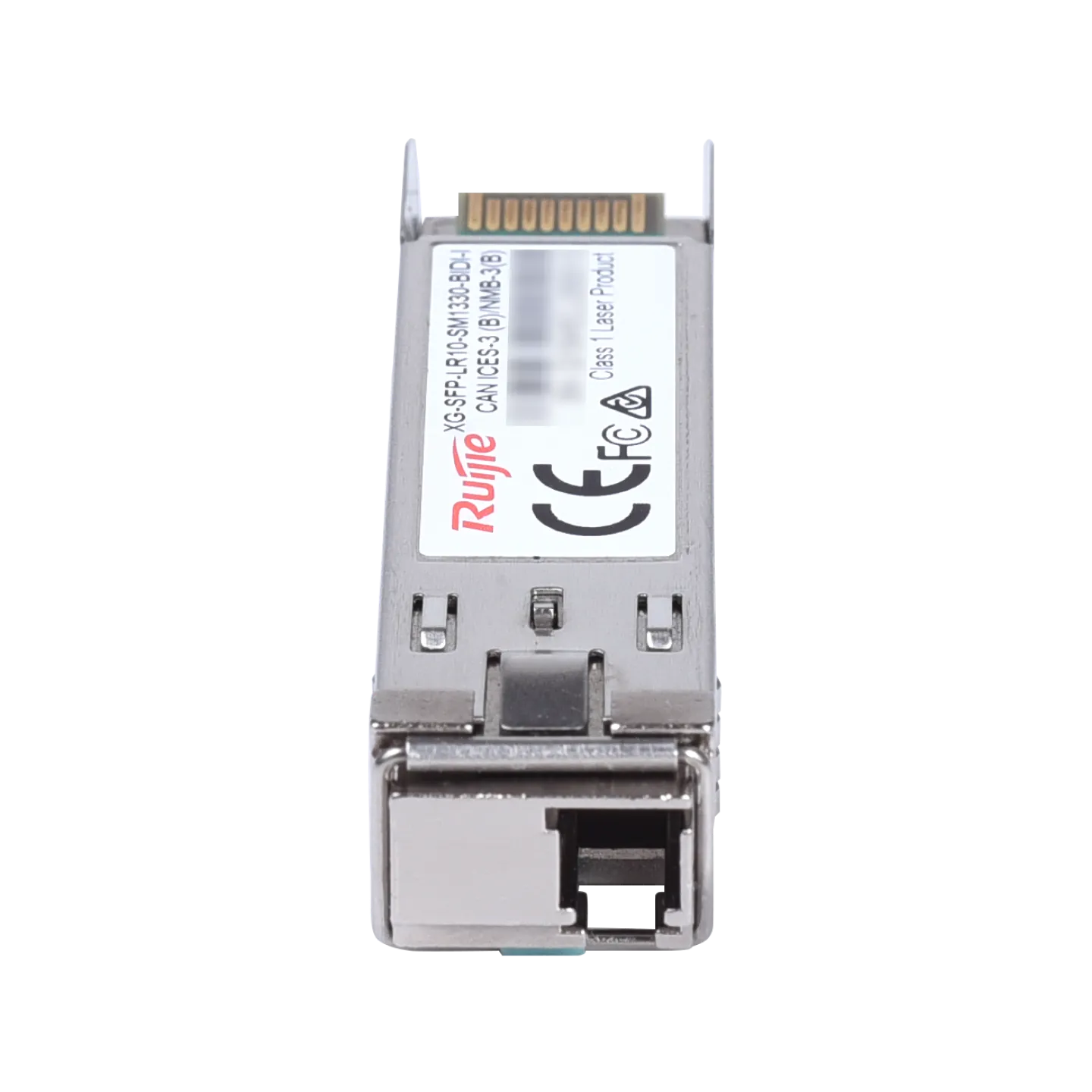

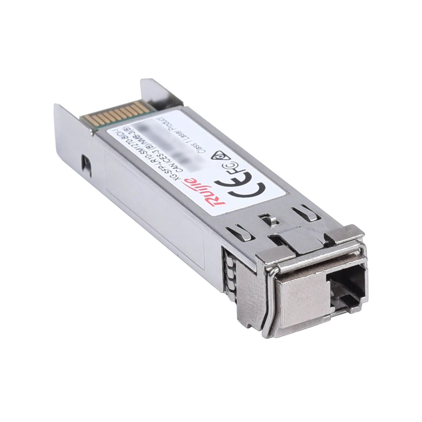

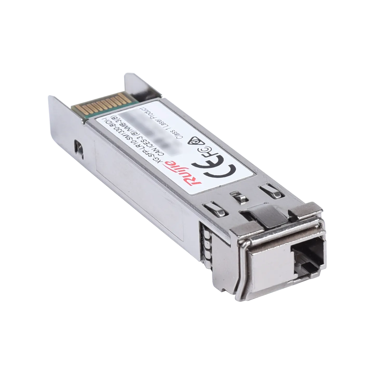

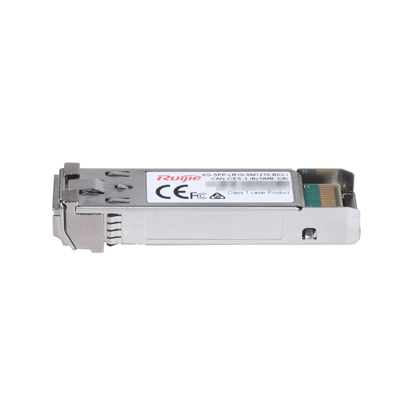

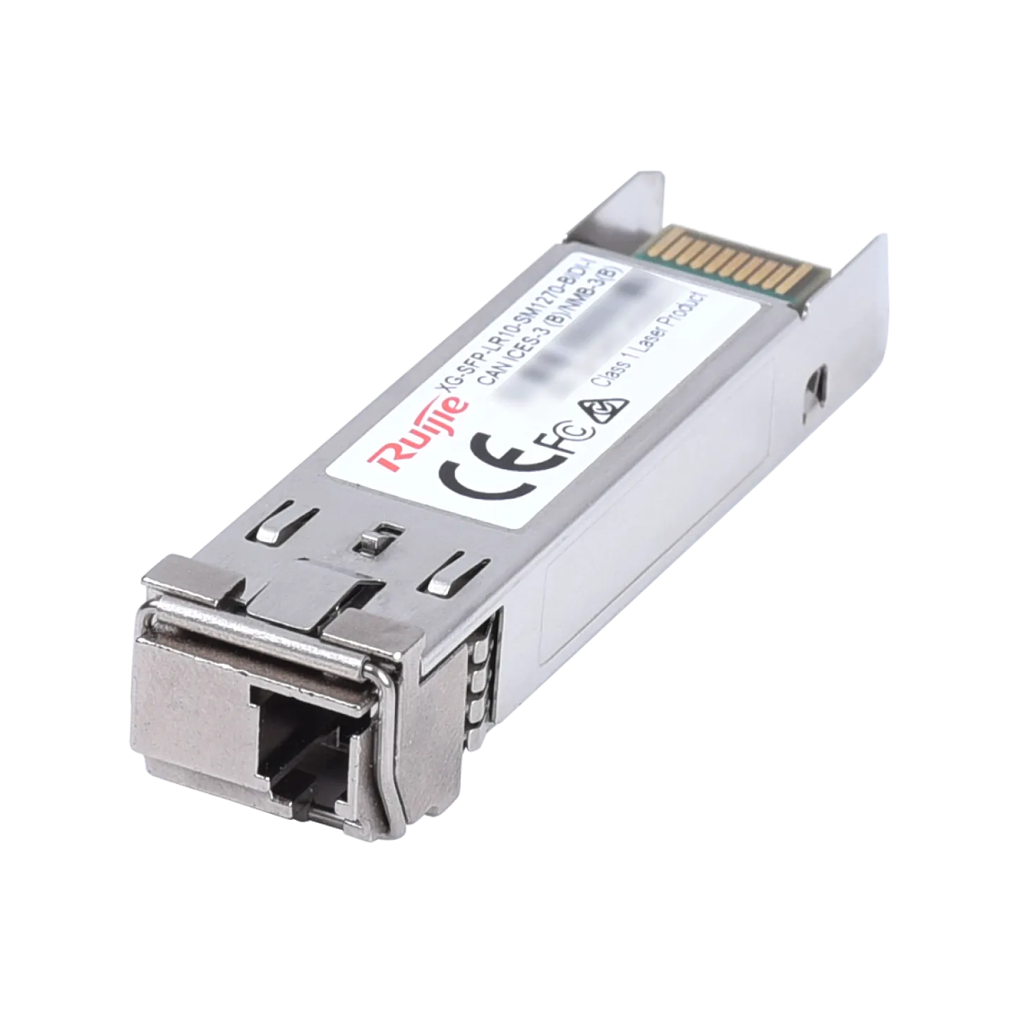

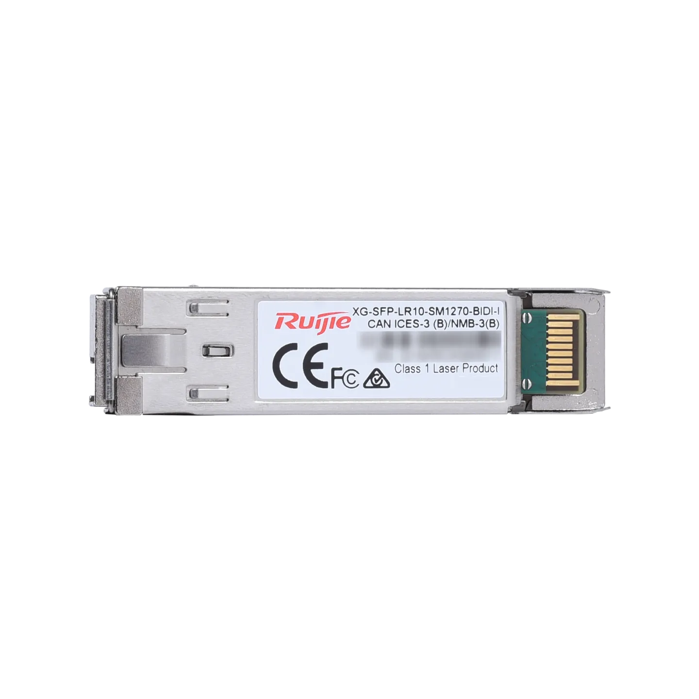

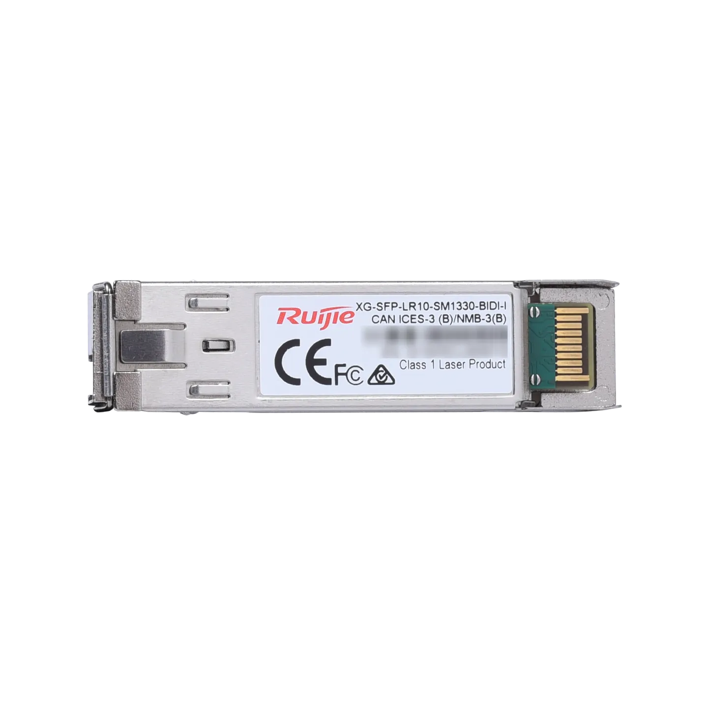

XG-SFP-LR10-SM1270-BIDI-I 10G BiDi SFP+ 1270nm-TX/1330nm-RX 10-km DOM Simplex LC SMF Transceiver Module
Applicable to data center and campus networks, enabling cost-effective, efficient, and high-speed interconnection
Modelos
Serie
Características destacadas
  • Max. power consumption 1.5 W
  • Hot pluggable SFP+ MSA compliant
  • Digital optical monitoring capability for strong diagnostic capabilities
  • Compliant with IEEE 802.3z Gigabit Ethernet
  • Class 1 Laser safety and RoHS compliant
Funciones
As an industry-leading ICT infrastructure and industry solution provider, Ruijie offers customers a wide variety of high-density and low-power 10G optical modules. They are applicable to data center and campus networks, enabling cost-effective, efficient, and high-speed interconnection among switches, routers, servers, and network interface controllers (NICs).
The XG-SFP-LR10-SM1270-BIDI-I is aligned to IEEE 10GBASE-LR optical specifications and supports a link length of up to 10 kilometers over an SMF with a BIDI LC connector. It adopts the SFP+ form factor and operates at a wavelength of 1270 nm. The transceiver conforms to the IEEE 802.3ae, SFF-8431, SFP+ MSA, and RoHS standards.
