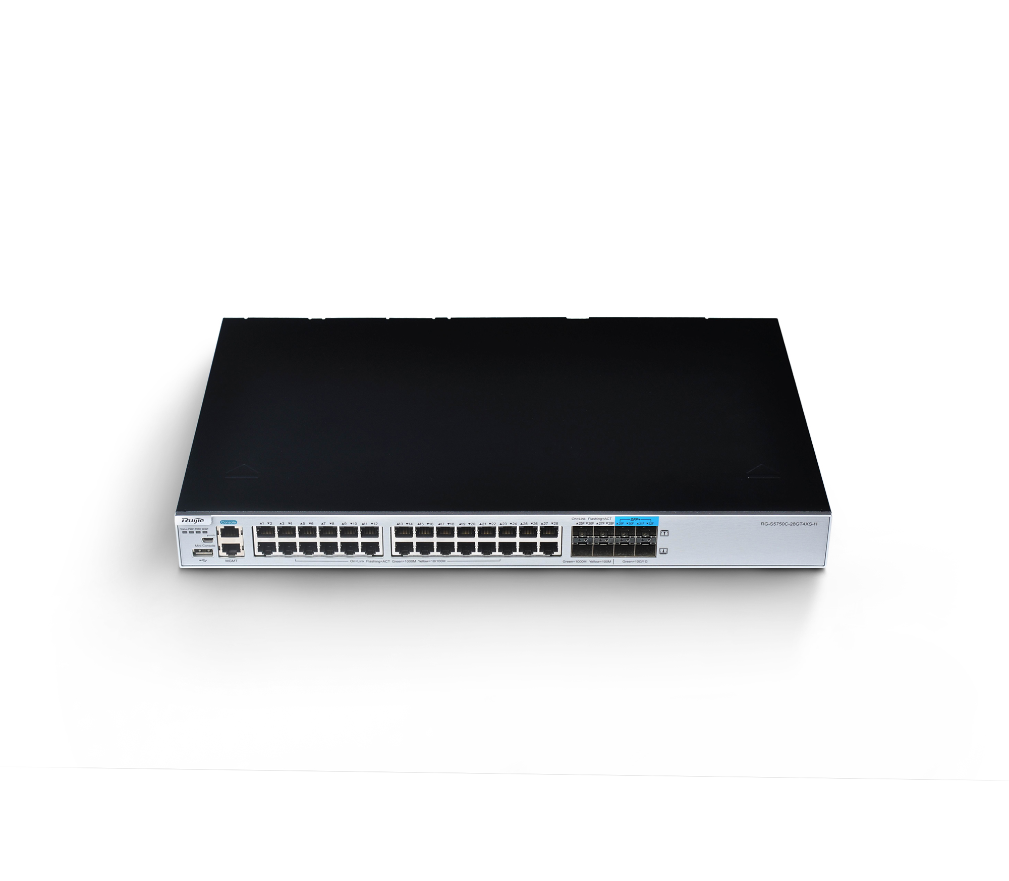

Product Model |
RG-S5750C-28GT4XS-H |
RG-S5750C-48GT4XS-H |
RG-S5750C-28SFP4XS-H |
RG-S5750C-48SFP4XS-H |
RG-S5750-48GT4XS-HP-H |
GE RJ45 port |
28 |
48 |
8 (Combo) |
n/a |
48 |
28 10/100/1000BASE-T ports, 4 100/1000BASE-X SFP ports (combo), 4 1G/10GBASE-X SFP+ ports, 2 extension slots, 2 modular power slots, required to purchase at least 1 power module |

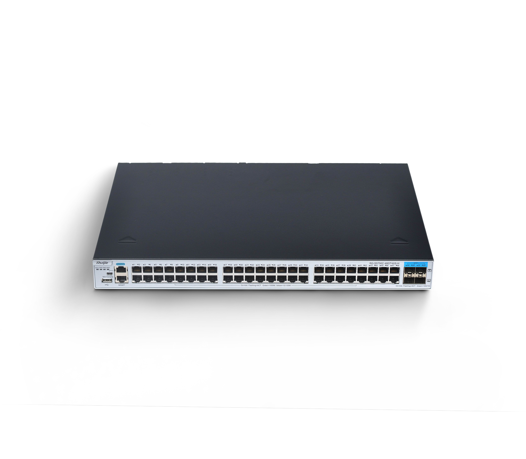

48 10/100/1000BASE-T ports, 4 1G/10GBASE-X SFP+ ports, 2 extension slots, 2 modular power slots, required to purchase at least 1 power module |

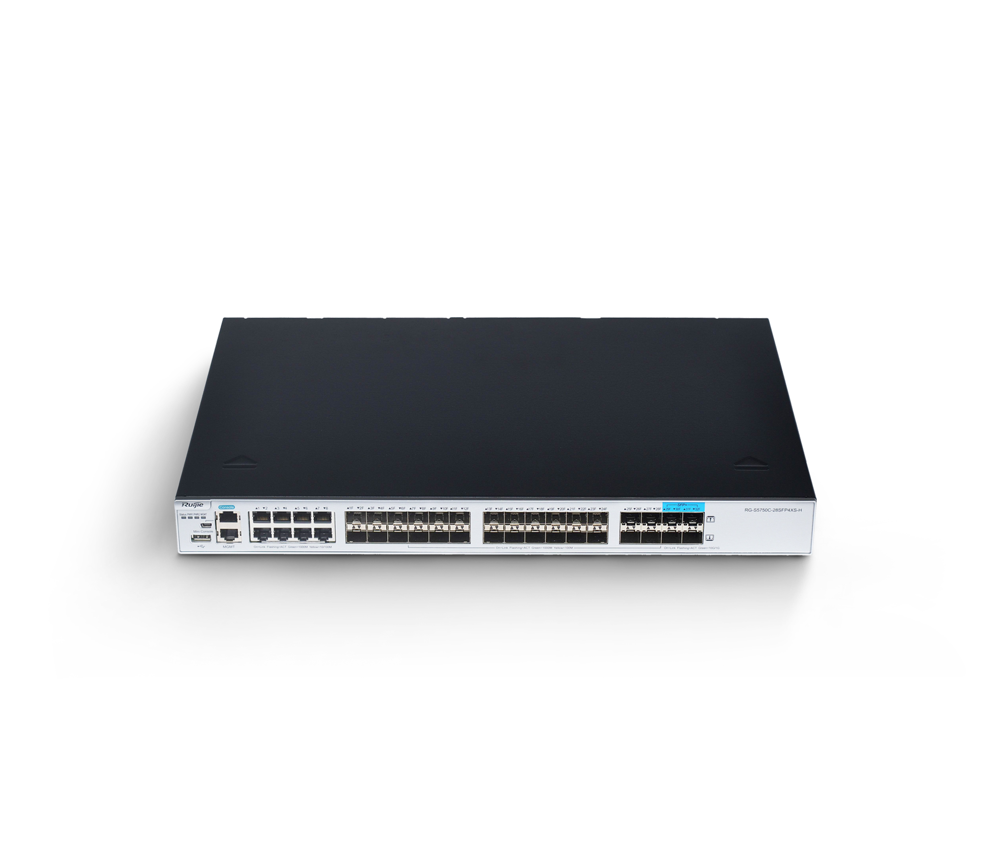

28 100/1000BASE-X SFP ports, 8 10/100/1000BASE-T ports (combo), 4 1G/10GBASE-X SFP+ ports, 2 extension slots, 2 modular power slots, required to purchase at least 1 power module |
