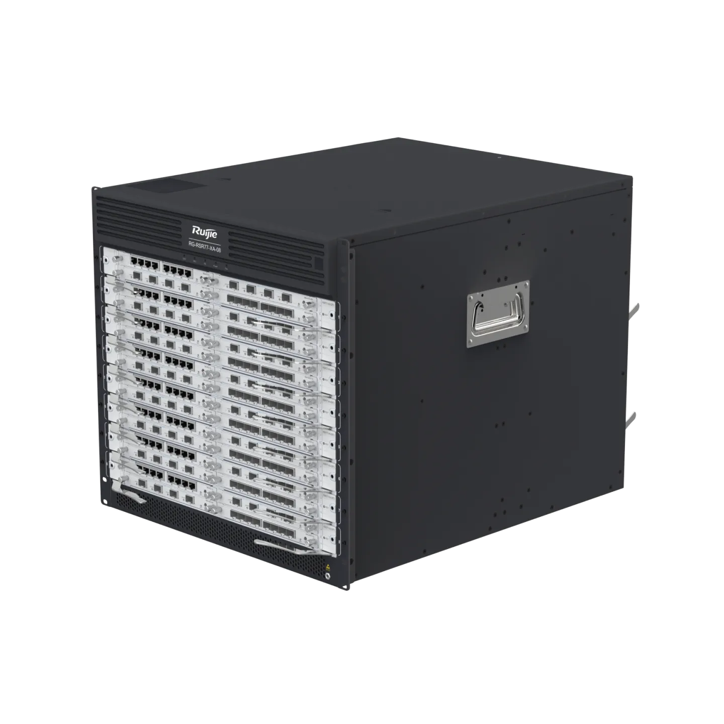

RG-RSR77-XA-08 10 RU Multiservice Core Modular Router
Mainly used as the core or aggregation node on a WAN of the government, finance, carrier, education, or large- and medium-sized enterprise network.
  • A modular design with various expansion card interfaces, supporting rates ranging from 2 Mbps to 100 Gbps
  • Support for Segment Routing over IPv6 (SRv6), simplifying protocol configuration and facilitating quick service rollout
  • Redundancy for critical components, ensuring uninterrupted services and improving overall reliability
  • Y-shaped airflow design, improving cooling efficiency and lowering energy consumption

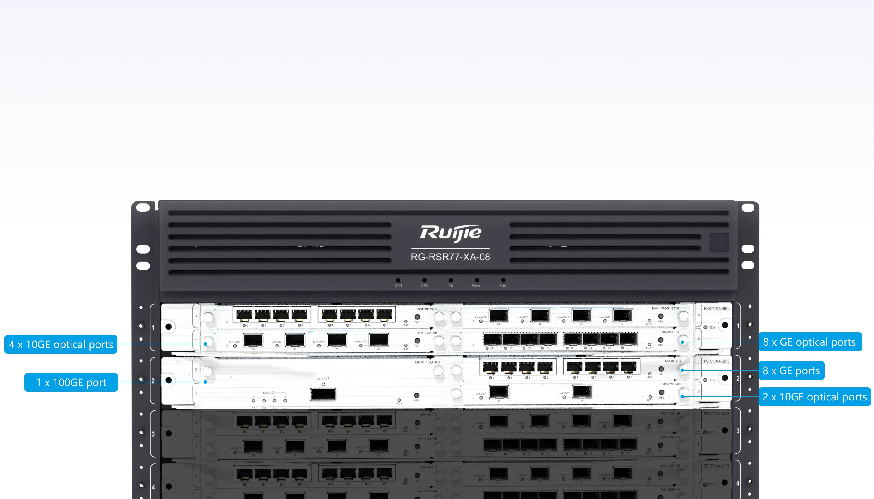

A Modular Design with Various Subcard Ports, Supporting Rates Ranging from 2 Mbps to 100 Gbps
Line cards include main cards and subcards. The subcards support multiple types of ports, including GE, 10GE, and 100GE ports. You can install subcards as needed to meet different networking requirements.

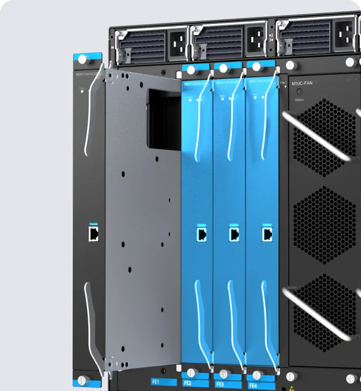

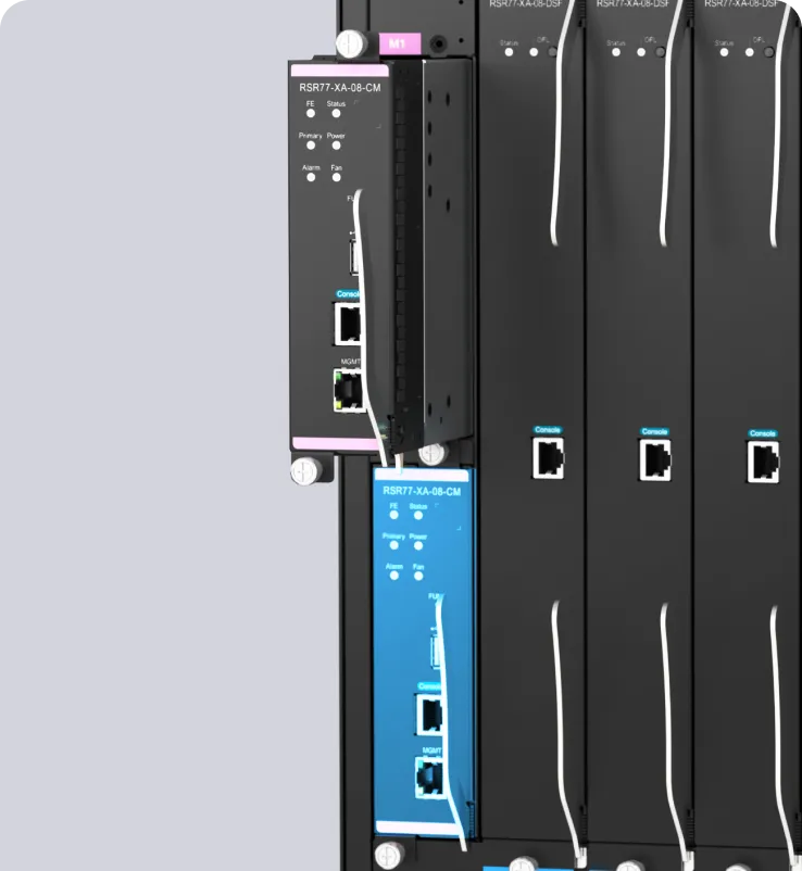

Redundancy for Critical Hardware Components, Ensuring Uninterrupted Services and Improving Overall Reliability
A redundant design is adopted for key components, such as the supervisor engine, switch fabric module, and power supply module. All modules support hot swapping, reducing the risk of device failures and service interruptions, and significantly enhancing system reliability.
1:1 Routing Engine Redundancy
If the active routing engine fails, data is switched to the standby routing engine within seconds.
3+1 Switching Fabric Module Redundancy
The router supports redundant and hot-swappable switch fabric modules, ensuring zero packet loss during failover scenarios.
N+M Power Supply Module Redundancy
The router supports AC/DC power supply redundancy and hot swapping, ensuring uninterrupted power supply.

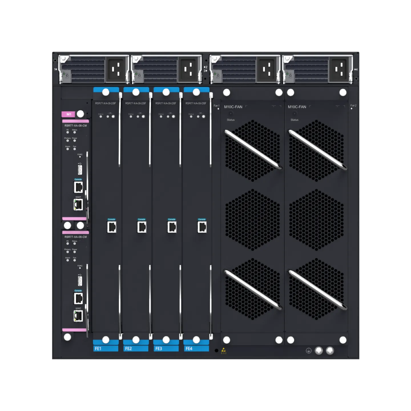

Module slot
2 x supervisor module slots
3 x modular line card slots(A maximum of 12 modular port adapters are supported.)
4 x power module slots
1 x fan module slot
8 x modular line card slots(A maximum of 32 modular port adapters are supported.)
4 x switch fabric module slots
2 x fan module slots
