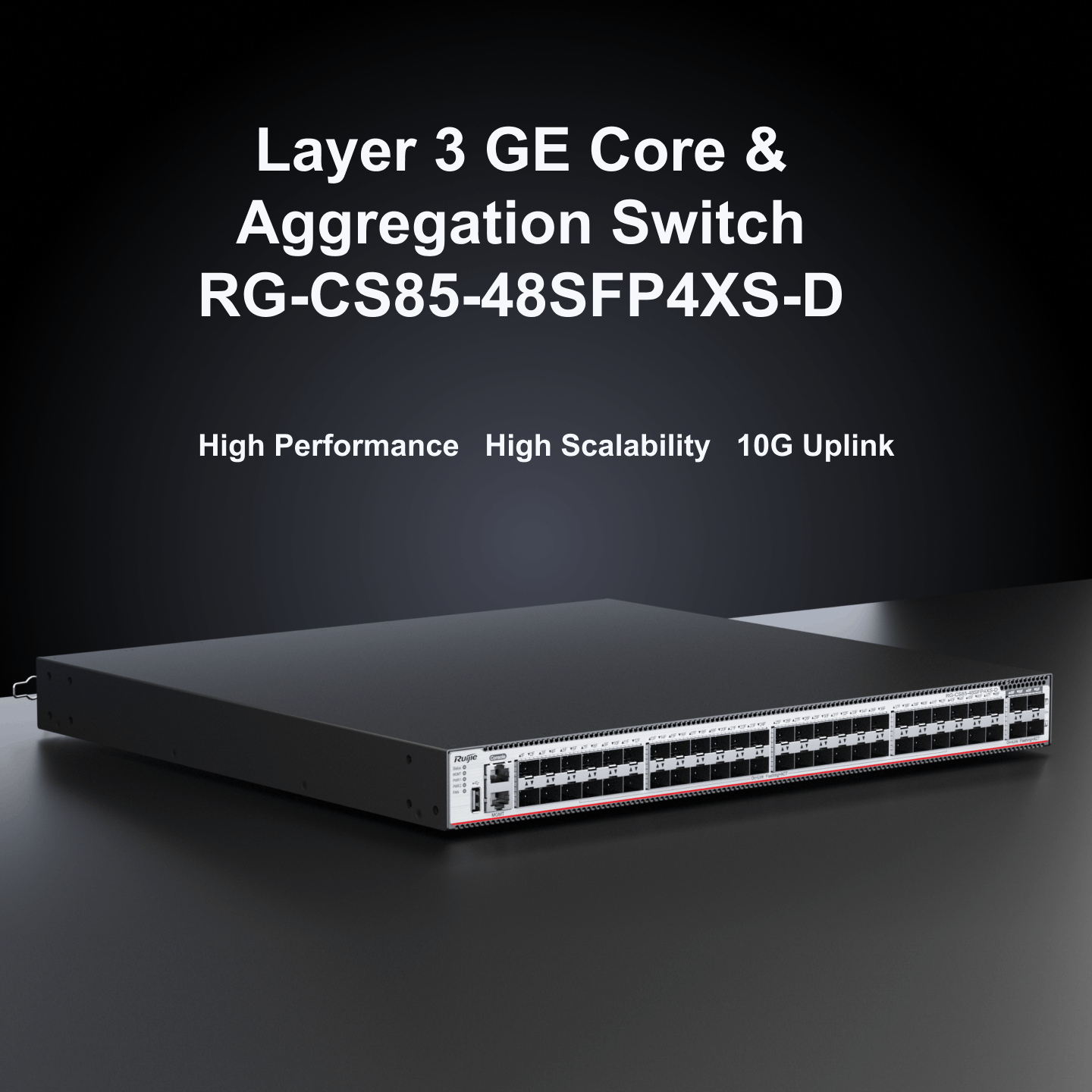

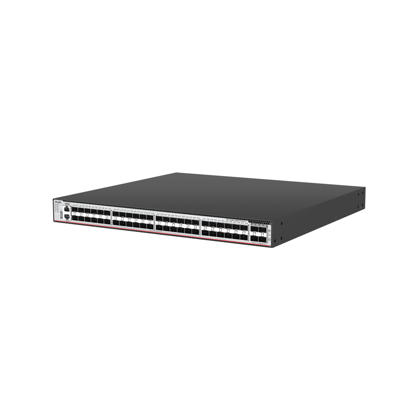

RG-CS85-48SFP4XS-D 48-Port 1GE SFP Layer 3 Enterprise-Class Core or Aggregation Switch, 4-Port 10GE Uplink
Aggregation switch for large-sized networks, or core switch for small and medium-sized networks
  • Rich port types, 48 x 1GE SFP ports, and 4 x 1GE/10GE SFP+ ports for uplink
  • Hardware redundancy, guaranteed service continuity and network connectivity
  • VSU virtualization, flexible networking and high reliability
  • Layer 3 routing control, adaptive to multiple services, efficient and guaranteed data transmission
  • Network security policies, real-time monitoring, CPP and NFPP, delivering enhanced network robustness
  • SNMP, RMON, Syslog, USB log backup features, CLI, Eweb, telnet and other management modes, simplified and easy network maintenance

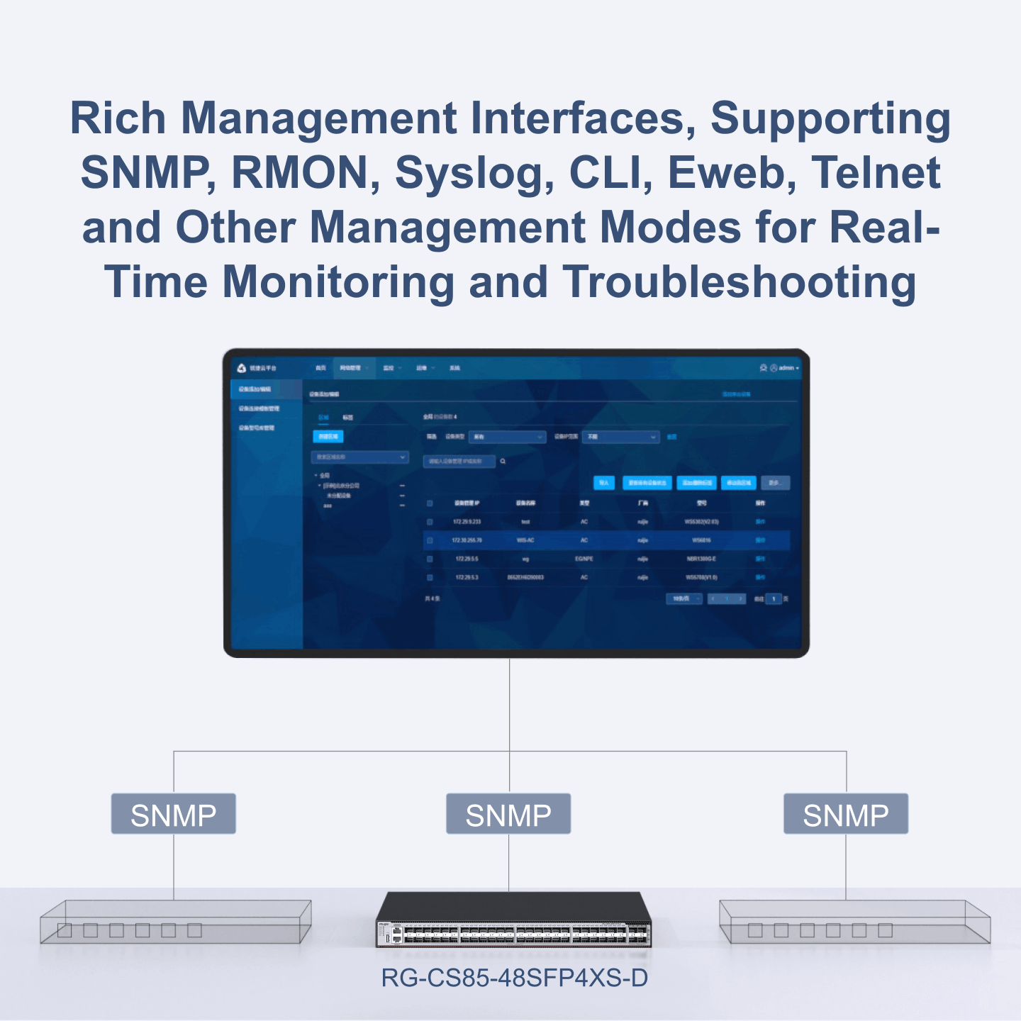

Ruijie Cloud and Diverse Management Modes Make Your Business Easy
Flexible management modes
SON, zero touch provisioning to Cloud
Configure VLANs on Ruijie Cloud APP
Monitor switch statistics at anytime anywhere
Ease of maintenance, saving onsite labor and cost

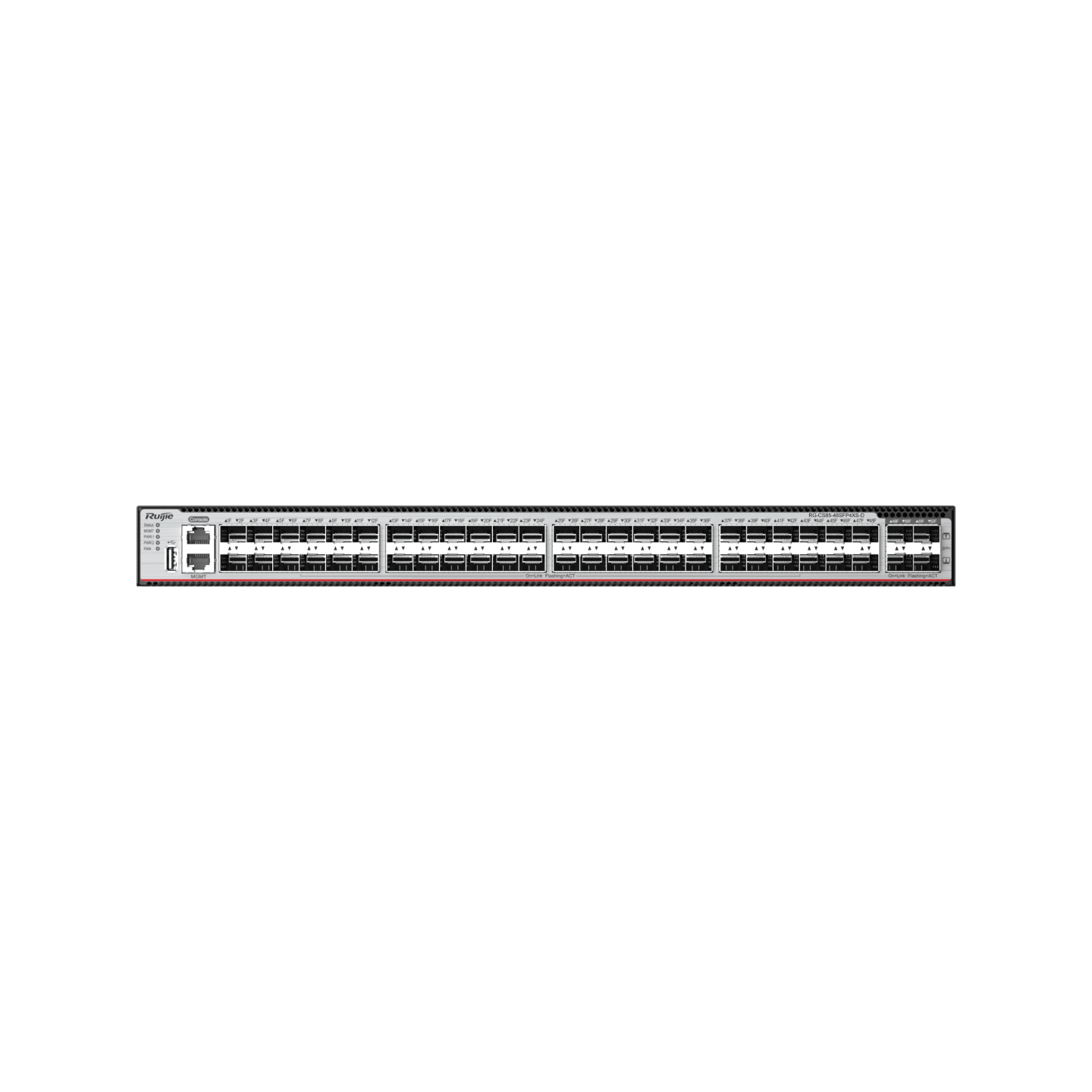

Fixed service port
24 x 10/100/1000BASE-T ports
8 x 1GE/10GE SFP+ ports
24 x 1GE SFP ports
● Ports 1 to 16 support the rate of 100Mbps, ports 17 to 24 do not support the rate of 100Mbps
● Ports 1 to 8 are 10/100/1000BASE-T combo ports
48 x 10/100/1000BASE-T ports
48 x 1GE SFP ports

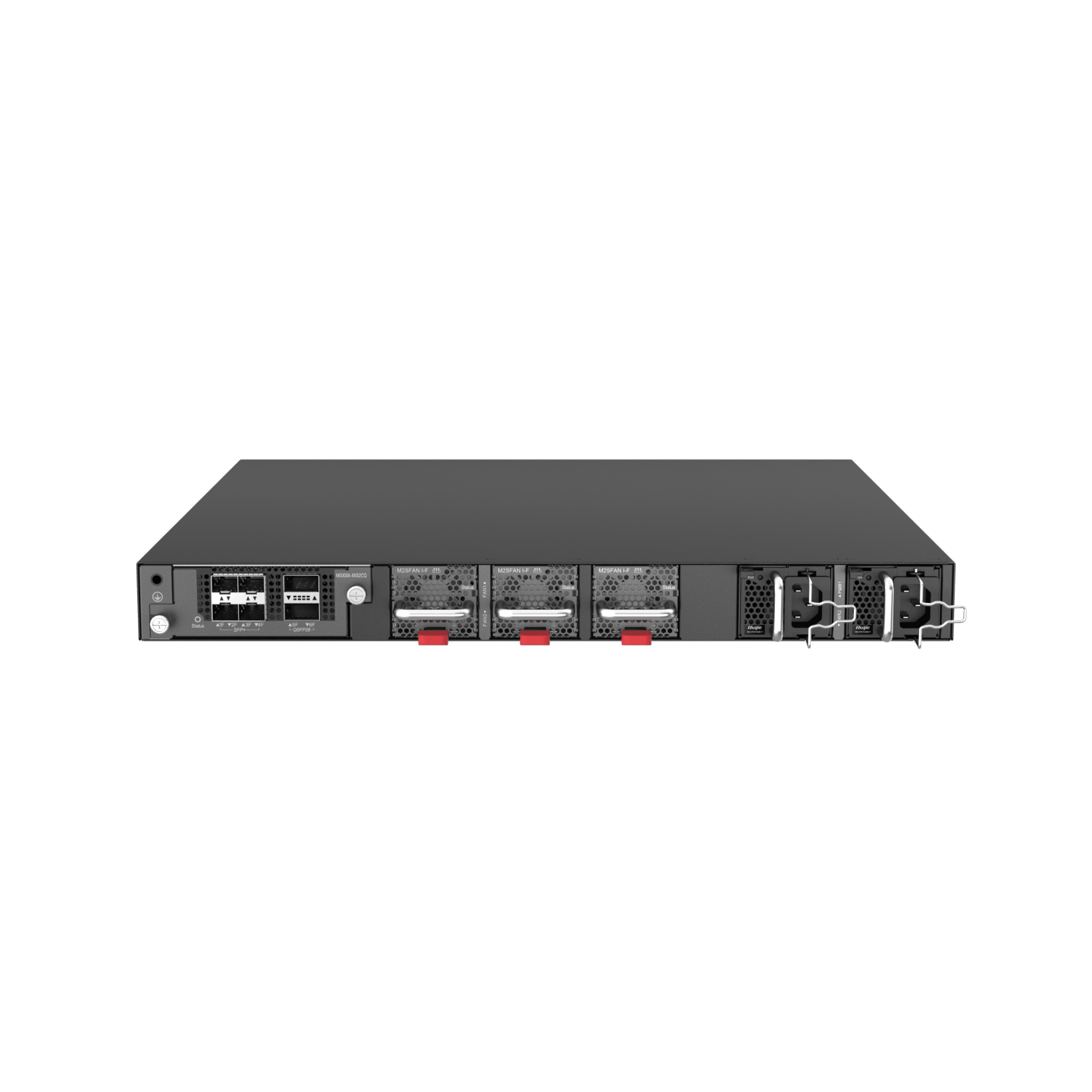

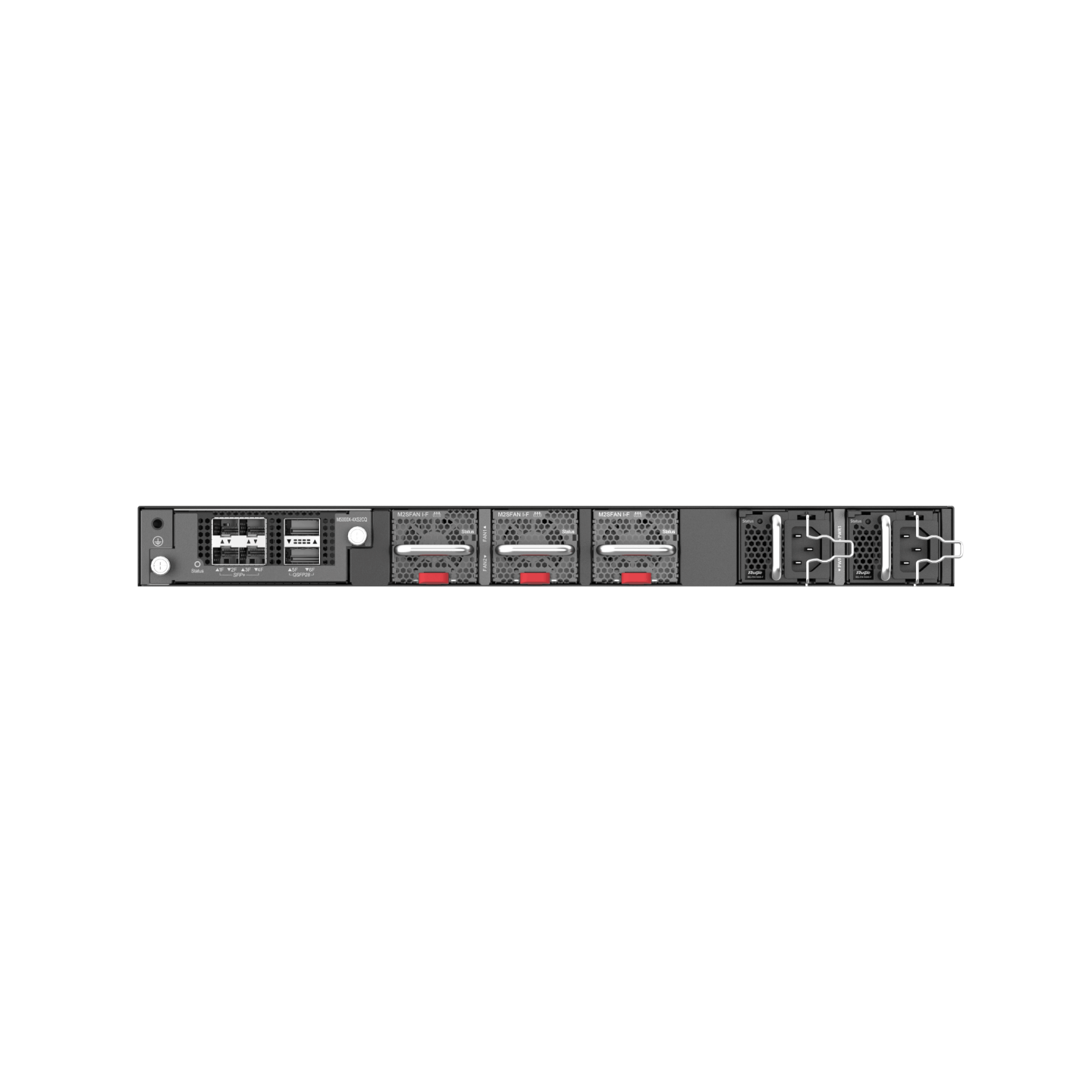

Module slot
1 x expansion module slot
2 x power module slots
3 x fan module slots
2 x fan module slots
Expansion module
CM85-4XS2CQ
Power module
RG-PA150IB-F
RG-PA150IB-F
RG-PA150IB-F
RG-PA150IB-F
RG-PA600I-P-F
RG-PA1000I-P-F
Fan module
M2SFAN I-F (pre-installed 3)
M2SFAN I-F (pre-installed 2)

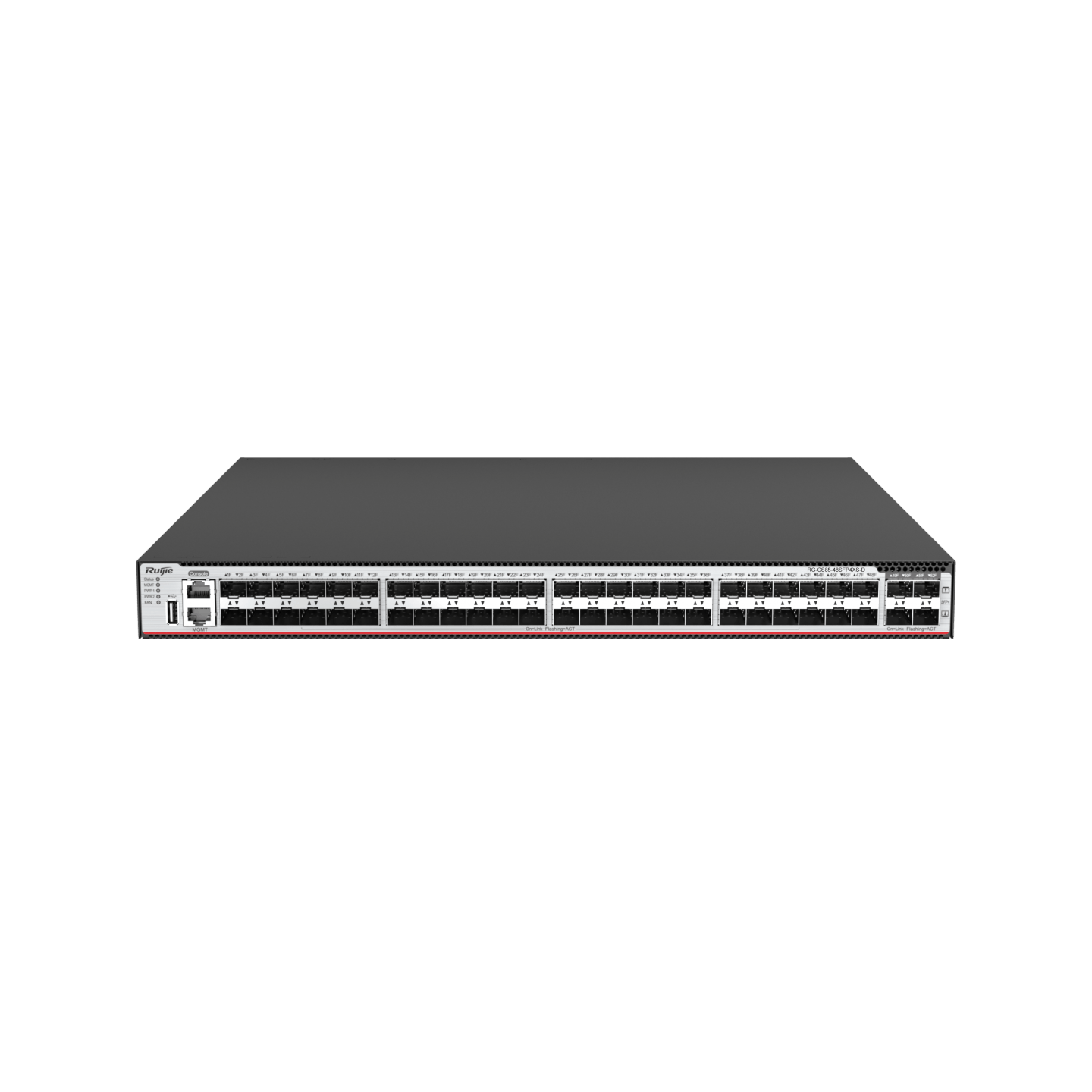

Unit dimensions
(W x D x H)
440 mm x 340 mm x 44 mm
(17.32 in. x 13.39 in. x 1.73 in.)
442 mm x 420 mm x 43.6 mm (17.40 in. x 16.54 in. x 1.72 in.)
