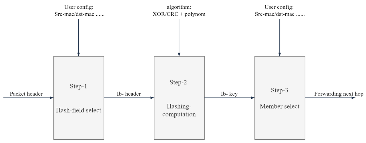

Step 1: Selection of HASH Factor
First, the data packet forwarding queries the routing table to confirm that there are multiple equal-cost routes and then extracts the key fields involved in the HASH calculation, namely the HASH factor, according to the traffic balancing algorithm currently configured by the user. The HASH factors that can be selected for ECMP traffic balancing are as follows:

Step 2: HASH calculation
HASH factor extracted in step 1, the corresponding HASH lb-key (load-balance key) is calculated according to the HASH algorithm. The HASH algorithms supported by ECMP traffic balancing include XOR, CRC, CRC+ scrambling, etc.

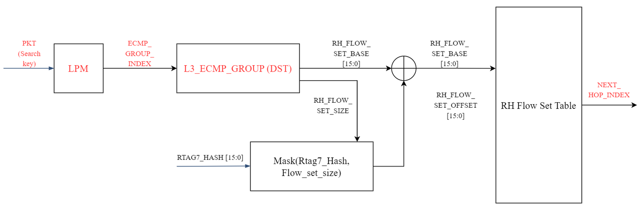

Step 3: Confirm the next forwarding hop
After the data message passes through the routing table lookup, the corresponding ECMP base value (base-ptr) is found. After the HASH lb-key is obtained through the HASH algorithm according to the HASH factor, the ECMP next-hop link number (Member-count) is calculated, and then the addition operation is performed with the ECMP base value to obtain the forwarding next-hop index, which determines the next-hop forwarding route.
Calculation formula: Next-hop = (lb-key % Member-count) + base-ptr

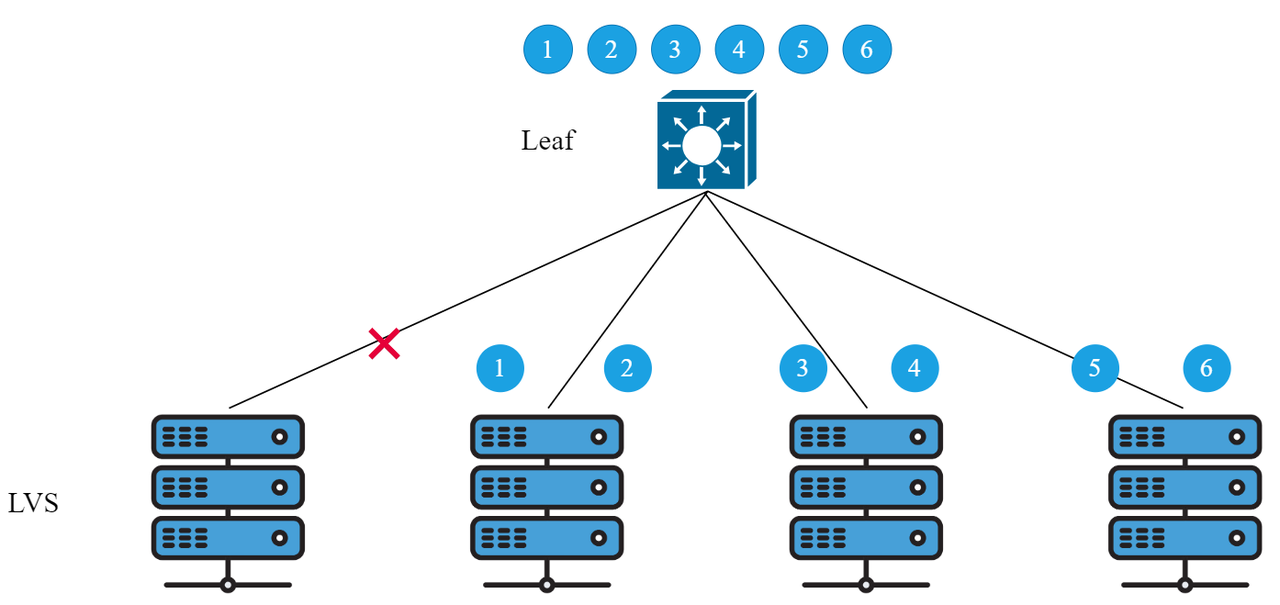

Problem 1: A single link failure causes all data flows in the ECMP group to be re-hashed
When the Leaf switch sends 6 data streams to the LVS server, the Leaf first performs HASH calculations and load balances them to each LVS server. Normal traffic forwarding is shown in Figure 2:
▲ Fig 2: ECMP forwarding diagram
When a certain LVS server network card fails or a link fails, the Leaf switch will re-hash the data flow in the ECMP group and then load balance it to the remaining valid links, which will cause the TCP session to be disconnected and an avalanche phenomenon to occur. For example, in some payment services, the payment process of the same user will call multiple business services. The business side requires that the payment process should fall on the same processing server. When a single link fails, it will not only affect the users carried by the LVS where the link is located but also affect the users carried by other LVS in the ECMP group, as shown in Figure 3:

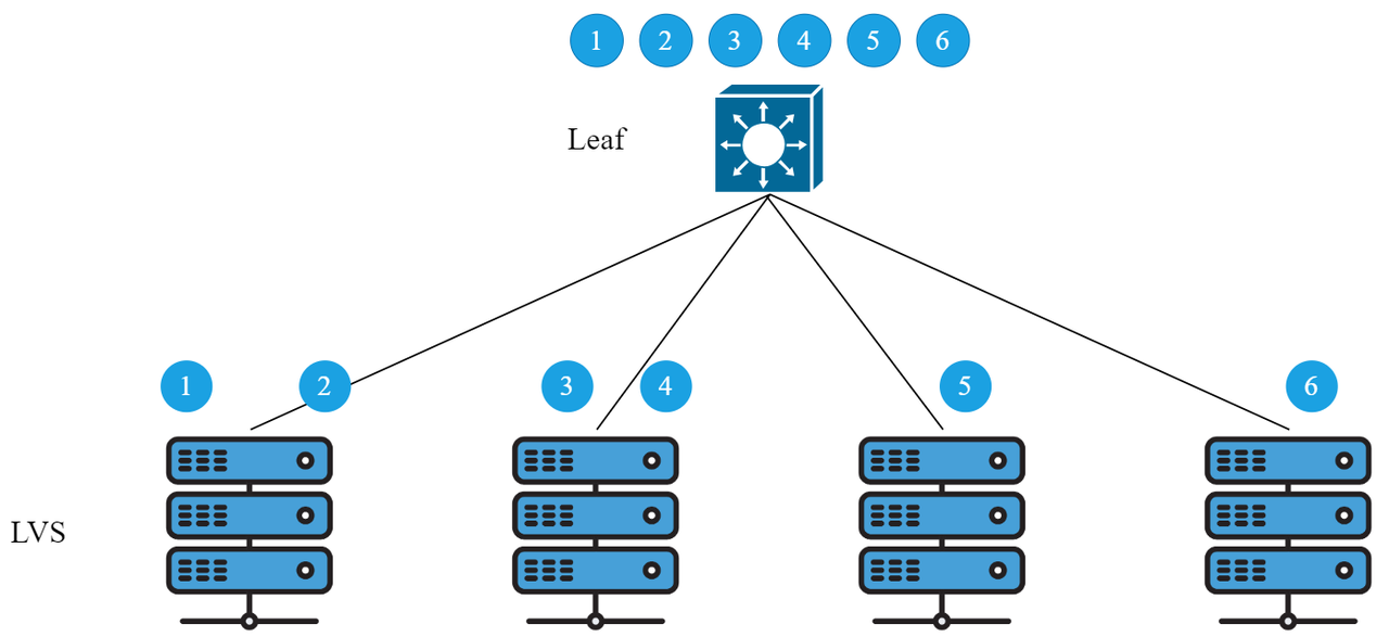

Optimization plan:
To prevent a single LVS server failure or a single link failure from causing the entire ECMP group traffic to be re-hashed, ECMP can use an elastic HASH algorithm for optimization. After using the elastic HASH algorithm, only the traffic on the failed link is re-hashed to other active links, while the data flow on the non-faulty link does not need to change the next hop. The implementation effect is shown in Figure 4:
▲Fig 4: ECMP elastic HASH algorithm

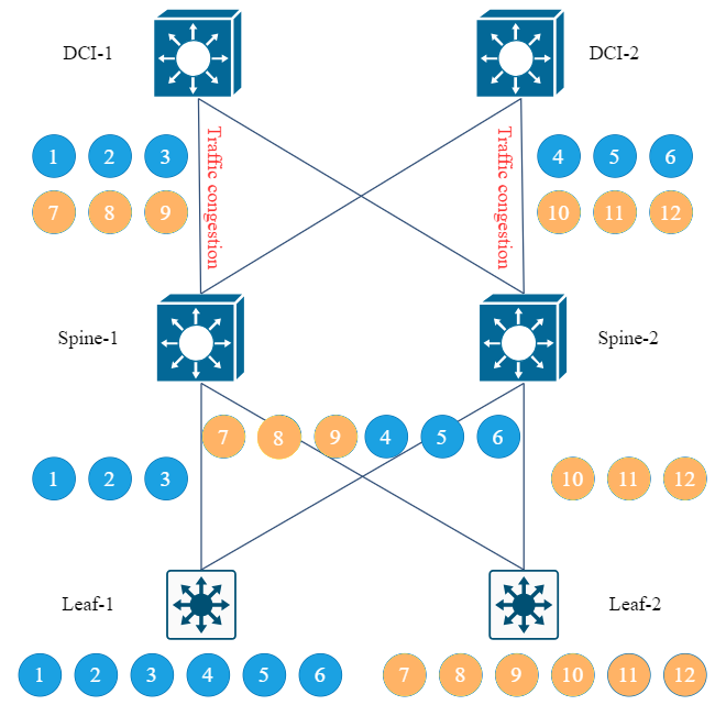

Problem 2: HASH polarization problem
As shown in Figure 7, when both Leaf devices and Spine devices use an even number of uplink links and the ECMP algorithm and HASH factor are consistent, the data flow undergoes a HASH calculation on the Leaf device, and the data flow load is shared among the two Spine devices. After balancing, data flows 1, 2, and 3 are forwarded to Spine-1, and data flows 4, 5, and 6 are forwarded to Spine-2. The spine then performs HASH calculation to share the load among the two DCI cores. Because the HASH algorithm used in the Spine layer is consistent with the HASH algorithm of the Leaf, Finally, data streams 1, 2, and 3 of Spine-1 are all forwarded to DCI-1 and are not load-balanced to any data stream on DCI-2. Data streams 4, 5, and 6 of Spine-2 are all forwarded to DCI-2 and are not load-balanced to any data stream on DCI-1. The same is true for the data stream sent by Leaf-2, which leads to the HASH polarization problem. As a result, one link between SPINE and DCI is idle, which greatly wastes network resources and even causes traffic congestion.
▲Fig 7: HASH polarization
Optimization plan:
When Leaf devices and Spine devices from the same manufacturer use the same number of uplink links, avoid using the same load-balancing algorithm on two adjacent devices.

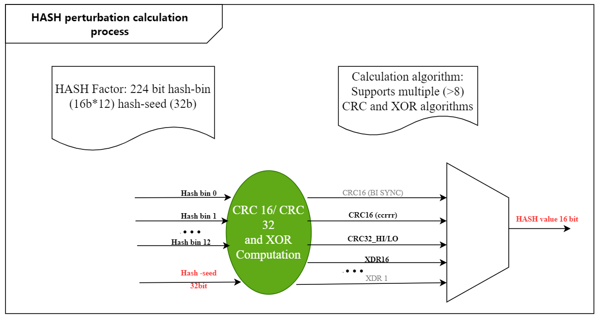

When the device is running HASH calculation, in addition to the traditional five-tuple, a disturbance factor can be added to avoid the same HASH calculation results.
During the calculation of HASH disturbance, the HASH factor is still extracted normally, and then the user-defined random disturbance factor is added. After the HASH algorithm is calculated, the HASH calculation results of different switches will be inconsistent, so as to avoid the occurrence of HASH polarization.
