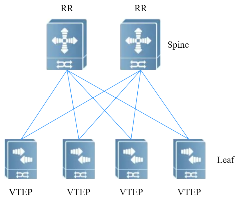

Next, let's take a look at the specific implementation solution based on EVPN+VXLAN. The network architecture is shown in the following figure:
▲ Figure 1 Physical network architecture

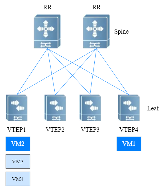

Optimization point 2: ARP-TO-HOST
▲ Figure 2 Service model
As shown in the figure above, assuming that VM1-4 belongs to the same subnet, this situation may occur due to business deployment or virtual machine migration. If VETP1 and VTEP4 publish network segment routes, due to the existence of ECMP, some traffic to VM1 will bypass VTEP1->VTEP4.
In order to solve this problem, detailed routing or host routing is needed. If you want to configure it manually, the workload is large and it is easy to make mistakes. Currently, a common method is to automatically generate host routing through ARP and publish it to the network.
Implementation method: After the gateway turns on ARP-TO-HOST, the host route is automatically generated according to the ARP table and automatically published to the network.
