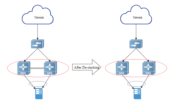

 When multiple switches in the network are virtualized into one device through stacking, network operation and maintenance personnel only need to manage one device instead of multiple devices. Although the number of ports that need to be managed has not decreased, the operation time of frequently logging into different devices has been reduced, and some corresponding port configurations have also changed, which simplifies the overall management cost. As shown in Figure 1:
▲ Figure 1
Originally, network management required the maintenance of four network devices. After stacking the access layer devices through stacking technology, now only one network device needs to be maintained.

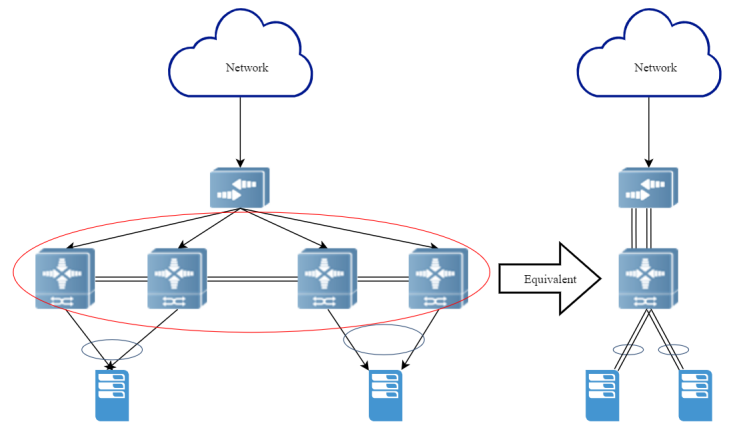

When the number of access terminals increases to the point where the port density of the original switch cannot meet the access requirements, you can add a new switch to form a stacking system with the original switch, as shown in Figure 2:
▲ Figure 2

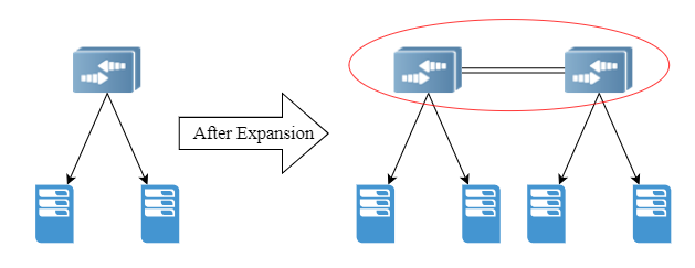

When the forwarding capacity of the core switch cannot meet the demand, you can add a new switch to form a stacking system with the original switch, as shown in Figure 3:
▲ Figure 3

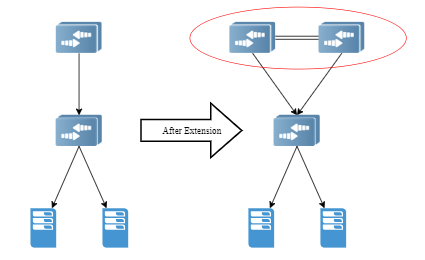

Due to cost control issues, box-type devices are generally designed with only a single CPU and a single switching chip. When a single CPU fails, the entire device will become unavailable, which is a high risk. If stacking technology is used, it is equivalent to forming a frame-type device, and at the same time has more spare main control boards and interface boards, as shown in Figure 4:
▲ Figure 4
The Master in the stack is equivalent to the main control board of the virtual device, and the Slave device is comparable to the backup main control board.

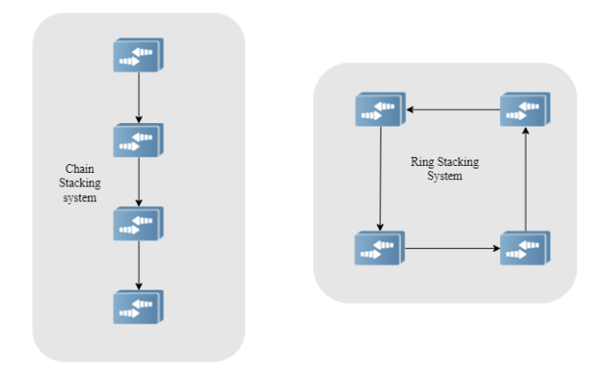

The stacking system supports two physical topologies: chain connection and ring connection, as shown in Figure 5:
▲ Figure 5
Chain stacking requires at least one less stacking line than ring stacking, which is more cost-effective.
Ring stacking has higher availability because the stacking system will not be disrupted if any line is disconnected.

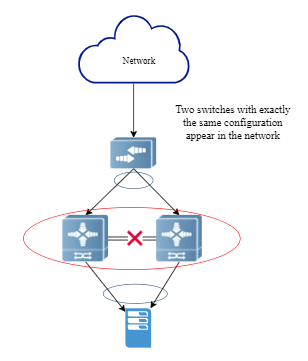

2. Risk of Split

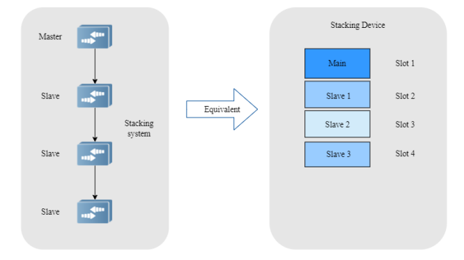

When the stacking line connecting the switches fails or is abnormal, the stack will split. Although it is not common, it still happens in actual operation. The problem is that after the split, it is equivalent to two switches with the same configuration appearing in the network, causing network configuration conflicts and ultimately interrupting the services carried by the stacking system. As shown in Figure 6:
▲ Figure 6
There is a solution to this problem. Once the system detects a split, it shuts down all ports except the stacking port, management port, and the exception port specified by the administrator to prevent the network from being affected after the split. Although this method avoids the situation where two switches with the same configuration appear in the network, the cost is obvious. The service recovery operation becomes complicated and the remote recovery operation becomes extremely difficult.
