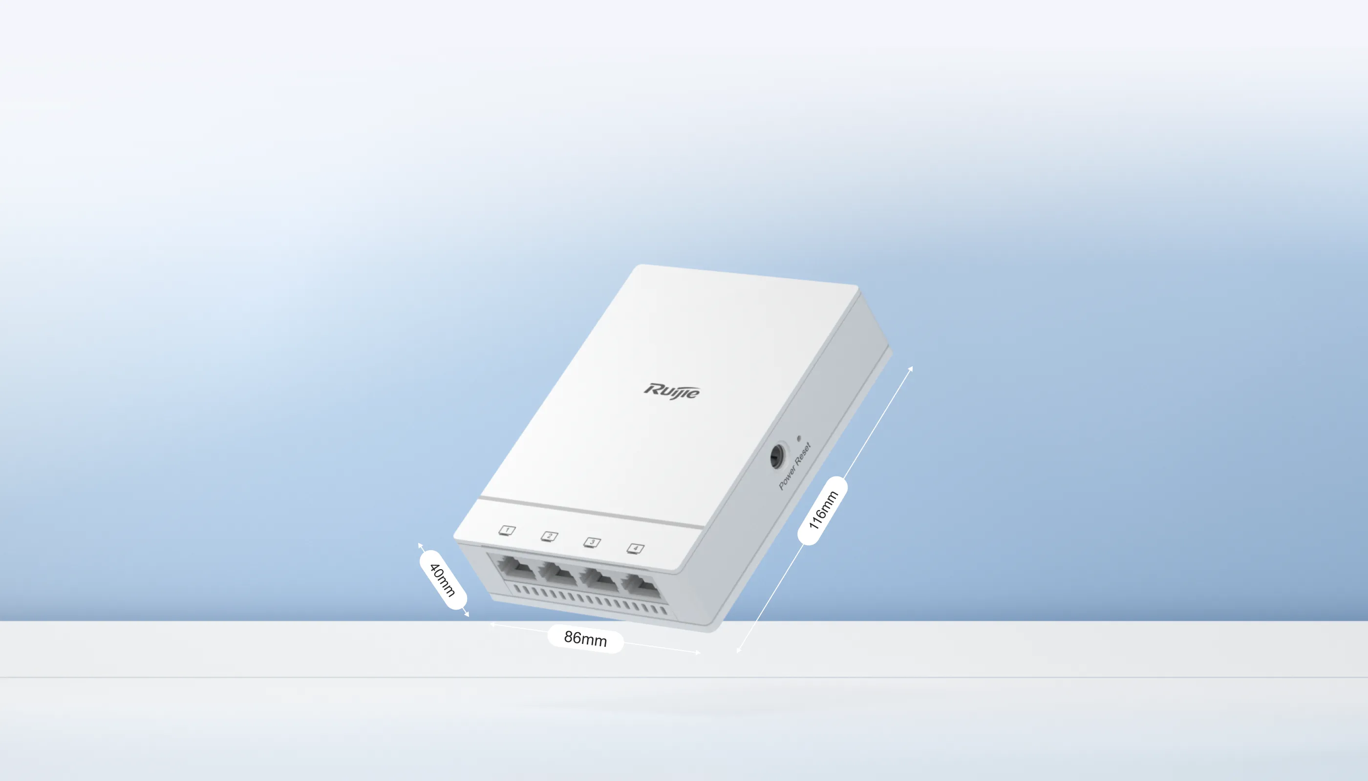

RG-AP180, Wi-Fi 6 Dual Radio 1.775 Gbps Indoor Wall Plate Wireless AP
Recommended for indoor scenarios such as dormitories, offices, hotels, stores, and classrooms
  • Multi-service Linkage, All-in-One for Office Scenarios
  • 1.775 Gbps Ultra-Fast Speed with Wi-Fi 6
  • Full-Scenario Enterprise-class Authentication for Enhanced Security
  • Ruijie Cloud Management, Intelligent Optimization, and Easy O&M

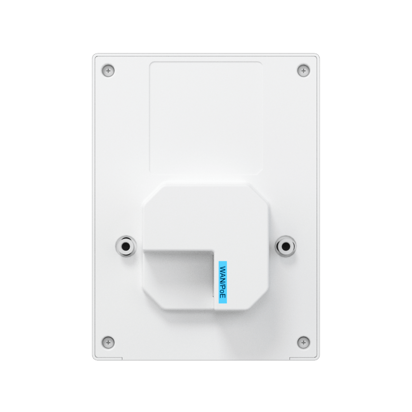

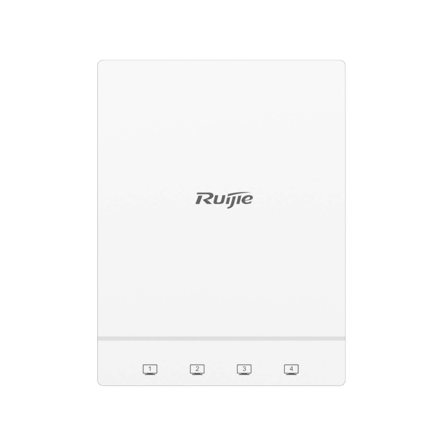

RG-AP180 Indoor Wall Plate Wireless Access Point
Port
Scenario
2.4 GHz and 5 GHz Dual Radios
Four Spatial Streams
PoE and DC Power Input
Combined Rate Up to 1.775 Gbps
Max. Power Consumption of 10 W

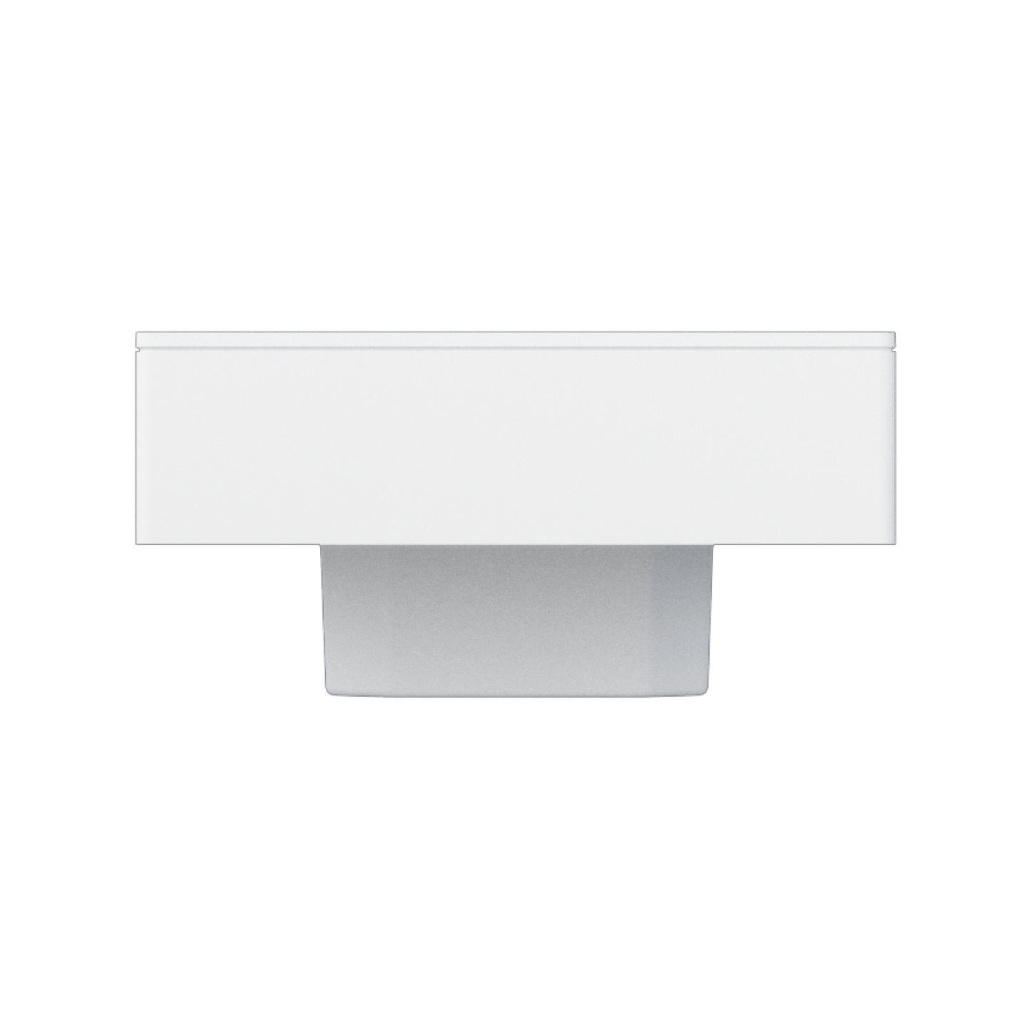

Unit dimensions
(W x H x D)
In-wall: 86 mm x 116 mm x 19 mm (3.39 in. x 4.57 in. x 0.75 in.)
Above-wall: 86 mm x 116 x mm x 24 mm (3.39 in. x 4.57 in. x 0.94 in.)

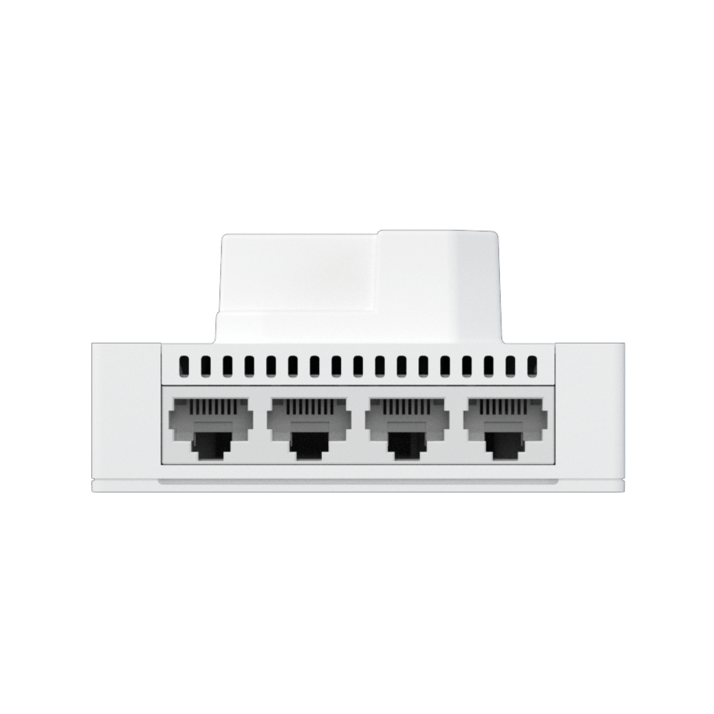

Uplink:
1 x 10/100/1000BASE-T port, in compliance with IEEE 802.3af/802.3at standard (PoE/PoE+).
Downlink:
4 x 10/100/1000BASE-T ports

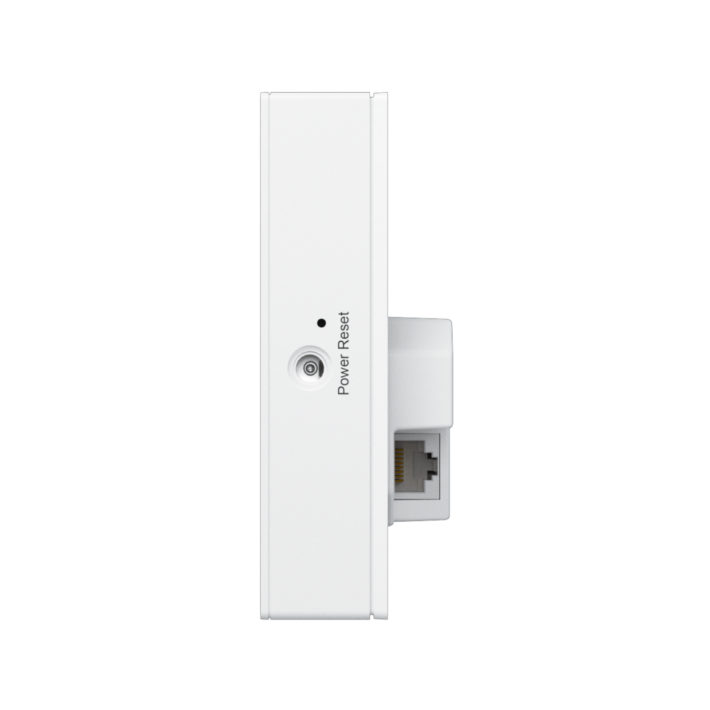

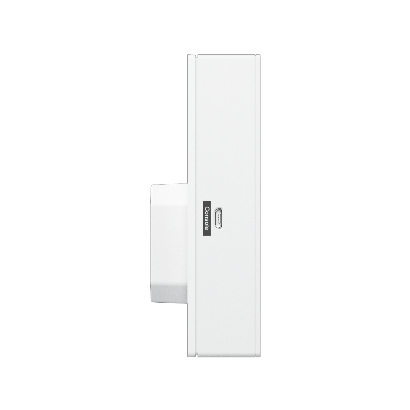

1 x Micro USB console port (under the decorative cover)
Status LED
Button
1 x Reset button
● Press the button for longer than 3 seconds. Then the device restores to factory settings.
