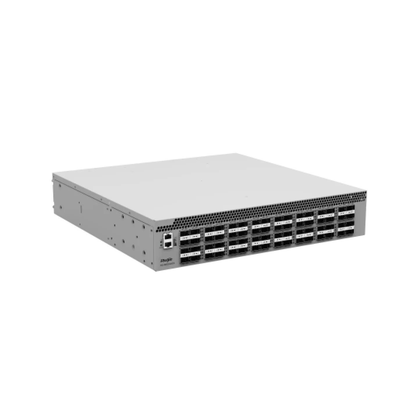

RG-S6520-64CQ 100GE Data Center Access Switch
Recommended for large-scale Spine-Leaf three-tier DCI scenarios, M-LAG/VSU/de-stacking for higher availability
Modelos
Características destacadas
  • 64 x 100GE QSFP28 ports housed in a 2 RU enclosure
  • Cross-device link aggregation (De-stacking/M-LAG/VSU), device-level redundancy, flexible networking, and high reliability
  • Lossless Ethernet, ensuring zero packet loss during RDMA E2E communication
  • Telemetry/gRPC/sFlow/SPAN-based network monitoring and automated O&M, making management simple and efficient

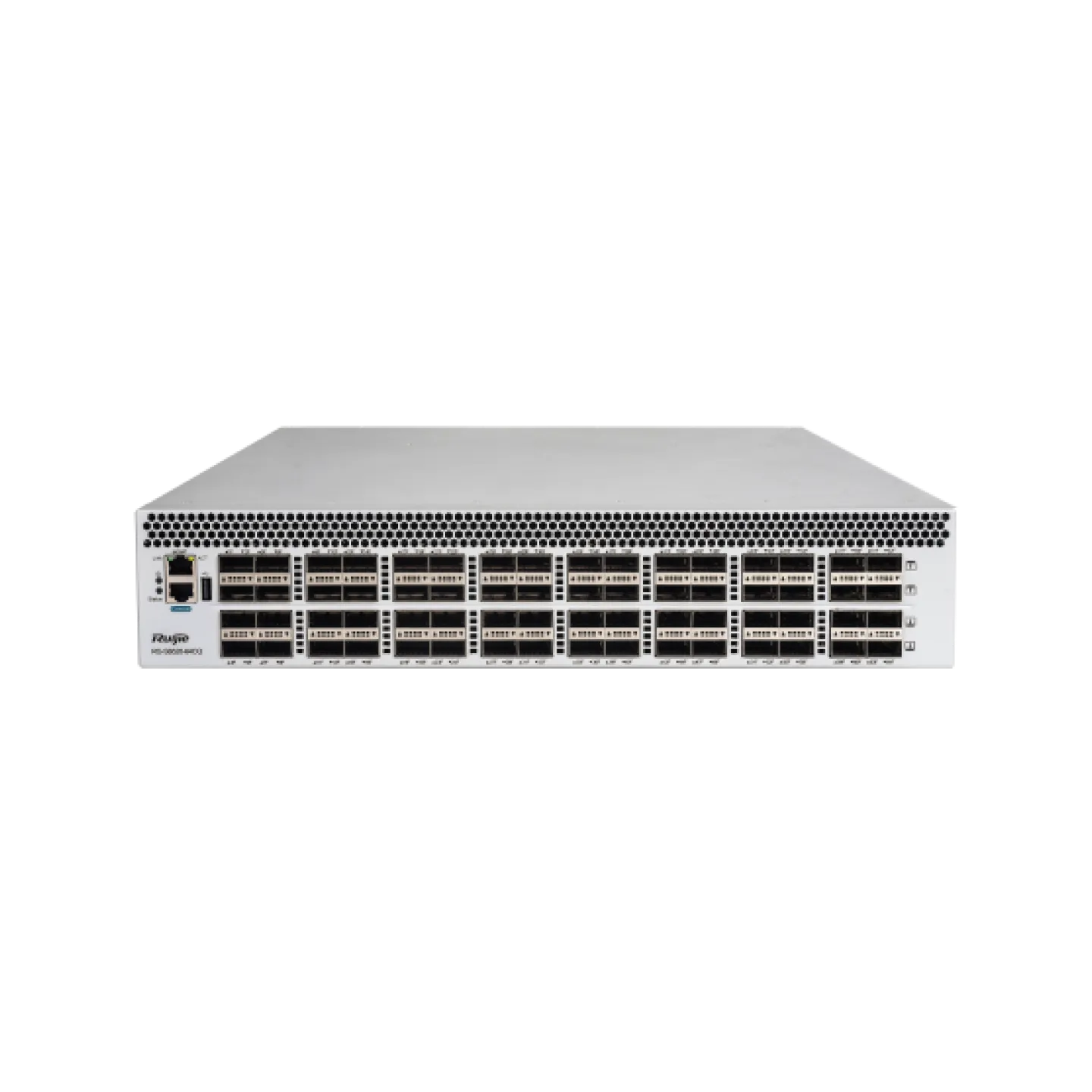

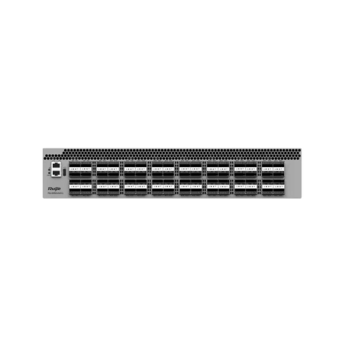

Data Center 100GE Access Switch RG-S6520-64CQ
100GE high-density access switch with 10GE/25GE/100GE downlink ports and 64 x 100GE uplink ports housed in a 2 RU enclosure for adaptation to different
scenarios, Large buffer and advanced buffer scheduling mechanism, providing fast data processing and easily coping with burst traffic

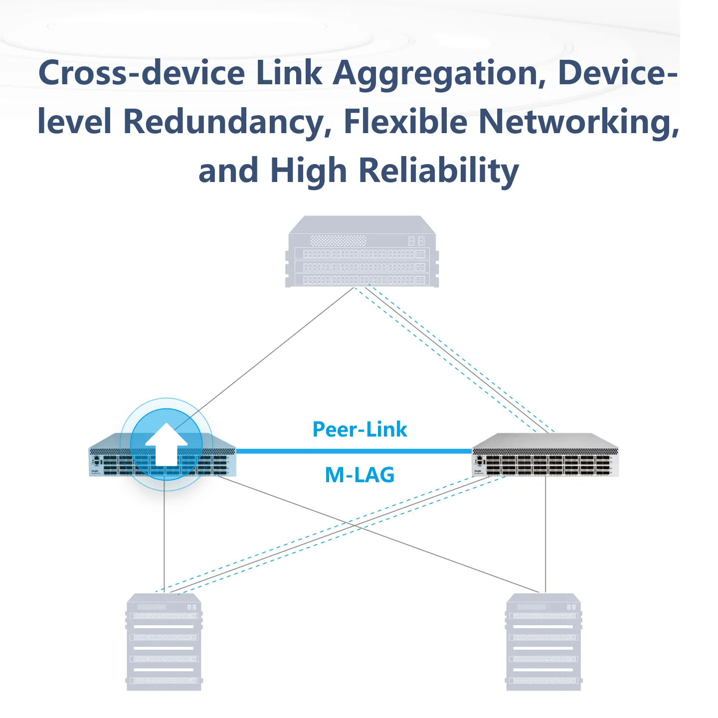

Cross-device Link Aggregation, Implementing Device-level Redundancy, Flexible Networking, and High Reliability
De-stacking
M-LAG
VSU
De-stacking technology logically aggregates multiple switches through LACP to allow servers on the same network segment or on different network segments to communicate. This eliminates the need to synchronize data between switches, without affecting service transmission.

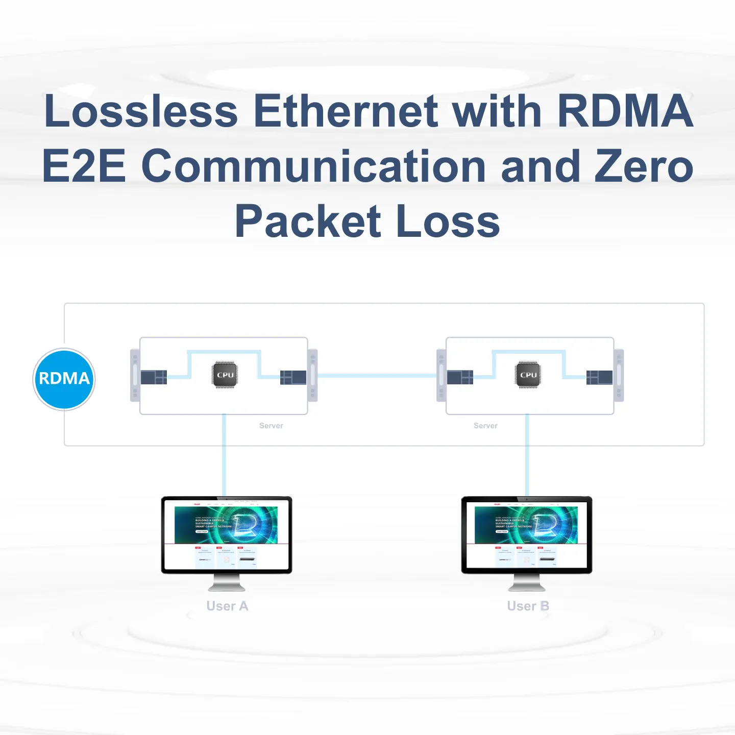

PFC- and ECN-based Lossless Ethernet with High Throughput and Low Latency in RDMA Scenarios
With RDMA technology, data does not need to be handled by the CPU during device communication. This reduces the CPU burden
and effectively solves the network latency problem.
PFC+ECN, intelligent data exchange, and packet loss prevention, ensuring lossless data transmission

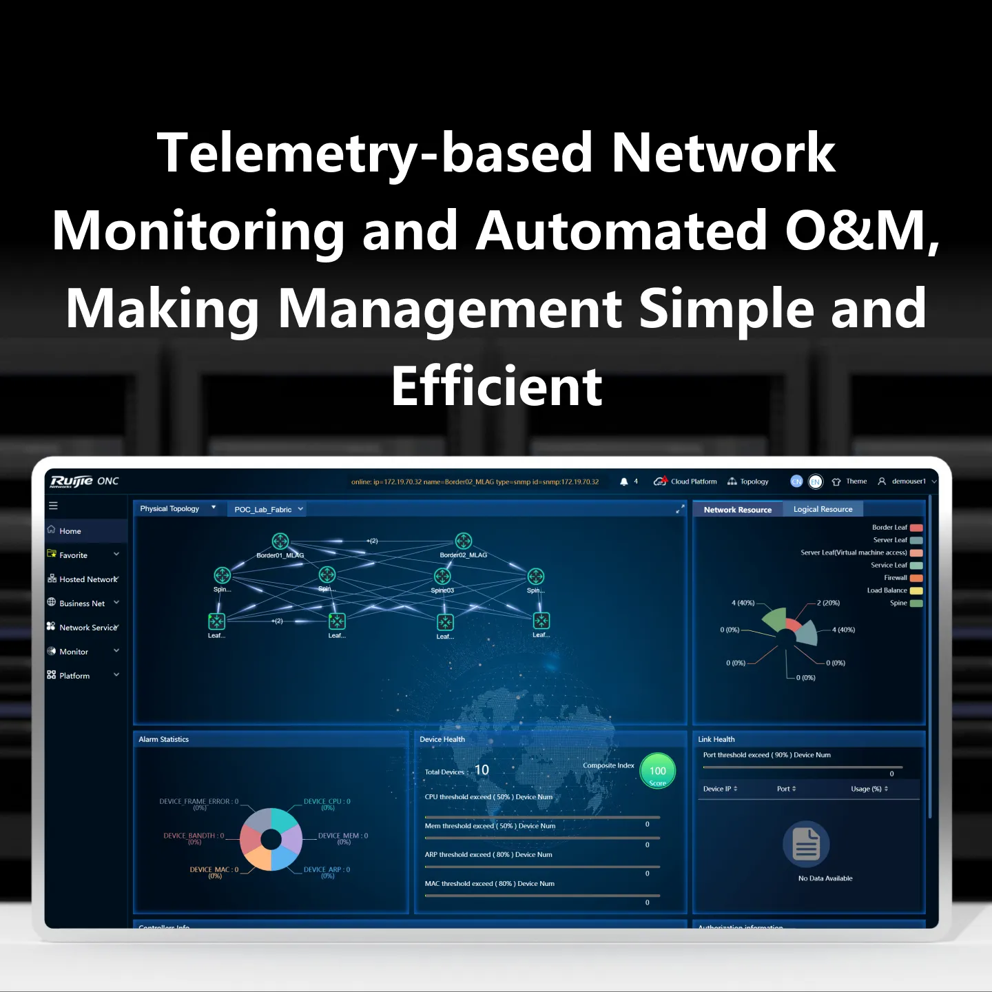

Telemetry-based Network Monitoring and Automated O&M,
Making Management Simple and Efficient
The switch enabled with telemetry provides clear data status and hierarchy.
The switch uses the push mode to proactively collect and push information and to provide sub-second-level network monitoring in real time, making network management more efficient and accurate.

64 x 40G/100G QSFP28 ports
Management port
1 x RJ45 console port
1 x RJ45 MGMT port

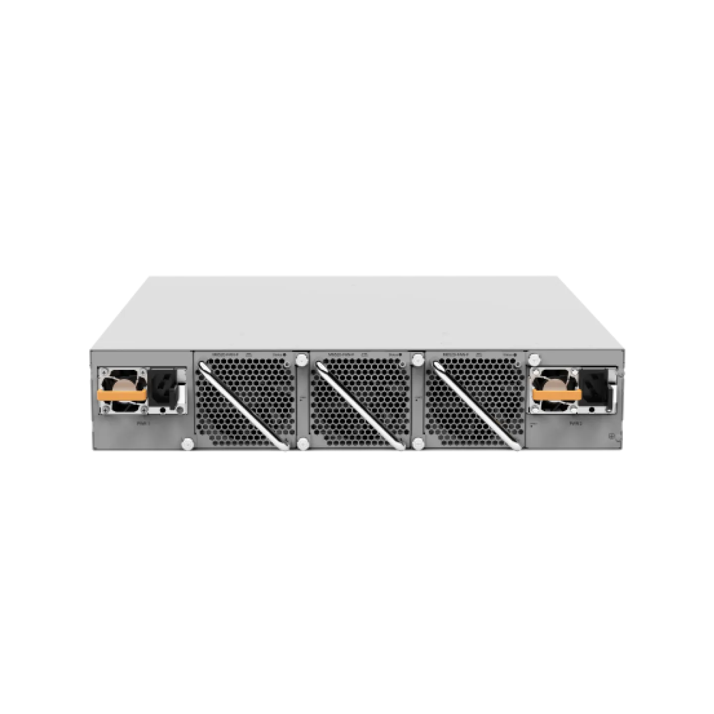

2 x power module slots
3 x fan module slots

Two power supply module slots and three fan module slots
The power supply model is RG-PA800I-F, and the fan model is M6520-FAN-F.
RG-PA800I-F
Power supply module, supporting 1+1 redundancy, hot swapping, and front-to-rear ventilation design
M6520-FAN-F
Fan module, supporting 2+1 redundancy, hot swapping, and front-to-rear ventilation design
